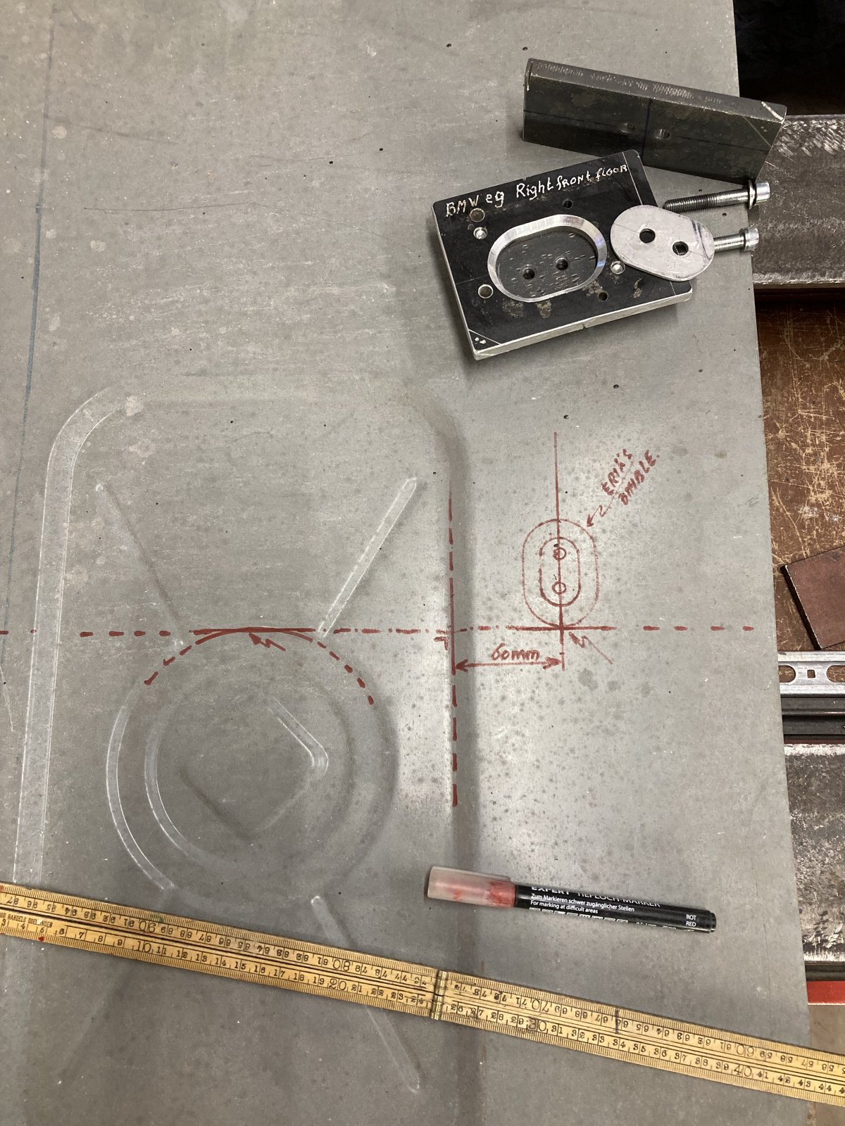

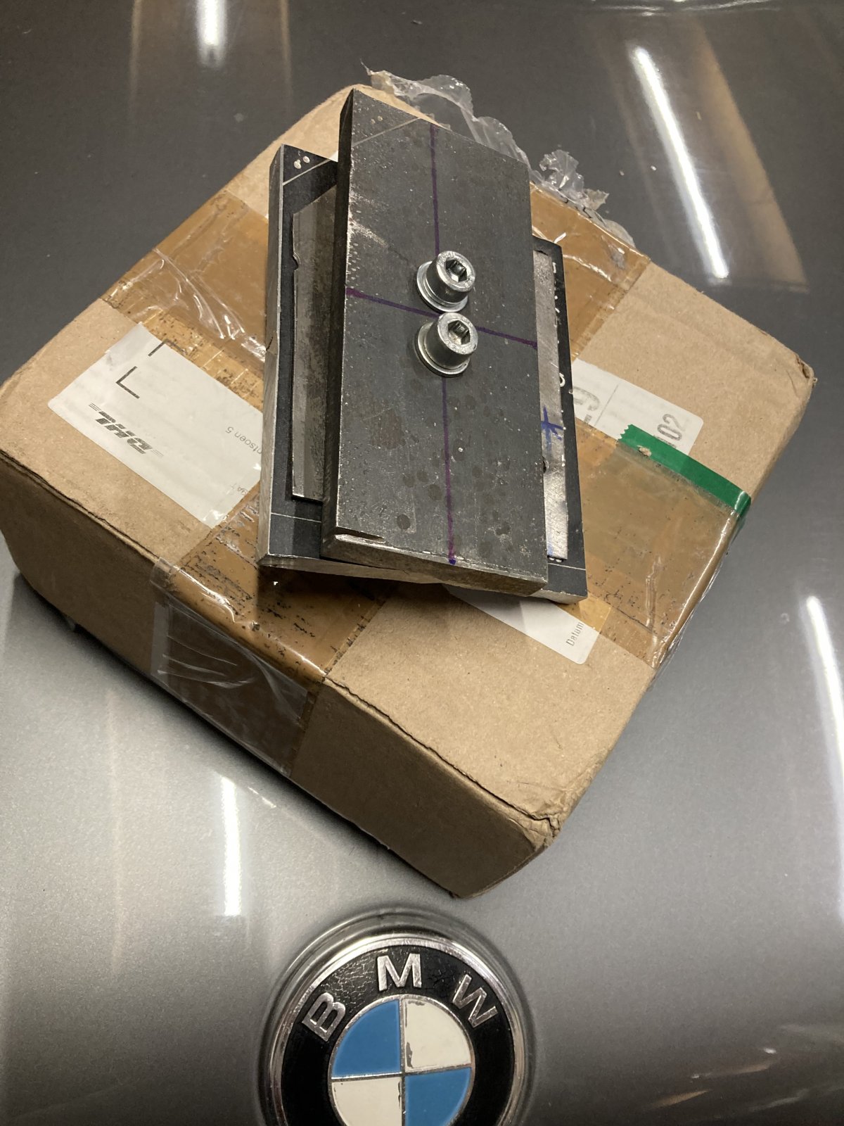

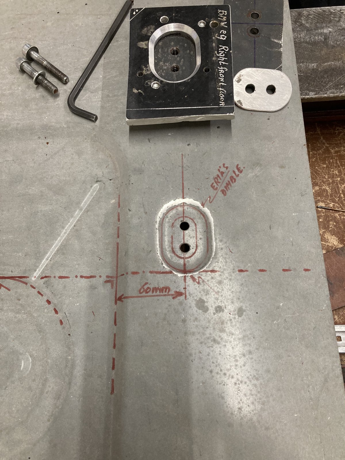

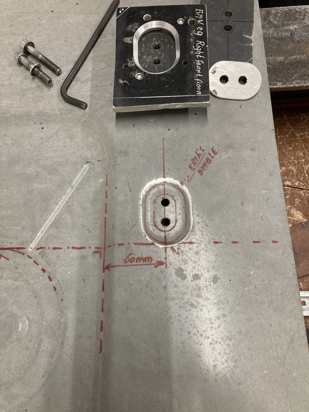

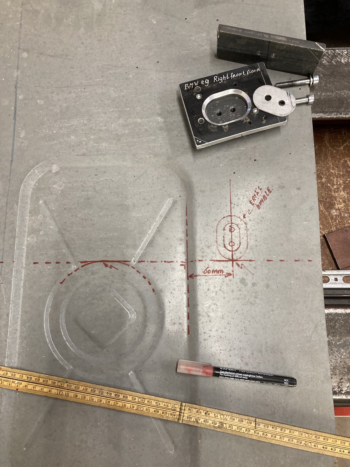

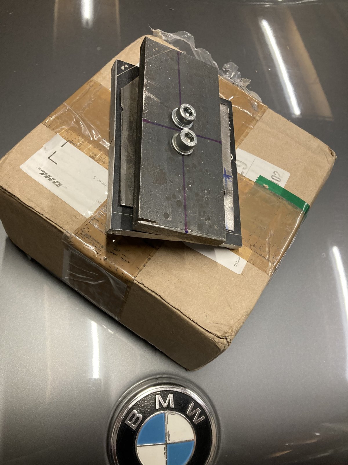

I'm posting this thread to extend an offer from our very own forum member @eriknetherlands
Erik was kind enough to send me his die for the oval plug dimples in the floor. These occur in three locations. The die worked very well. When I told Erik I was ready to send them back, he suggested I make them available to anyone else in the US first. So feel free to let him or me know that you if you need to press some ovals. As we head into the winter, I imagine a few of us will be working on the floors.
@mulberryworks are you ready yet?
I am happy to ship them to you for free with the promise that you ship them to the next user or back to Erik if nobody needs to use them.
Here is an overview of their use:
