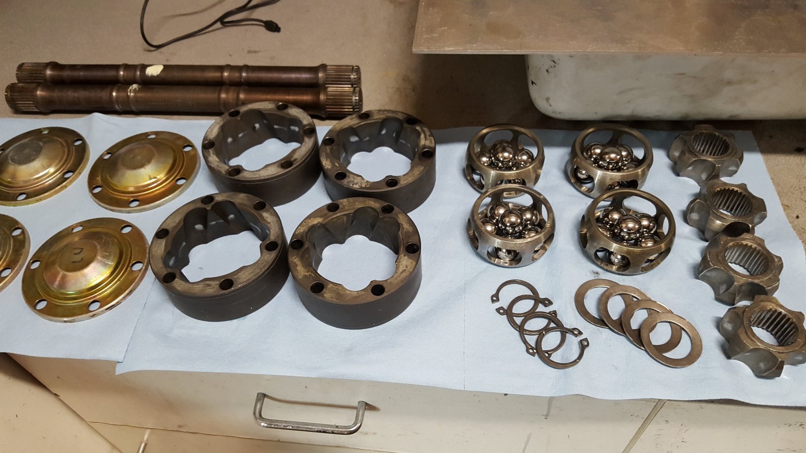

I have a pair of rebuilt half-shafts if desired. I no longer need due to EV conversion (I am having new ones with Tesla inner stub axles made).
They were in perfect working order when removed and had normal minor wear to center stars and outers, with no visible wear on balls or cages.
I disassembled, cleaned, reversed the outers to move the wear points, reassembled, re-greased, and replaced boots and plates with Rein rebuild kits.

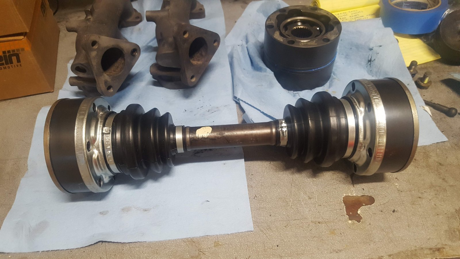

Jeff, just to confirm , is that the Rein Kits i the pics ? hows the quality - much cheaper than the W&N option !
thanks
Andy
Yes, @Andy the aussie , that is the Rein kit in the pic. Just includes boot, flange, grease, and clamps. The flanges are clear zinc instead of original gold, and they have bumps to provide strength but prevents/eliminates the need for use of the original stiffening plates. I used the new flanges because two of my originals were a bit oval from axle hitting during too much droop (or compression?). I have no way of evaluating the quality of the grease, other than to say it is greasy and I assume suitable for the task. Overall, they are good quality.
Looking at the W&N kit, the clamps and boot look identical (in fact the small clamp in the Rein kit is the same as pictured in the W&N pic, not as it appears on the FCP Euro pic). The W&N kit appears to include the thrust washer and a replacement c-clip. The Rein kit does not include those items. Fortunately, mine were fine -- and I don't like the W&N style of c-clip as well anyway. Interestingly, the W&N kit includes the opposite (outside) flange/cap than the Rein kit (and also in clear, not gold zinc). IMHO, that's useless. Nothing ever goes wrong with those outboard caps -- it is the inner flange that the boot slips over that can be damaged (like two of mine were) by excessive axle movement. For that reason alone, I'd go with the Rein kit.
