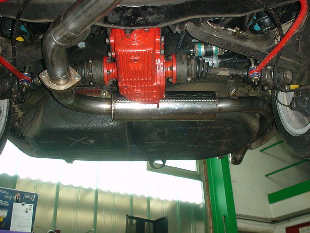

A quick word on the exhaust: I didn’t fit the original Alpina header but a Hartge unit. At the point where the Hartge H5 3.5 adds an X-pipe, we merged the 50 mm primary tubes into a single 72 mm pipe in my setup. From there it runs in one pipe just like stock. My buddy and genius mechanic Klaus and I built the whole system ourselves — I ordered the parts and held the tubes while he shaped and welded them. The tailpipe is a shortened chrome S-pipe from a Diesel Sport ESD from the 530d E39 (some of you may know these). The flanges are positioned so you can easily disassemble each section. And the sound? well.. LOUD. And did not add too much sound insulation on the inside of the car. It aligns with the fact that the radio does not work well; you would not hear it anyways...

BIG exhaust…
Well, we know, sometimes size does matter, right :)?
Not sure if you indicate it might be too big?
The B10 and B11 do have 2x55mm tubes; same size from header collector to Y pipe on my car; afterwards I calculated that I need to have an approx. 78mm diameter single tube to obtain an area of the cross-section equal to the dual pipe setup. I think 78mm was not available as not a standard size so I went 76mm.
Did I calculate wrong?
