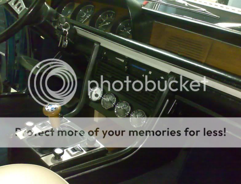

One thing I added to my 2002 years and years ago were additional gages.
I added volts and oil pressure.
I made a custom console face plate and placed them where the ash tray would have been (kept the hazard switch ).
I also added custom switches for stereo power and driving lights.
(Kinda slick if I do say so myself, but I digress)

I have considered all the mounting positions you have mentioned. Even have a second Fuel gauge that I was thinking of converting , then De Quincey made his point about elegance. I have a three hole gauge holder that could take the place of my speaker Grill, but I think that detracts from what an E9 is. The current appoach I am kicking around is to put three gauges (A/F, oil pressure, volts or water temp) under the radio on a sliding shelf that can be tucked into the cavity. the A/F gauge I have from another car is not something I want to look at all the time as it is digital.

+1. I have a/c so I put mine in the speaker grill but kept it all reversible. I went with oil pressure, volts, and A/FR. The under dash kits come up on ebay Germany sometimes. Also try Parker performance:

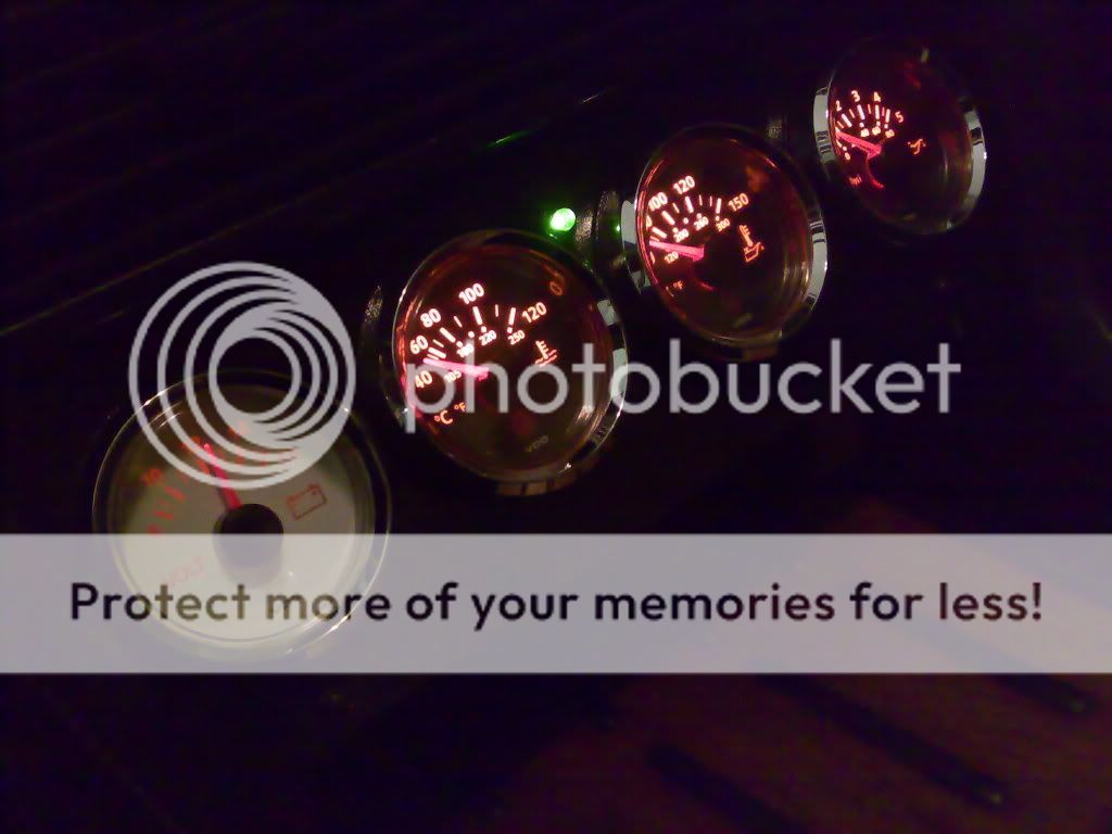

I have an analog AFR gauge that I repainted and re-bezeled to blend with the VDO ones:

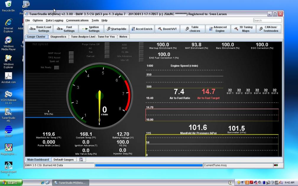

Some options with the megasquirt efi (MS). It currently supports a dash on the Droid phone. Hopefully they will eventually port over to the ipad. And finally, less practical, is the laptop on the passenger seat (see display photo).
MS does support CAN communications. I am using it for the 6 EGT sensors, as there were not enough ports on the MS ecu. The MS harness is mostly independent of the base CS chassis harness. They interface at a two points (power with key on and signal back to tach).
http://tunerstudio.com/index.php/shadowdashmsmenu
