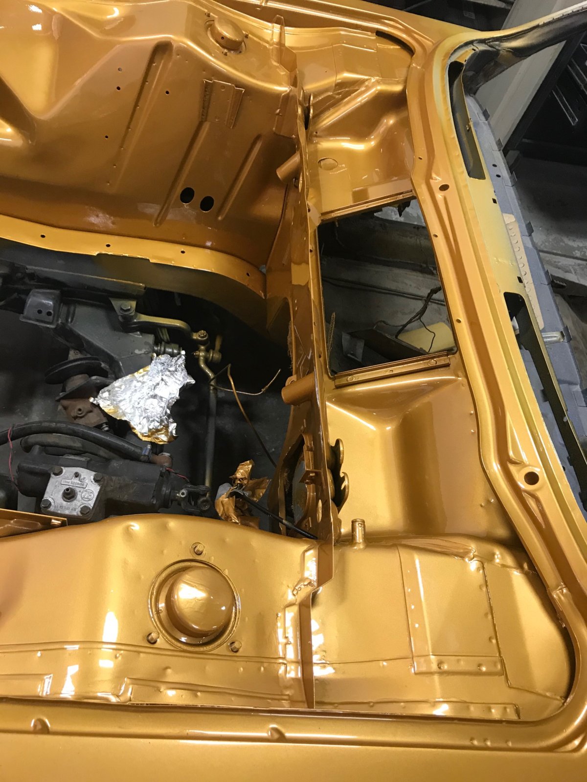

Jake, is your windshield in the car? i am not going to say that the dash cap can't be put in with the windshield installed ... but it is damn near impossible. i am assuming that you mean the foam within the cap. the bottom of the cap - where the ends of the clips go in, there is metal at the bottom of the cap. so the clips are hanging below the cap and then insert into the metal dash framing - if you look at the pic below - you will see the two rectangular holes in the middle of the upper part of the dash (pale gold) and you will see the passenger side one right before where the A pillar goes up. there is also one on the drivers side. this is where you have to get the 4 clips to go in. this is why it is a lot easier to put the cap in with the windshield out of the car. otherwise its hard to get it to go down and in.
it sounds like you are mounting the clips in the top of the metal dash and trying to get the dash cap to go onto the clips ... if so, that is just backwards.
