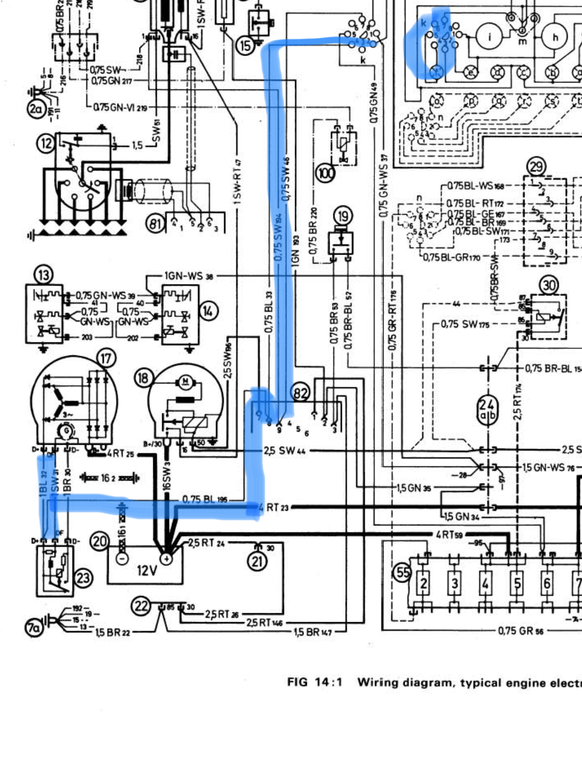

#1 relay is horn relay
easy to figure, it has two green/yellow wires, brown/yellow, green/white and red
#2 relay is high beam
easy to figure, it has two white/violet wires, brown, white and red
Fuse 4
red/white
boot light
interior light
hazard switch
If your alt light is staying lit- that means the blue wire has found a ground somewhere. One side of the bulb is battery positive and other side is ground - you have a circuit and bulb lights up.
