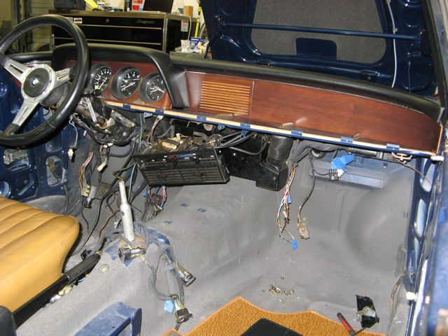

Attached image with Bela wood. This was a big day as I was very concerned about getting all these pieces to fit together.

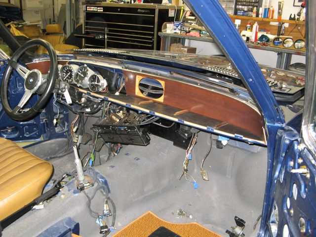

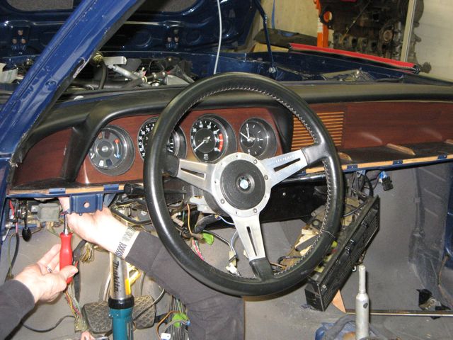

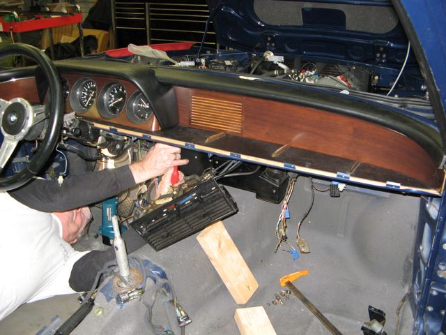

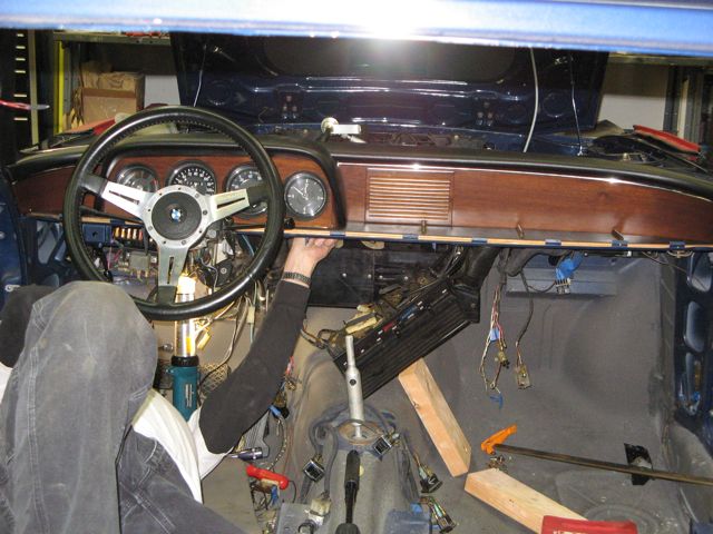

Luis, here are more images of the install. I'll take some more closeup shots in a day or two but these show some of the process. The first strep is to assemble the vertical and horizontal wood parts along with the bright trim piece at the top of the vertical. The next shot shows the upper dash and binnacle cover initial installation. You can see the gap between the binnacle cover right side and the horizontal wood section. The next two images show the screws being tightened to pull the binnacle down snug. This was where the clearance problem was most evident. The newly recovered binnacle was a little "plump" with the result being that it didn't want to be snugged down easily. There is still a small gap but I'm going to give it a few days to compress and then try to pull it down a little more.

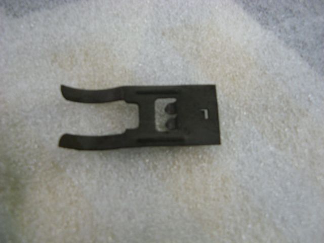

The last image shows the little clip that secures the outer end of the plastic defroster vent to the upper dash on the underside. This needs to be done after everything else is in place and requires some serious patience.
