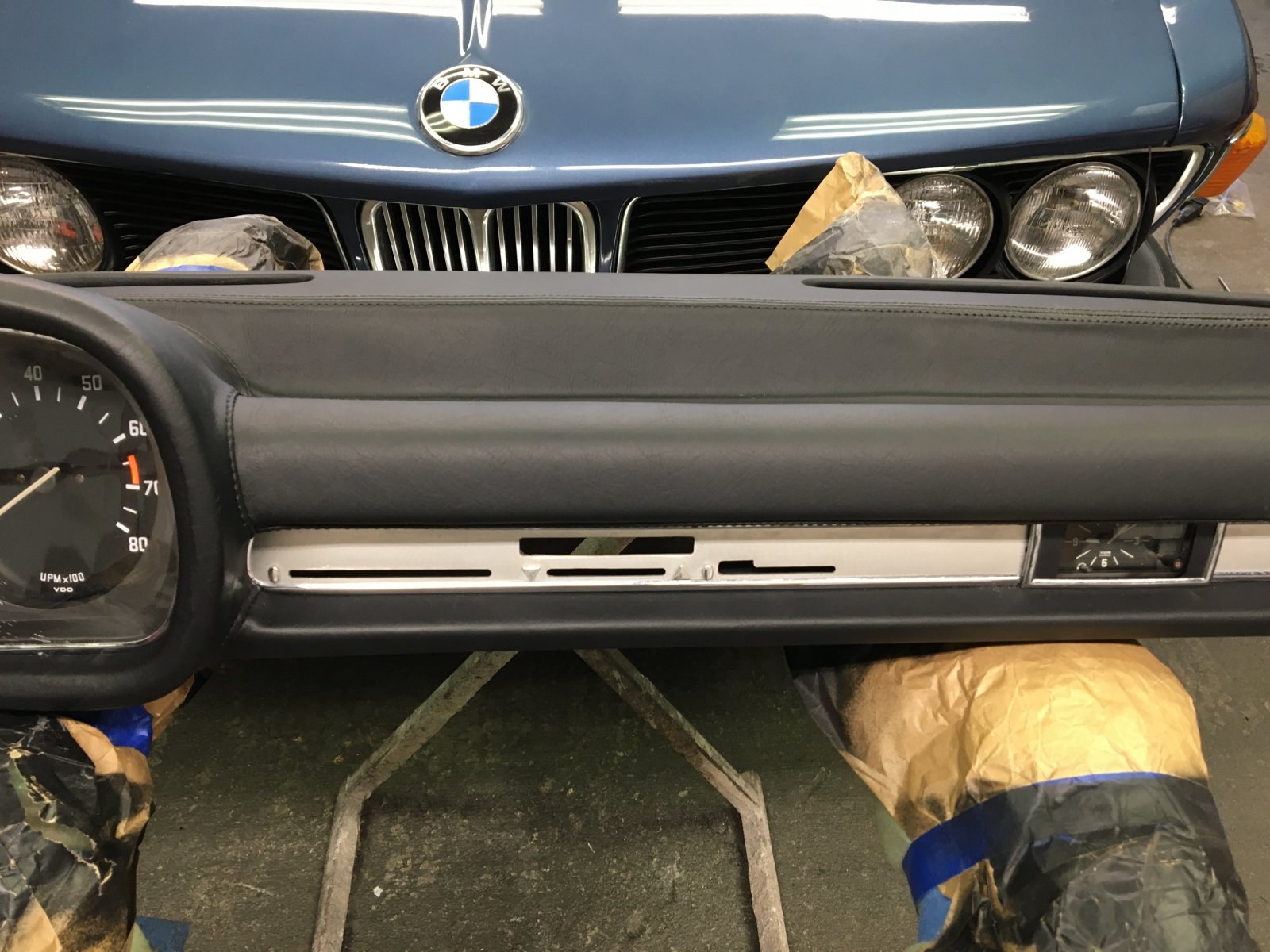

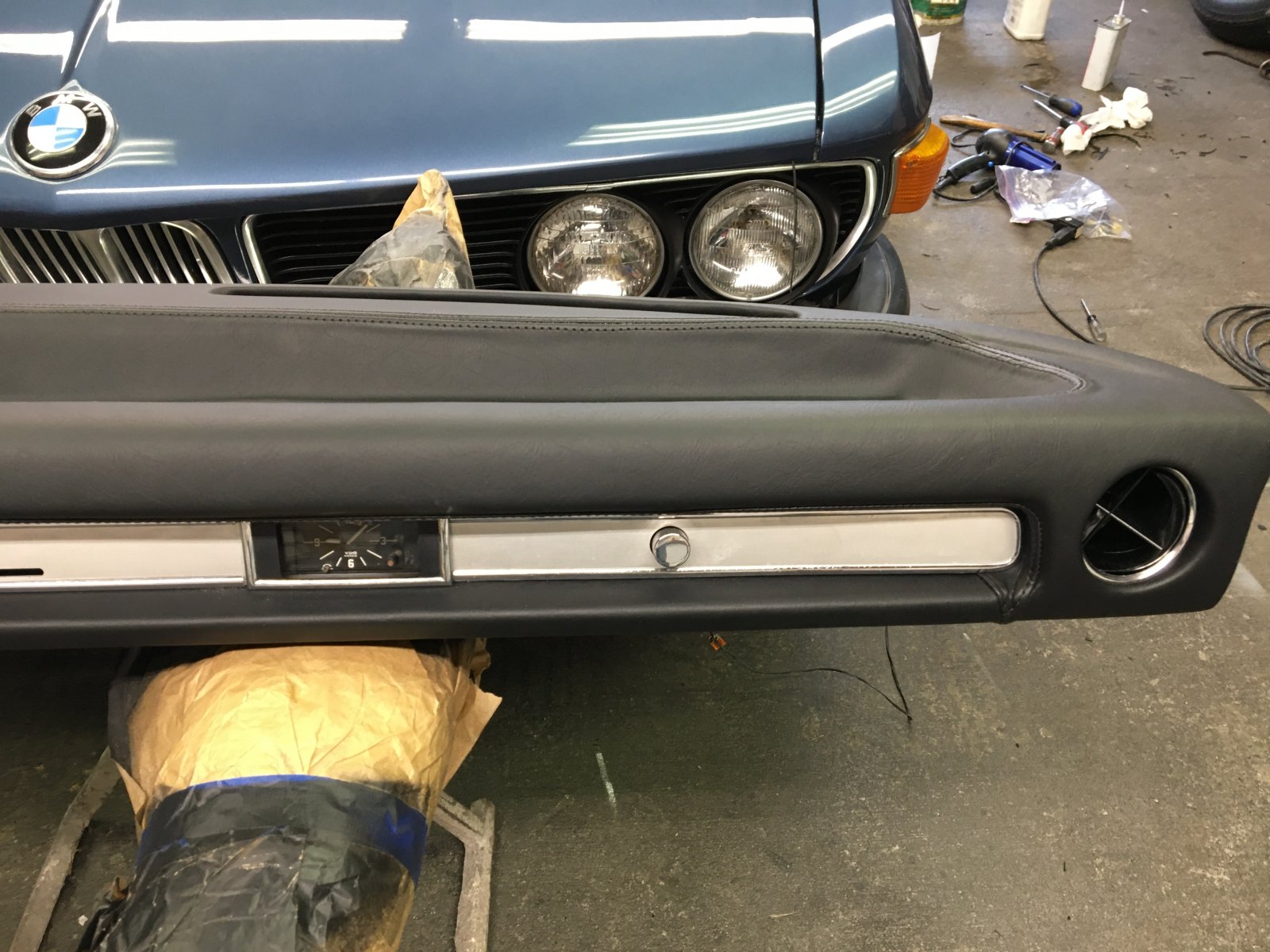

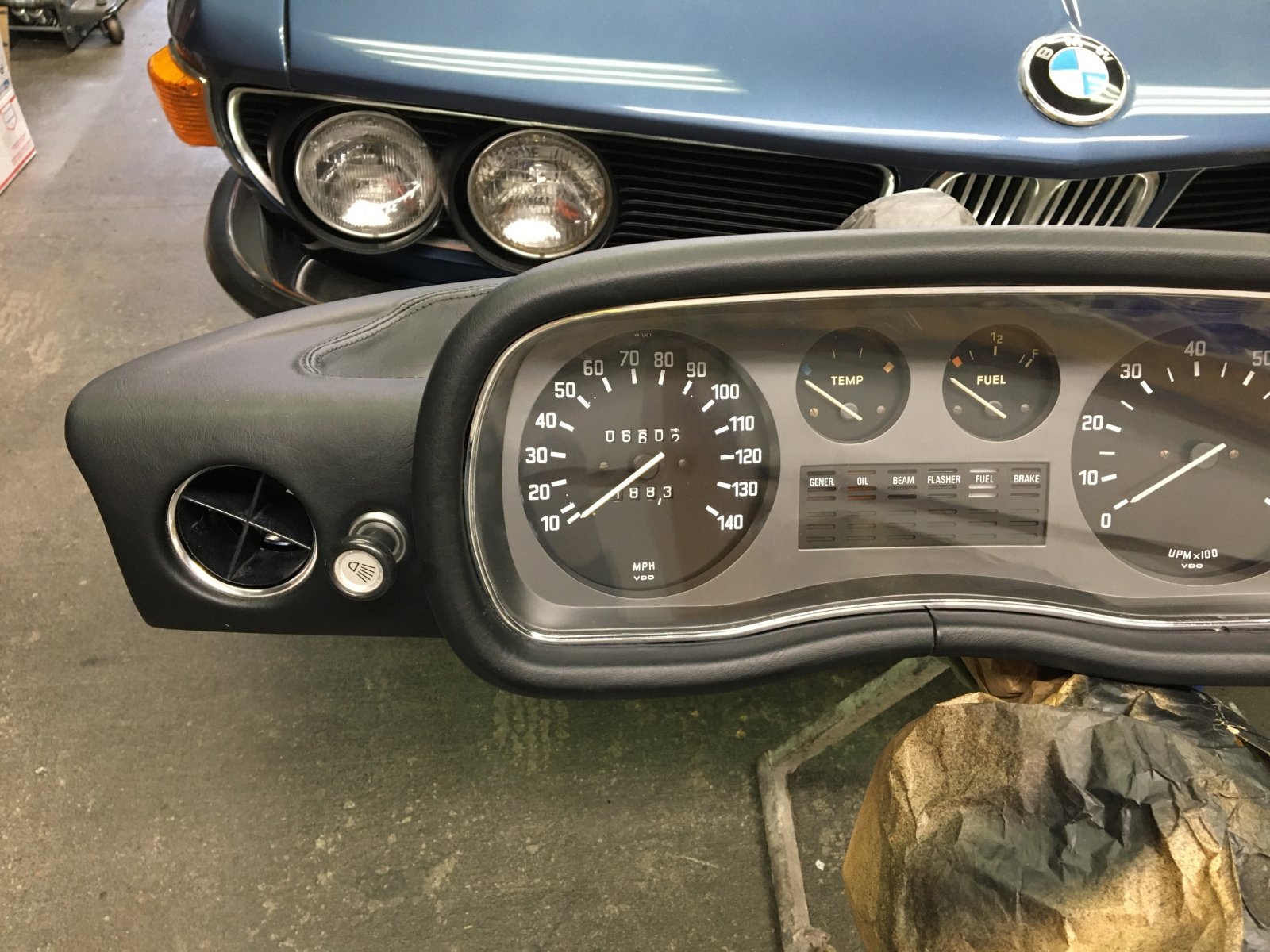

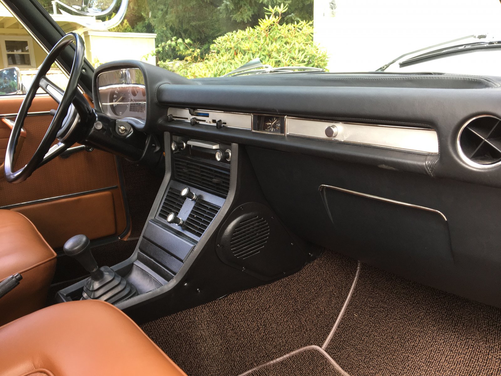

My dash was far worse than yours. I looked long and hard for a good replacement. When I did stumble across one, I would have to mortgage the house to buy it. I have not seen any other acceptable ones for sale in the last 3 years. I contacted Coupe King (Peter) as a possible source for a good dash. His suggestion was to have his upholstery guy cover one. I figured it was worth a try at this point especially considering the price difference with the good one I had found. I think it turned out great. Not totally stock looking of course, with the exposed stitching and the elimination of the dividers in the center valley.

Yes!! That looks awesome. I’d go that route for sure, if I thought I could do it myself… I’ll most likely do the easier route first and see how it goes. I like to make sure I try to do every piece of my restos..I’m a bit OCD, I guess..
