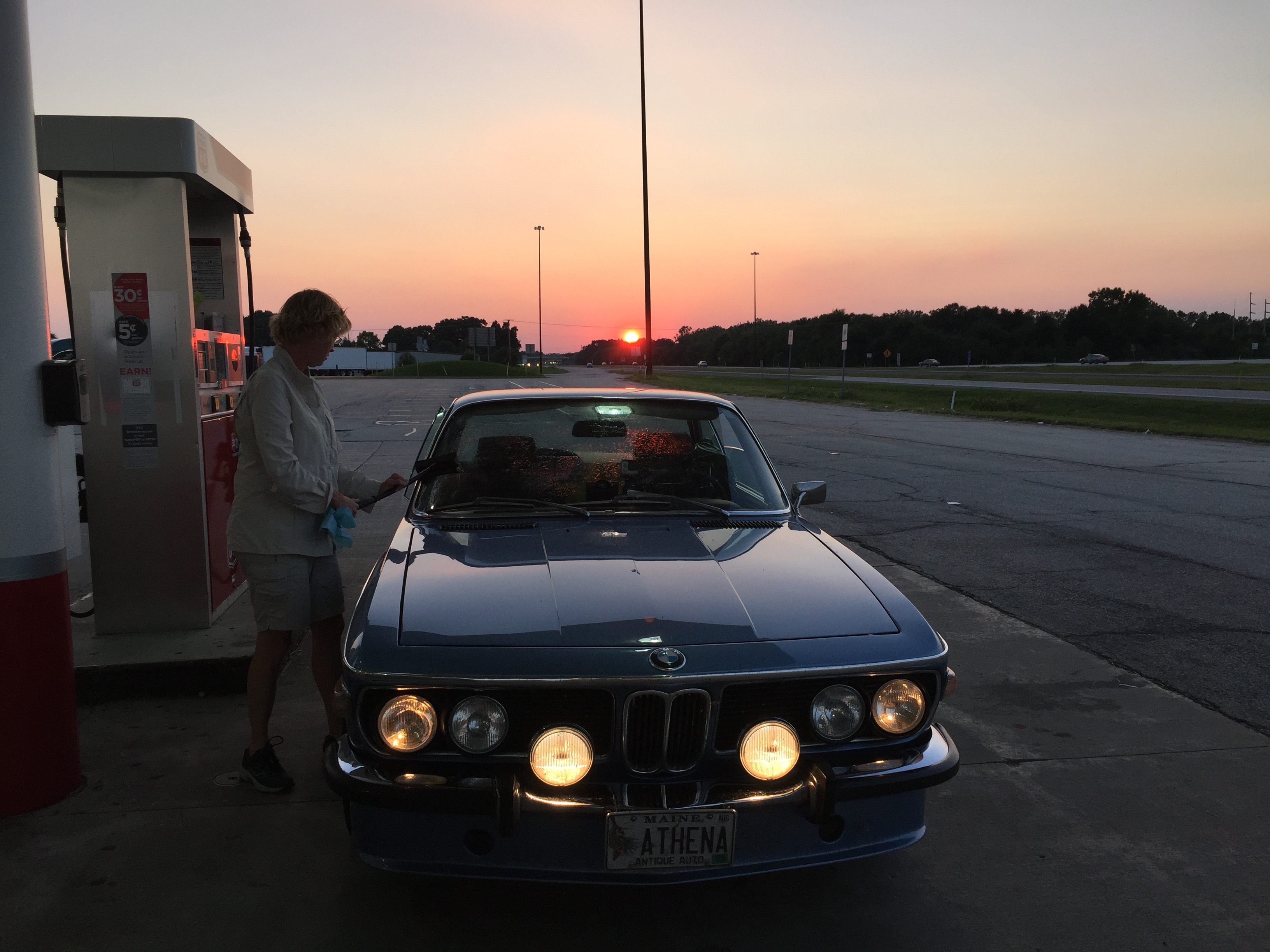

I'm using 'City Lights' in Cibie Hi/Lo beams as daytime running lights. These are small wattage bulbs that are inside the headlights. They've been wired to come on with the parking lights. Not sure if this is legal everywhere. I don't use a buzzer, but I can't help but look at the car when I walk away from it and catch when I leave them on.
my thought was city lights as well. i don't have them but thought they could be the best solution ... glad to know it can work that way
I run my City Lights as day time running lights, though they are more visible at dusk. Also use my fogs as daytime running lights sometimes.
