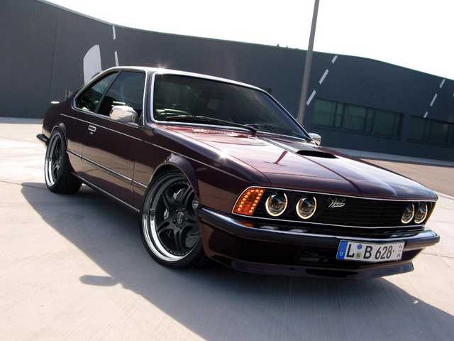

E24 example:
Honestly I think it looks pretty cool also. The aftermarket ones went gangbusters a little over 10 years ago to the point the people where got turned off by them showing up on every manner of vehicle. Played out to the point that internet memes were flying :) The dust has probably settled since then.

E24 example:
Mine are 6000k color temp. Those look like they are around 3500k. I should have probably looked for those - they look more incandescent and warm.
