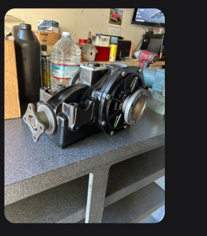

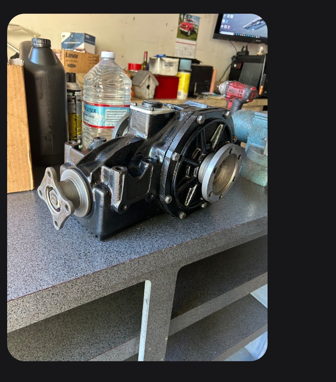

Literally JUST got back from picking my CSL diff up from Pete not 20 mins ago.
