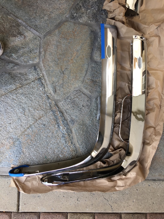

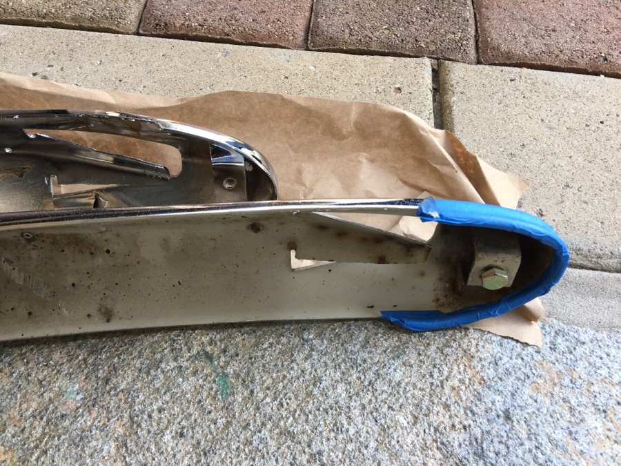

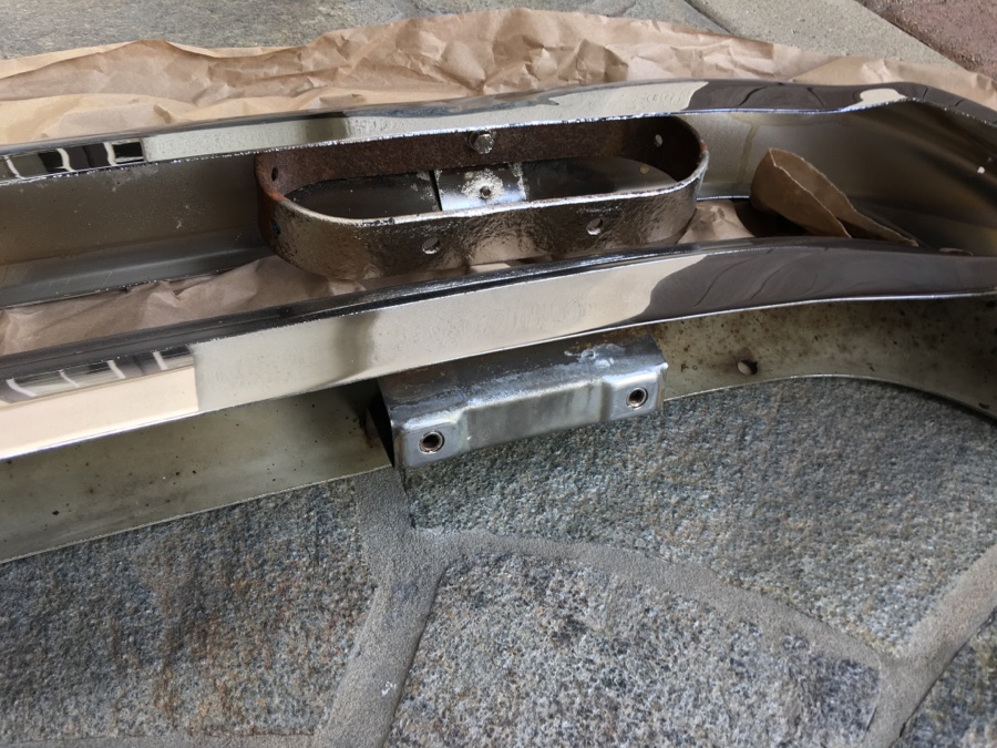

I found a few threads on the subject but no definitive answers. I had a chance this weekend to compare the two side-by-side and take some pictures.
It looks like the shape of the bumper itself is the same. But there are two major differences in the brackets. First, the 73 not only uses the well-known hoop bracket but also gets rid of the 72 bracket in the process. Second the side bolts bracket sticks out further on the 73. This makes the 73 only usable with the hoop. It would take a lot of fabrication to rebuild its brackets to 72 shape and look.

I'm guessing that the only "easy"way to make 73 work on 72 would be to very carefully cut about a third of the hoop, and weld in a flat/straight piece of stock to copy the offset distance of the 72, then (again, carefully) measured holes to match holes, with pre-welded nuts on the inside to accept OEM-style fasteners. holes could be slightly over-sized, but nuts would need to be pretty exact)...does that make sense?

I am now wondering if this change in Bumper brackets was an internal BMW theme. On the 2002s (e10 or 114 as some call them), the early cars up to 73 use a rear bumper bracket that is pretty easy to install--2 bolts to the body and one bolt to the bumper, on ONLY the 1973 2002s they used a similar OVAL shaped rear bumper bracket almost identical to the oval bumper bracket in the 73 Bumper picture above....makes me wonder....did they have a change of design or designer in 72 to implement the 73 changes in the e9s and e10 rear bumper brackets?
