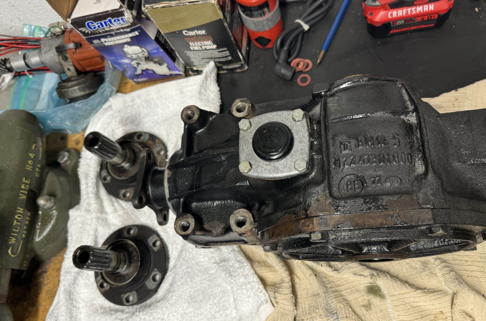

I am going to put the original 3.64 back into my car, I like the 3.45 but it’s just too long for my city driving, plus I have 5th gear for the rare highway drive which I have yet to get to from 4th in 1000 miles.
It has 95k miles on it. I am going to do the seals and ginormous o-ring, should I go ahead and do the input and half shaft bearings? Or just the input if it takes most of the abuse? I have the wizardry of @jjs2800cs to help with the crush seal tension if necessary.

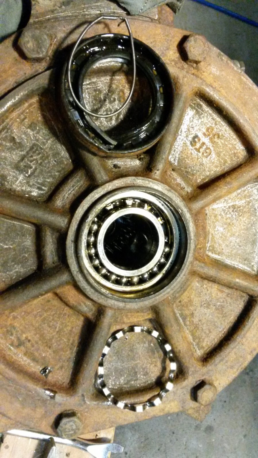

One side bearing had a bit of a hesitation when turning by hand, something little, it just did not feel consistant while turning.
Turned out the cage holding the ball in equidistant spacing had seperated; there are 2 halves that are (supposed) to be spotwelded together. these spotwelds failed. thus the 2 rings simply were 'floating' around the balls. Notice also the 2 metal flakes just left of the removed cage, probably they were part of the cage before it disintegrated.
The ball bearing left and right are easy to replace. There are very small!
I would replace those two.
The bearing on the front is more critical due to the tension that must be applied. Leave that one if it is good (no noise)
