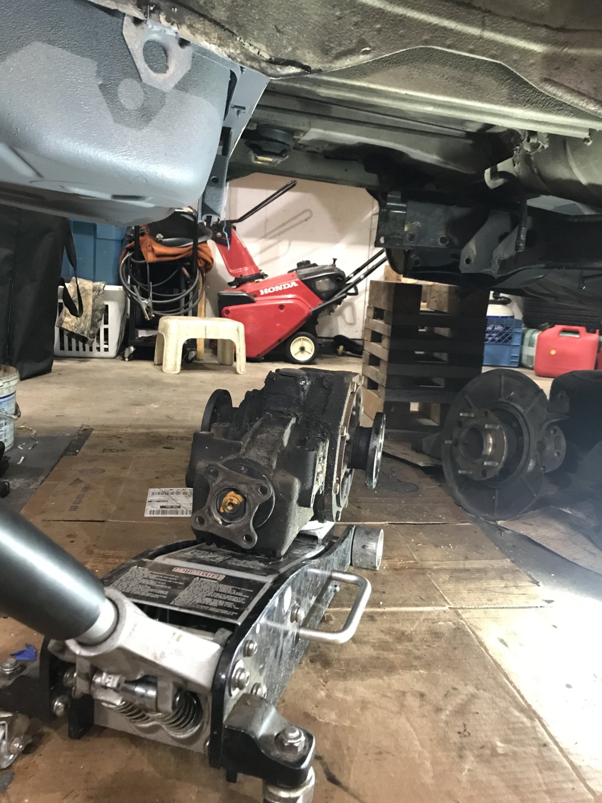

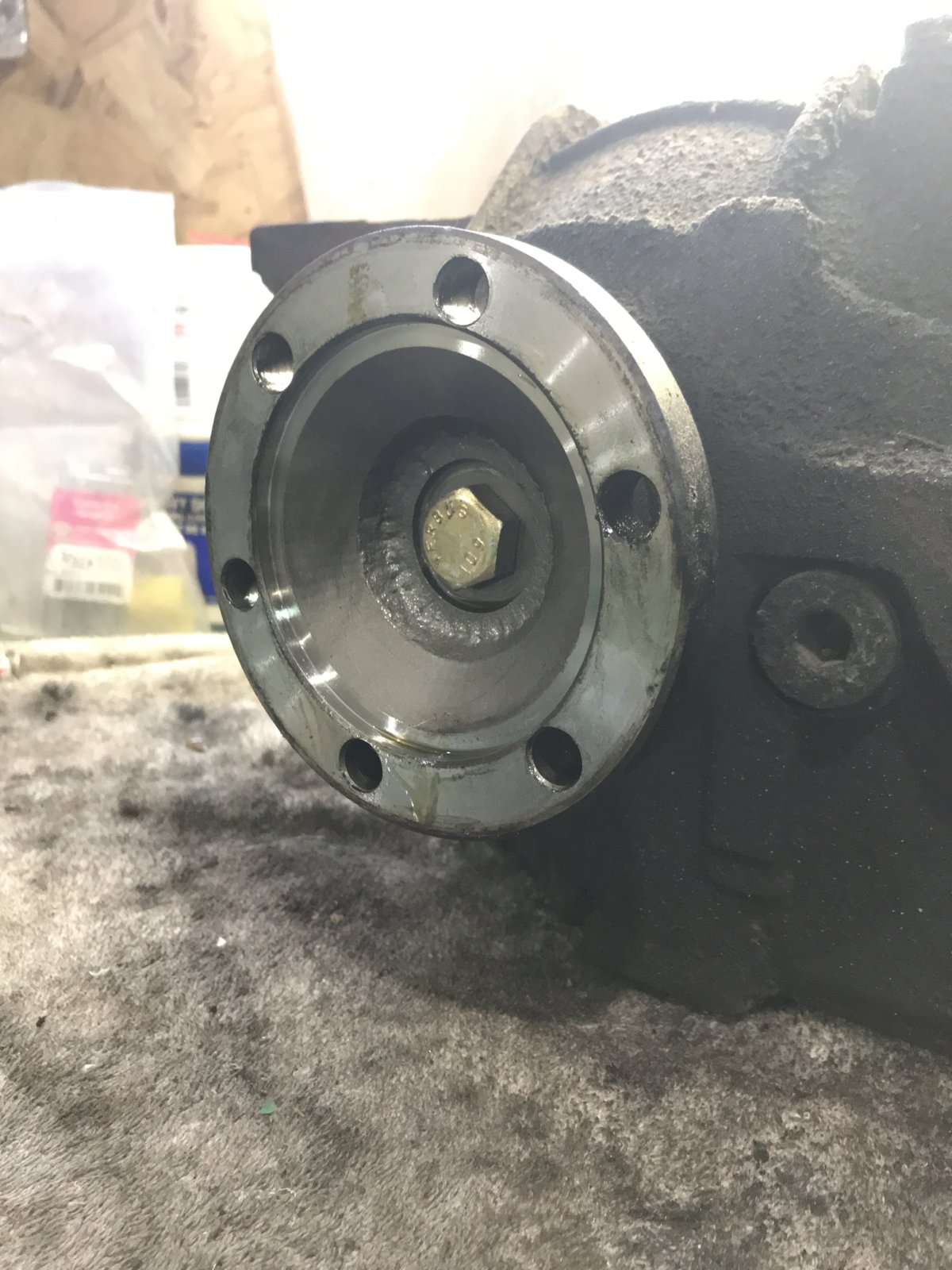

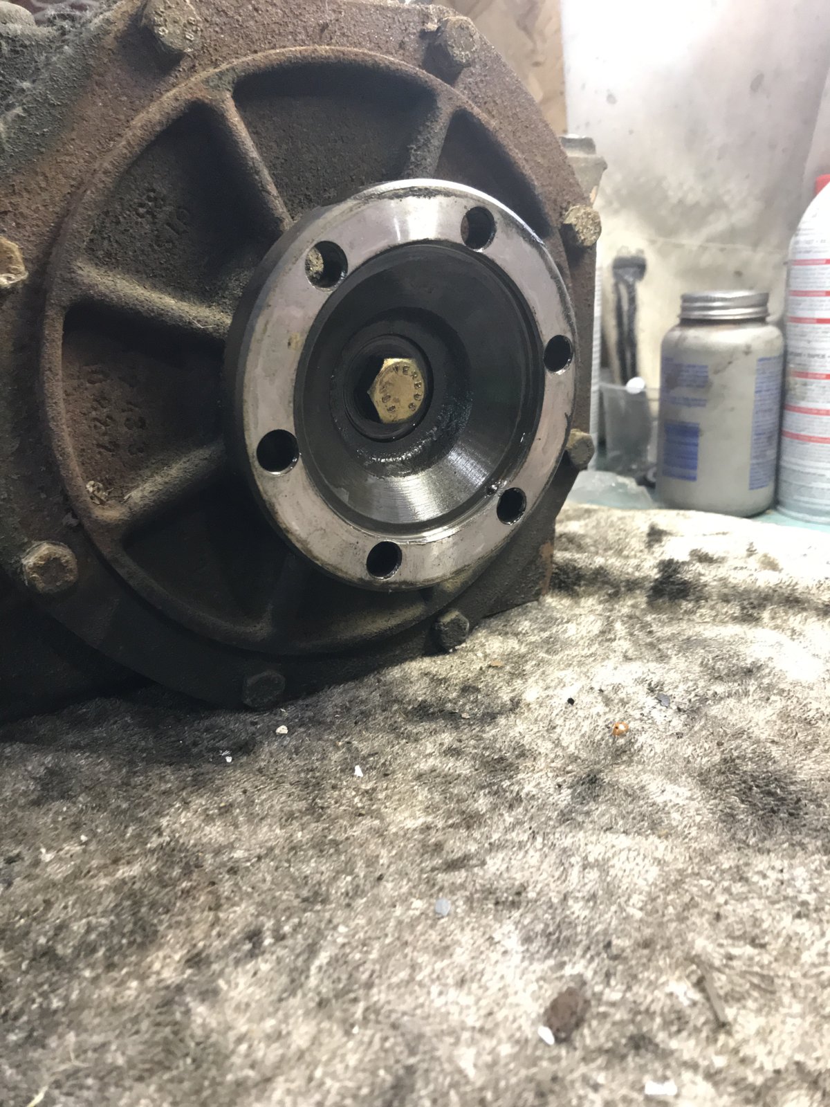

I am working on refurbishing the rear subframe, suspension and drive parts. The differential has no apparent leaks however the interior of each drive axle flange and the mating faces of the CV joints were a bit 'oily'. The oil had that acrid gear oil smell.
Is this common?
Is it common to use thread sealant on the drive flange retaining bolts?
THX
Bill
I'm no expert but I think the grease used in the CV joint separates causing oil to seap out of everywhere. And of course they spin too, flinging things about.
Looks too thin to be from the CV boot. It is not a big deal to replace all you diff seals, it's out, it's cheap. I would also rebuild each axle,just because they look original.
I would replace the seals on the half shafts since you have it apart. There is also a skinny rubber seal for the side loader side as well. And use Loctite.

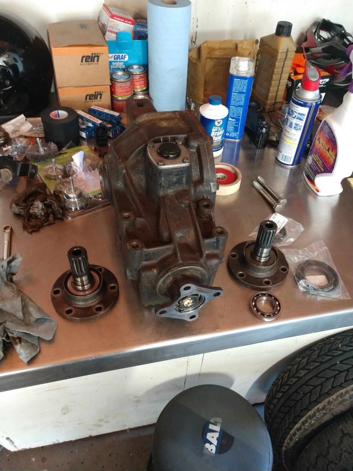

Hi Bill, what was your source for the seal kit? Your differential makes mine look fresh, so I am planning on seals and refreshing the half-shafts at the same time.
Lance

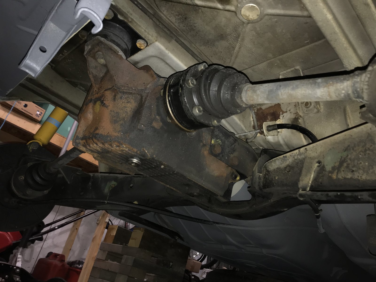

Hi Lance
Mine after cleaning and painting looks much different than those initial pictures. Certainly wouldn't leave it in such condition :). Regarding seals, I will check my email and receipts... I only order from a few places so shouldn't be to much digging.

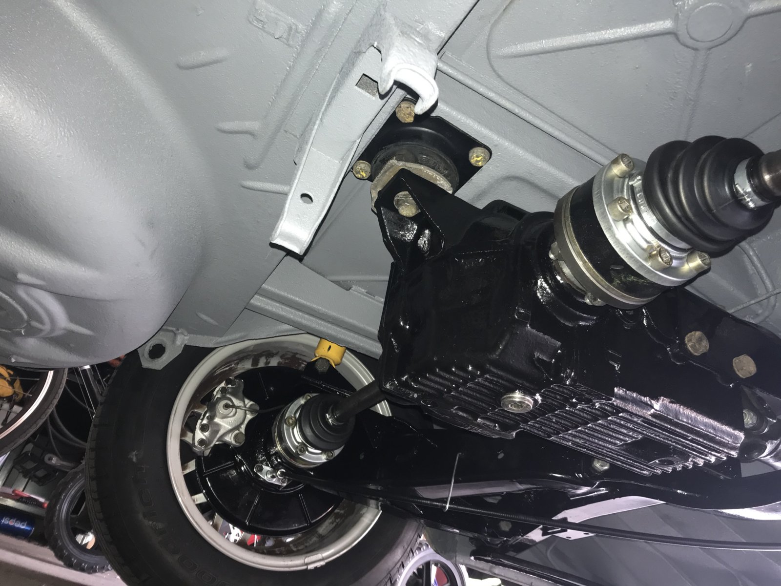

this is how under the E9 supposed to be, it is one of a kind I think I will try to make mine look like this.
Hopefully no cracks at the diff mount...look close while you are there.
Will be no crack or rust I take care of all when I was restoring But I did not care much about under the car to be nice and clean like this one I was new and didn't know much but now I have two E9 and one E31 and lots of free time I will get dirty and redo it to see if I can make it look like this one but I will try for sure.
