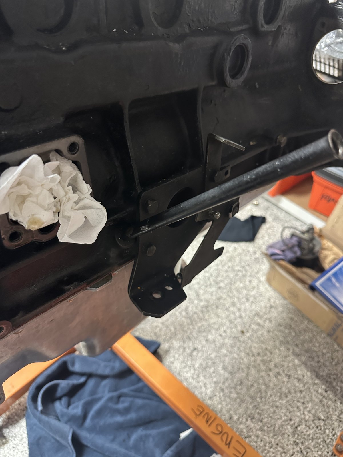

I see the dipstick tube is pressed in to the block, is there a way to get this out without destroying it? Twist it while pulling out or? I tried a mild twist but it only seemed to want to stay in place.

@Stevehose , I am curious to know how your dipstick guide tube installation went. I got my tube from @sfdon and thought that it would go right in if I used a little "science."
I stuck the new tube in the freezer for several hours and used a propane torch to heat the hole in the block where the tube seats. I used my old tube, which is tapered at the bottom, as a driver to fit inside the lip of the new tube but the last few millimeters are fighting me.
I will apply more heat tomorrow to see if I can get the last few millimeters to seat.
