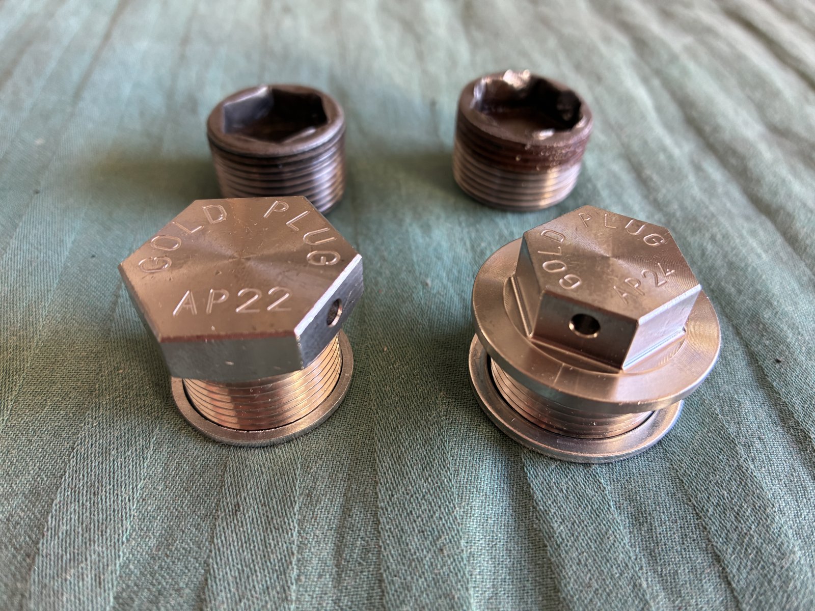

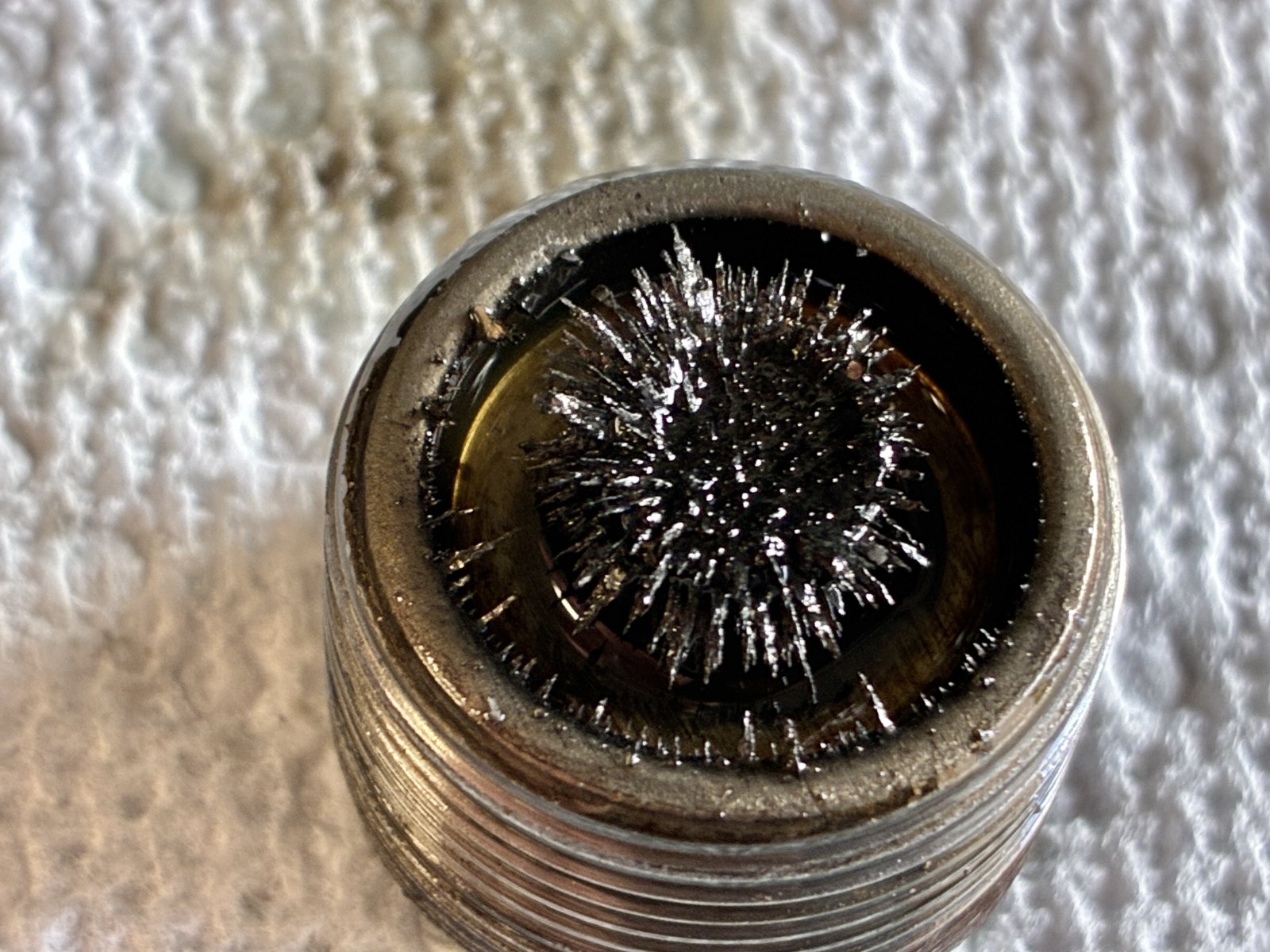

I discovered that the oil drain plugs on the engine, gearbox, and differential are different sizes that range from M20x1.5 up to M24x1.5. I don't know why the BMW engineers did this, but it certainly helps to know they did. I replace hex tool plugs with hex head plugs anytime I can. My gearbox drain plug had rounded edges. When I finally was able to get it off, the magnet was covered in metal filings. I'll bet this oil hadn't been changed in many years and yes, it was dirty.

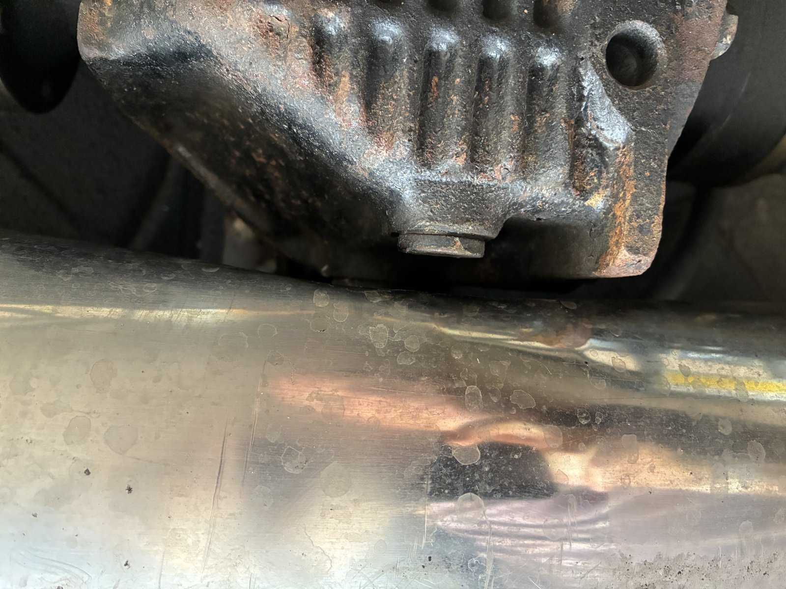

With the differential, I was at first perplexed on how to access the fill plug as it was sandwiched next to the muffler. So, I removed the muffler securing hardware. It only moved a bit but not enough to use the hex tool. My SS exhaust is all welded from the manifold to the muffler. Clean, but not friendly if I need to remove it. At first, I tried to move the muffler up to gain access the to the diffy fill plug, but that didn't work. With some trepidation, I pushed down on the muffler and was able to move it enough to access the fill plug without hearing any awful cracking sounds from the exhaust bending at the header connection flange. Well, at least I won't be doing this very often.

I have never needed to move or remove the muffler to access the fill plug on the diff. Hex socket on a breaker bar or 1/2” ratchet.
Hi Chris! I looked at numerous photos of other E9s expecting to see a different muffler layout. All that I saw were similar. Now, I have a 5 speed and perhaps a different diffy that may locate the fill plug to where it's not blocked as mine is. Either way, I'm happy that all I need to do is remove a few bolts and pull the muffler down to access the plug.
We use a 1/2" ratcheting torque wrench...
The fill plug is in front of the diff output flange....

When in a similar situation...but not on my E9, I bought a cheap hex wrench ( avoiding using the term Allen so as not to trigger bad memories for you) then cut off a short segment that will fit in that little space and then fit it into a wrench and use that to loosen the plug. Loosen and spray with BP blaster or equivalent, then tighten a bit to get the internal threads coated, then remove the hex and wrench and finish removal by hand. I realize as you use this technique, the plug drops and then you get stuck and cannot remove the entire setup, thus the PB blaster and slight re-tighten and then remove by hand.
