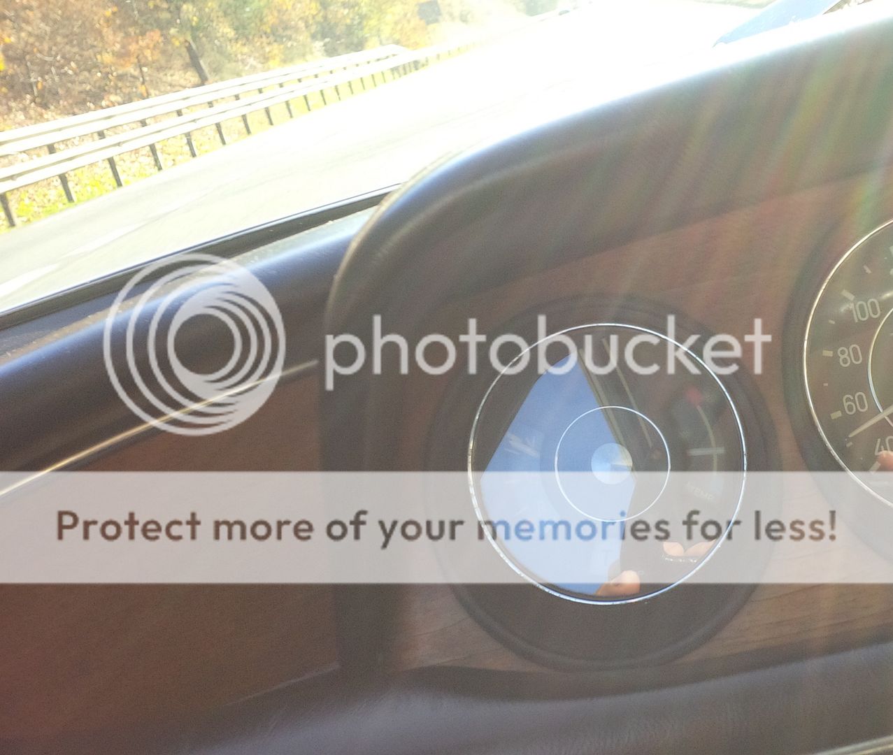

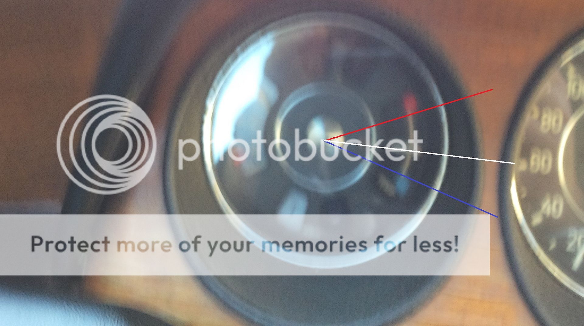

70% of the time my temp. reading is this:
today, sunny, 14 ºC outside temp, warm engine after 30 min drive, flat road, 3rd gear and around 3000 rpms, gauge shows water temp between three and four (apologies for this blurred pic)

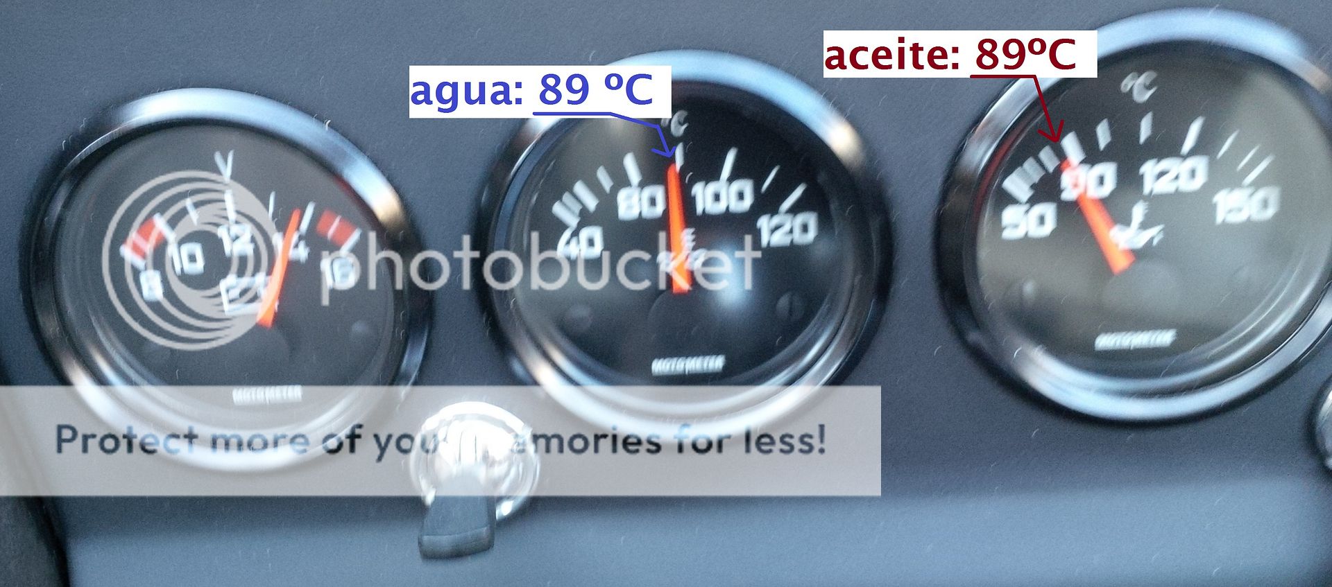

external gauges will read with more precission: 89ºC for water and same for oil temps
variations to this that i have experienced are:
uphill for more than 5 minutes, 3rd gear, 5600 rpms = Water temp 95ºC
downhill for more than 5 minutes, 4th gear, 4000 rpms = wáter temp 82ºC
highway, 4th gear 6000 rpms = wáter 85ºC but oil temp 95ºC
city trafic wáter temp 90ºC

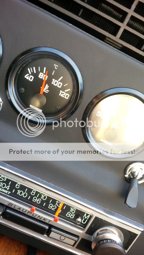

pictures to show what happens when downhill for more than 5 minutes:
and the whole picture:
batt is correctly being charged, wáter temp 82ºC, oil temp 90ºC (oil needs more time to change), pressure 3bar (i recall 3000 rpms)

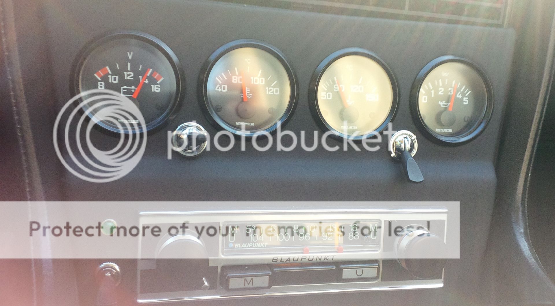

Guages
Bit of thread swerve, sorry. What do the toggle switches and the green warning light do?

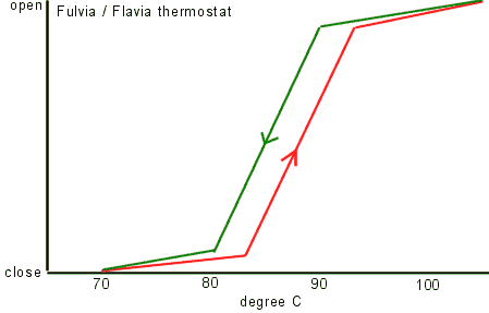

A thermostat is not an exact device.
The Fulvia thermostat is of the wax pellet type. The wax melts at 83°C. Because the wax expands quickly and strongly when it changes phase from solid to liquid, it opens quickly between 83° and 93°. Between 70° and 83° it opens slowly due to thermal expansion of the solid wax. Over 93° it continues to open the last bit due to thermal expansion of the liquid wax. The thermostat has an hysteresis of about 2 to 3 degrees, which means the temperature has to drop 2 to 3 degrees before the thermostat starts to close. If the thermostat ever overheats, it is advisable to replace it as it may be internally damaged.

excellent info, Mike, thank you
wax in the lancia's, what would be in our coupes ?
