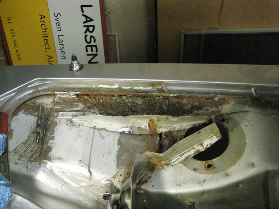

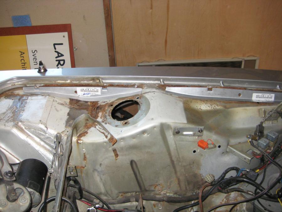

Rob, yes there is a lot of learning as you go, but it is not rocket science, and it is definitely not a project for the timid. On my site I show a fair amount of detail for removing the rear panels. The front fenders are similar: 1. at the vertical seam of the door jamb (by the hinges - you will need to remove the door first). 2. at the bottom corner of the window at the two narrow sections (remove lead to expose welds, etc). 3. the front top corner of the fender to the front valence is a butt joint. You can see/feel it from underneath (take out head light assembly). It is a bit tricky getting to the weld below the headlights at the very bottom of the front.
Attached are some pictures of the two angle pieces that connect the top of the fender to the inner fender. These are spot welded on both the vertical and bottom leg. Remove the paint and tar and the welds are generally easy to see. You can also see the front joint to valence on the "Body Re-assembly" section. If you buy the replacement panels first then that will help to figure out how things go together/come apart.
