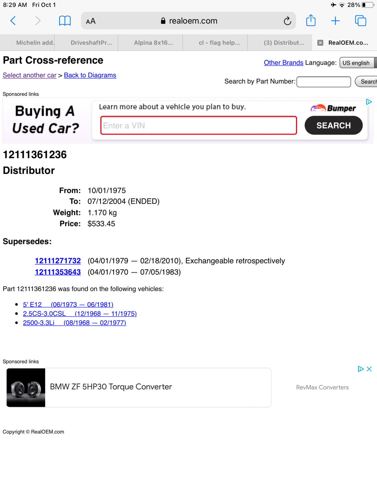

That is definitely helpful. And they were the first folks I called when I started this process almost a year ago. My new question then is how to cross reference a Bosch part with a BMW part number. I suspect the “part store” can tell me but how to they look it up?

You don’t need to specify model or it will limit your search but I do select Classic. One used to be able to search a Bosch part number data base.

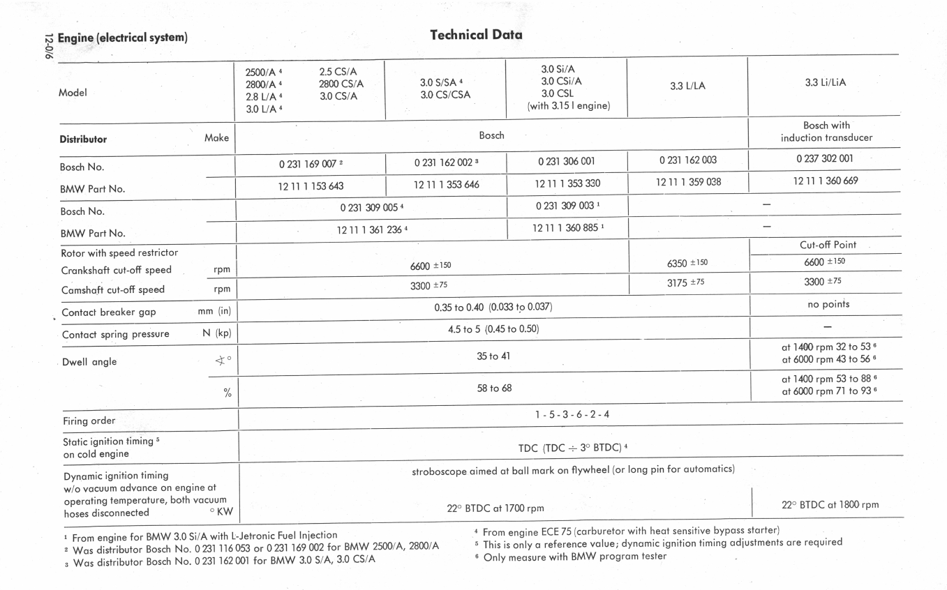

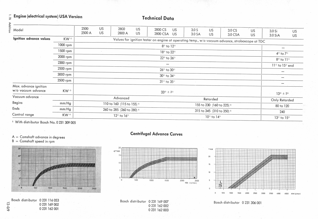

Here is the distributor list from the "Engine-Electrical" section of the repair manual. It shows both Bosch and BMW numbers. In that same section you will find some useful advance curves and other specifications.

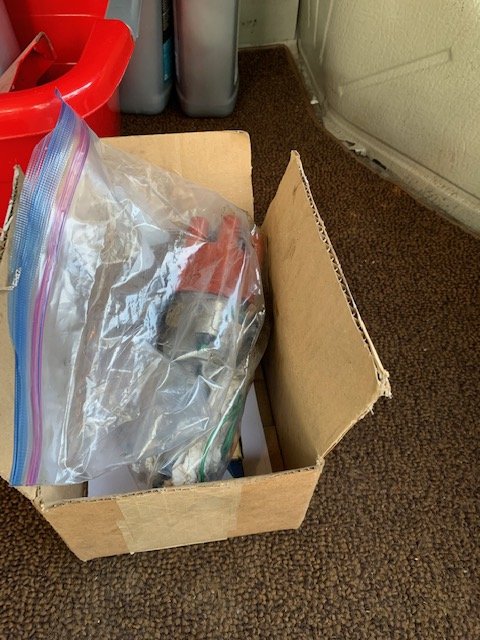

I trust them 100% in the exactly the same way I have always trusted any electronic ignition: I keep the original mechanical distributor/coil/resistor already set up and ready to go in a sealed plastic bag under the rear seat!
I 100% feel this, Hal! I just drove it 9 hours to Boston yesterday.... and this is among the few spares I packed in the trunk:

Yes a spare 123 is in my box of misc. breakdown items I take on long trips. I always keep an extra fuel pump under the spare tire.
