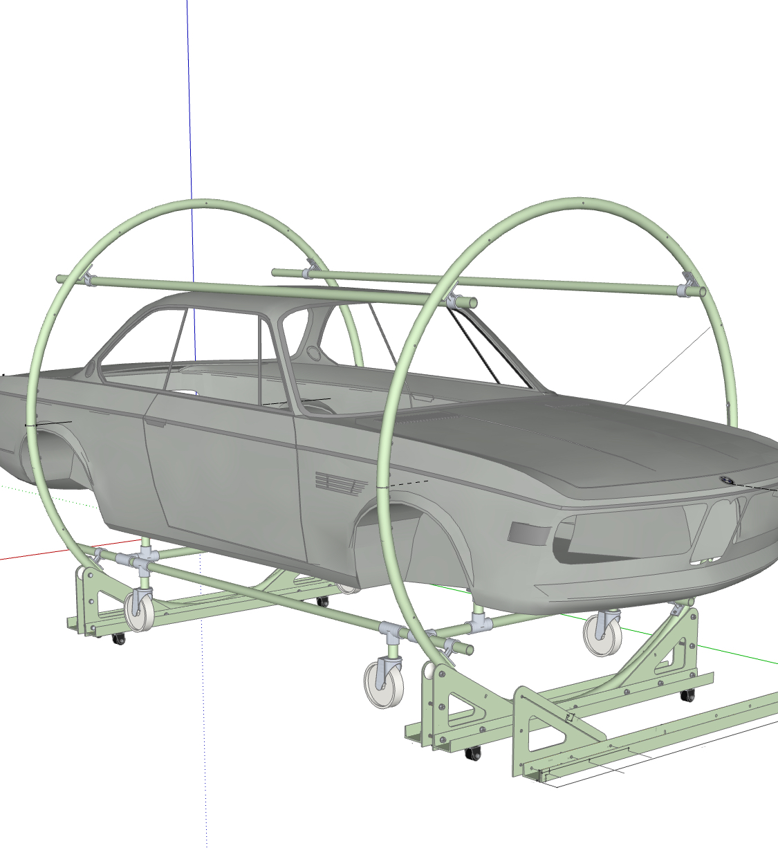

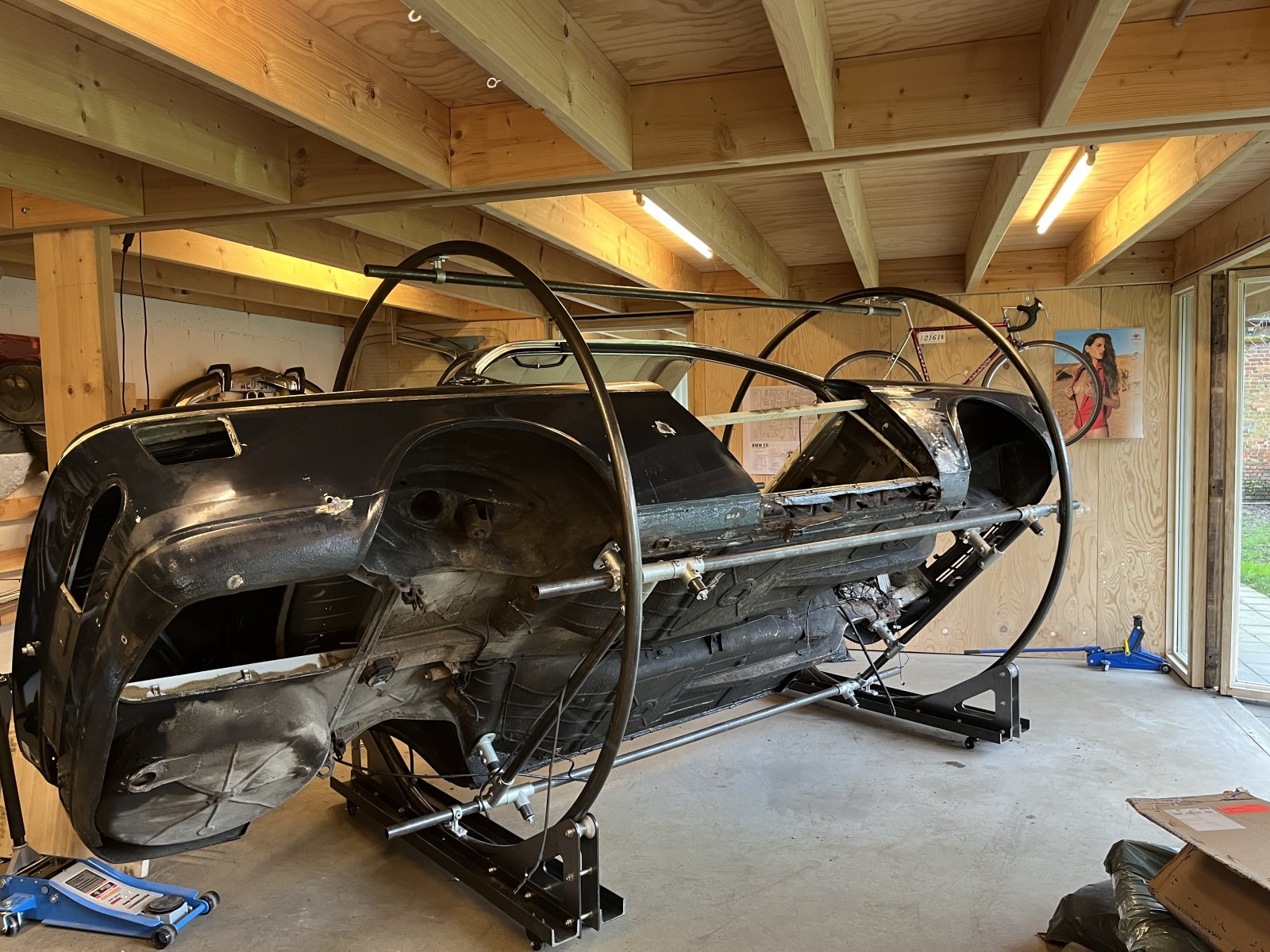

I'm exited about the rotisserie I made for the uncoming bodywork.
Here's why:
- it took me a just a couple of days to assemble
- it's a rotisserie and a dolly
- it supports the car at the right mounting points, not at the ends (bumper-points) of the car like many other rotisseries
- it's about the same price as a classic rotisserie
- it's easy adjustable for other cars, without the need of welding. Just loosen screws, adjust positions of mounting points and retighten.
- most classic cars will fit: De Tomaso's, Ford GT40, Porsches,....
That's why I'm sharing this with you guys. If someone some day wants to make the same thing, just let me know and I can send the Sketchup-file.
Anyway, after a period of departing the car and making this thing, I can finally start on the adventure of the bodywork!
