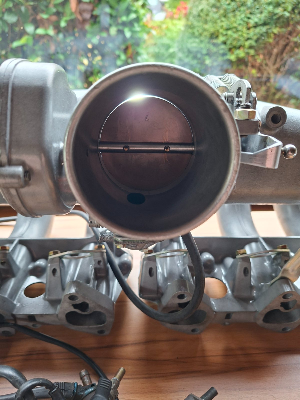

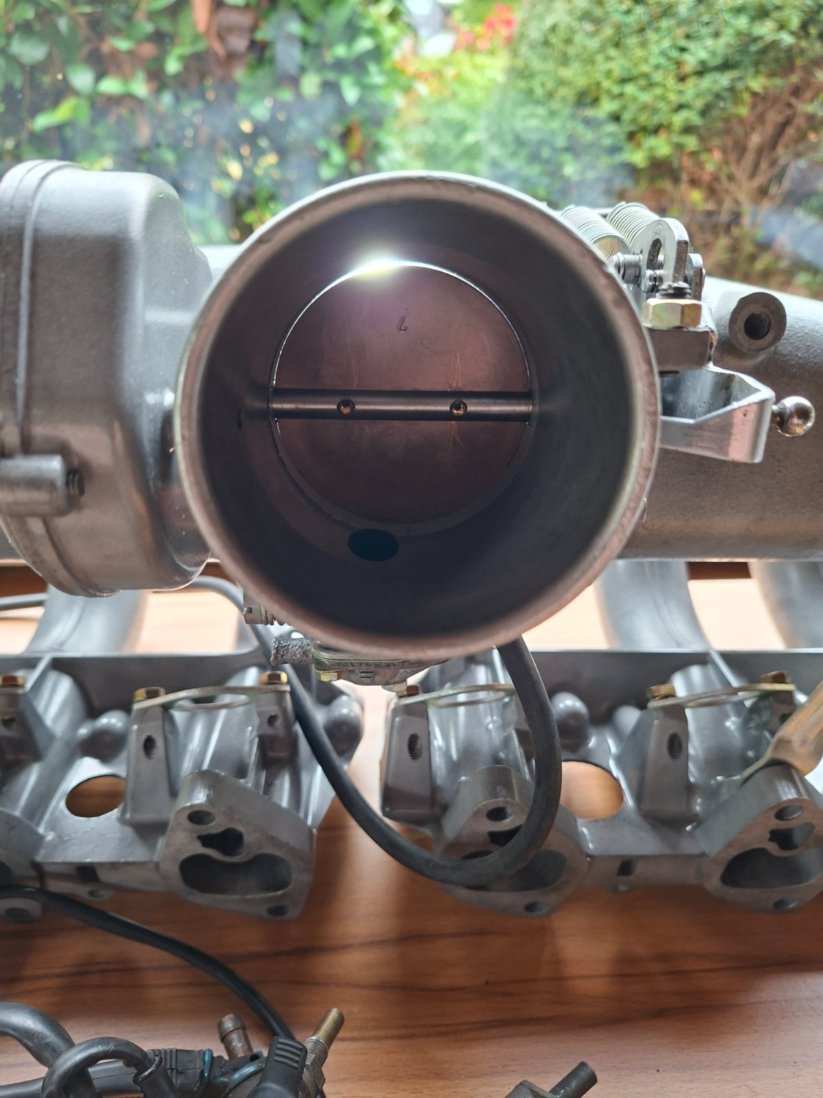

.....also check and clean the throttle valve. Oil and dust tend to accumulate in front of the flap, sealing it off completely.
Take off the connecting piece at the CSV and use a torch to inspect the flap from the backside. You should see light of the torch at the edge of the flap.20251006_103900.jpg

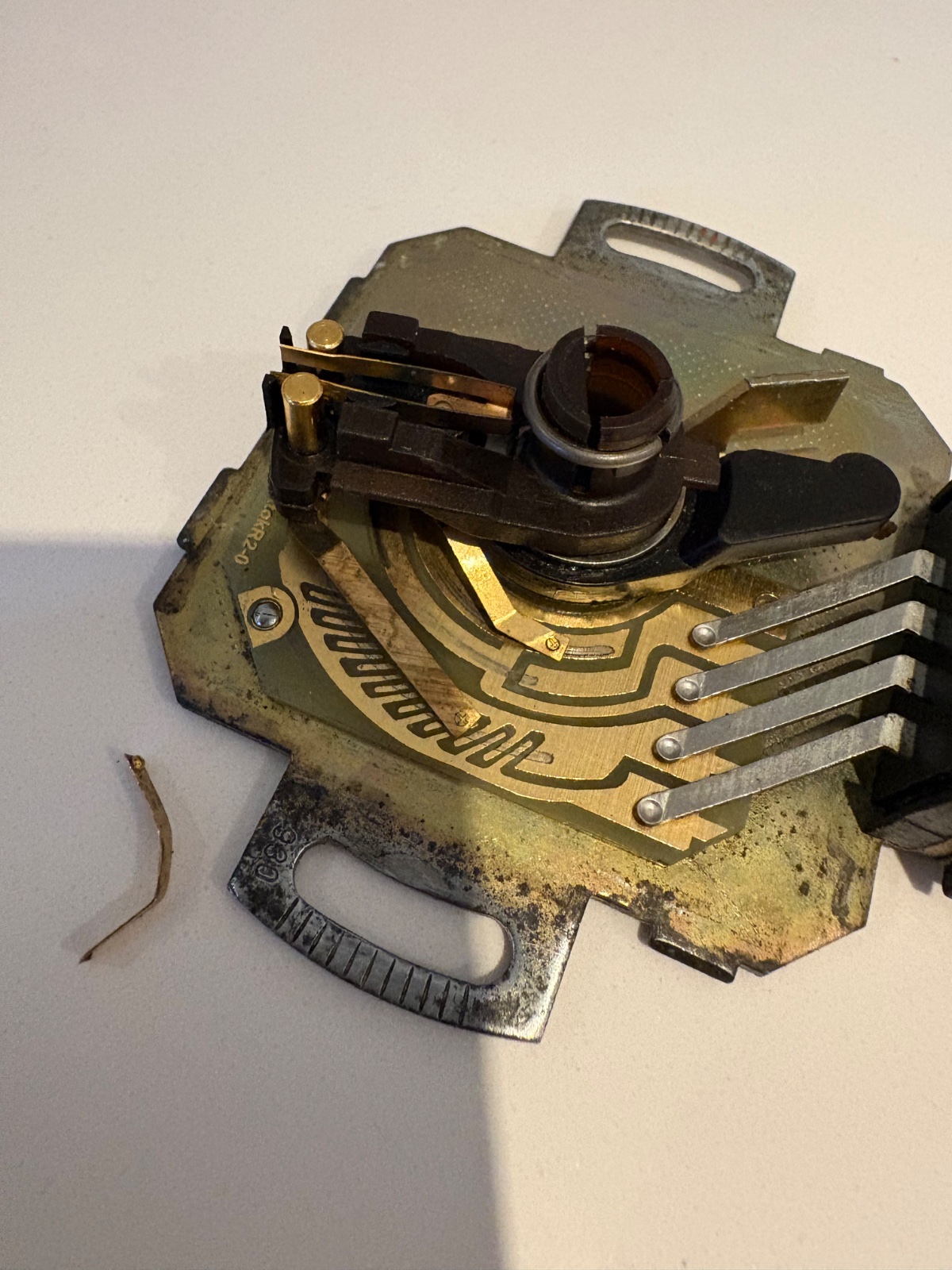

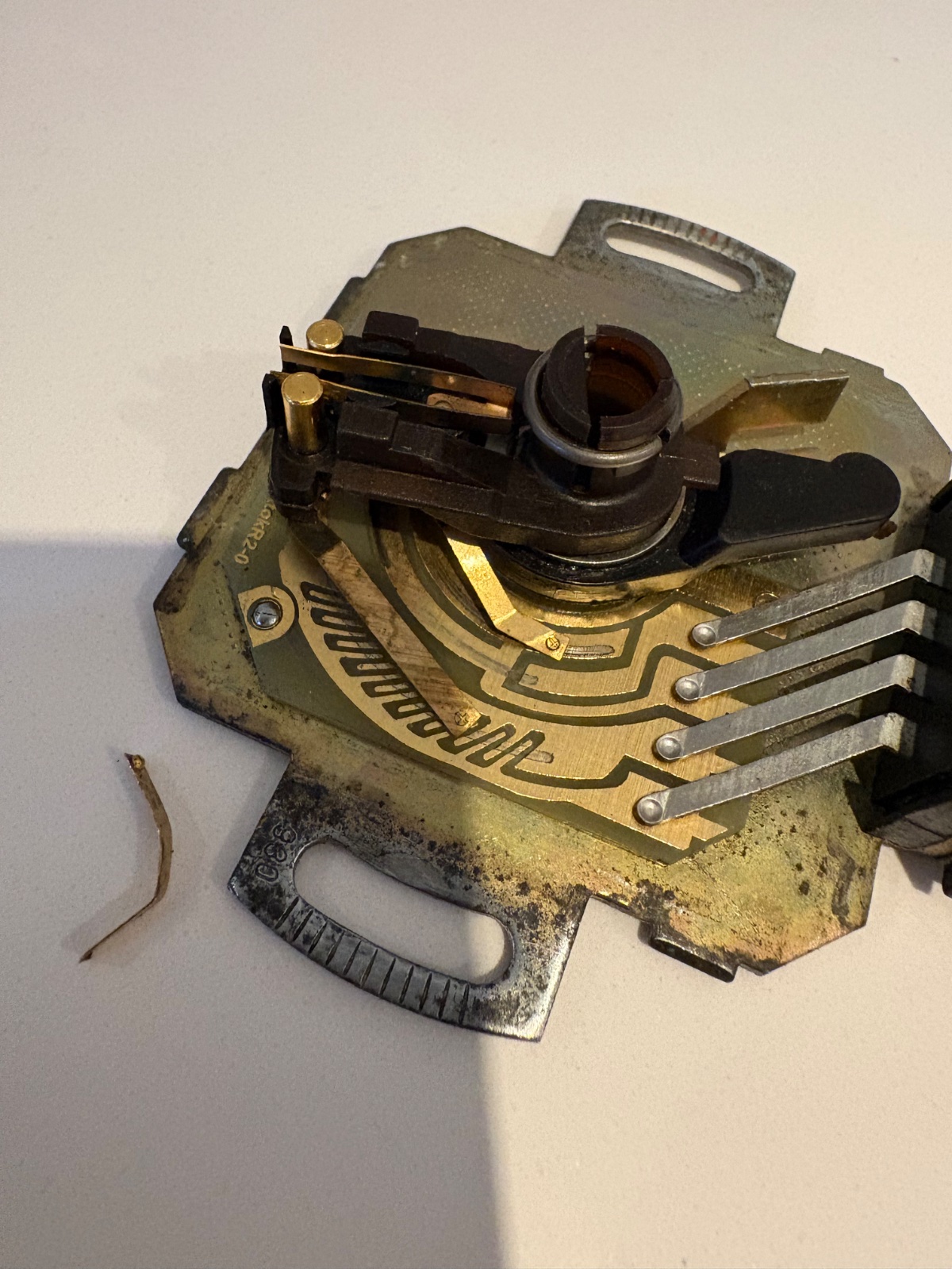

The issue was indeed with the TPS.
The car was driving fine, the only issue was briefly during cold start. On checking the TPS position I couldn't get a reading from my meter, so I took a closer look. On removing the cover I found a loose & broken armature, from the idle circuit.
Luckily I had an old spare TPS to replace it with, and now everything is running fine.
Does anyone have any specialist knowledge on how to remove the armature assembly from the TPS ? - You would think it would be straightforward enough, but I've tried and have no clue how to do this.
