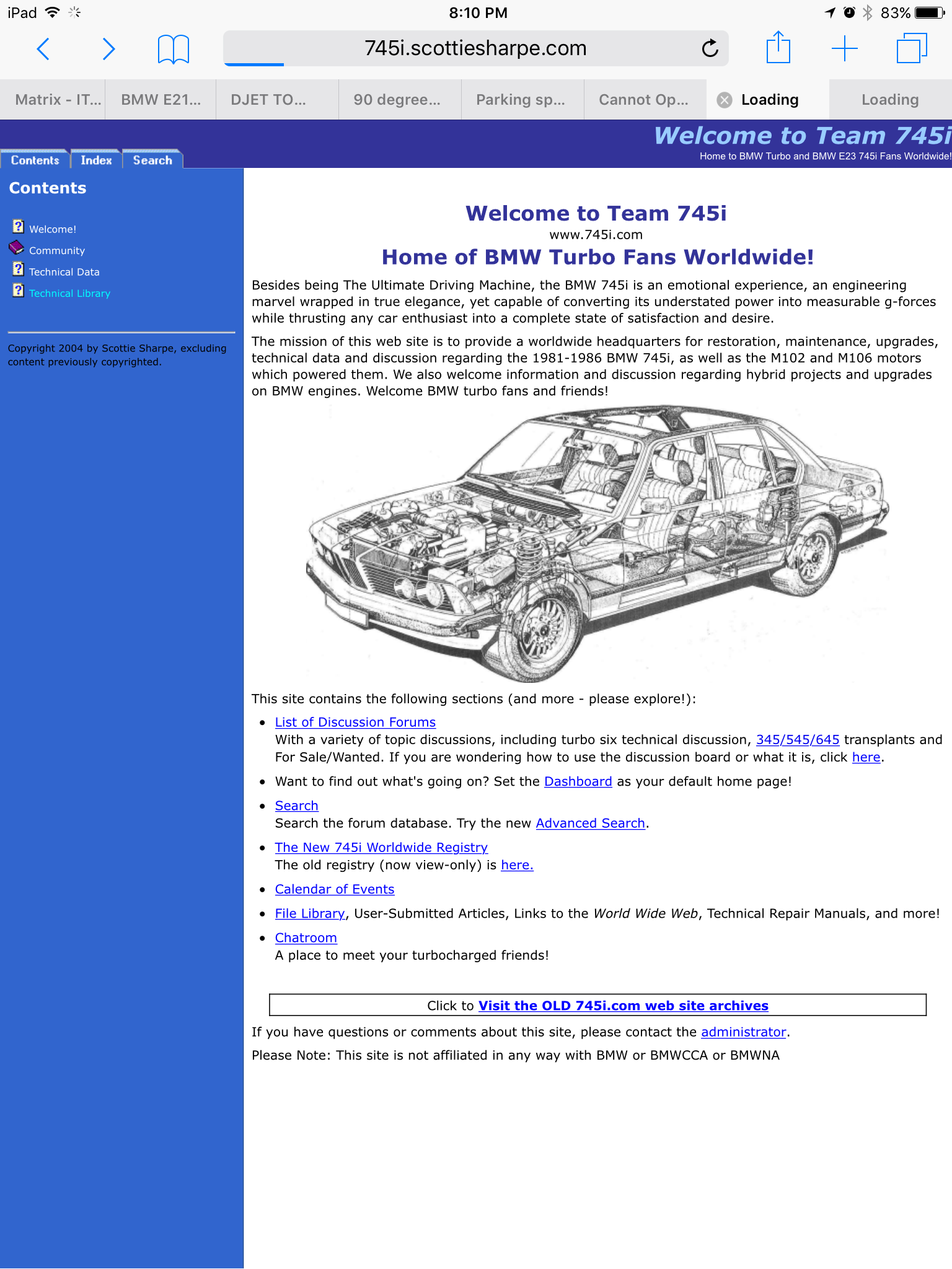

Howdy- go to Scottie sharpe.com
Those are my files in the library about 1000 pages
There are only 4? People with the original Schematics in the USA for the m106
Let me know if you want a copy
You need to contact me if you want into the site.
