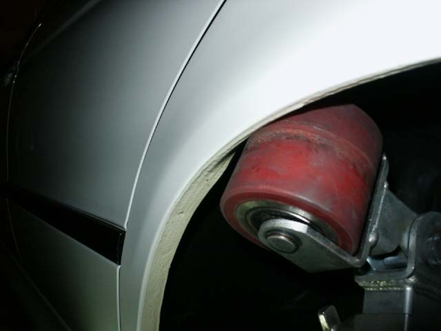

When you describe "wheel-well edges," I take this to mean - fender lips. Even with a fully compressed stock suspension, it strikes me as odd that your front tires would contact the fender lips - if you are running stock 14" rims with the correct/original offset and normal 195 - 205 width tires. Your symptoms are far more common with 16" rims, and 205 x 55 tires - and many of us have rolled the front fender lips to alleviate this issue.

Check the inside fender lips- maybe someone before you had a problem and the lips are out. In a pinch- an old baseball bat between the tire and lip, slowly roll the edge.
