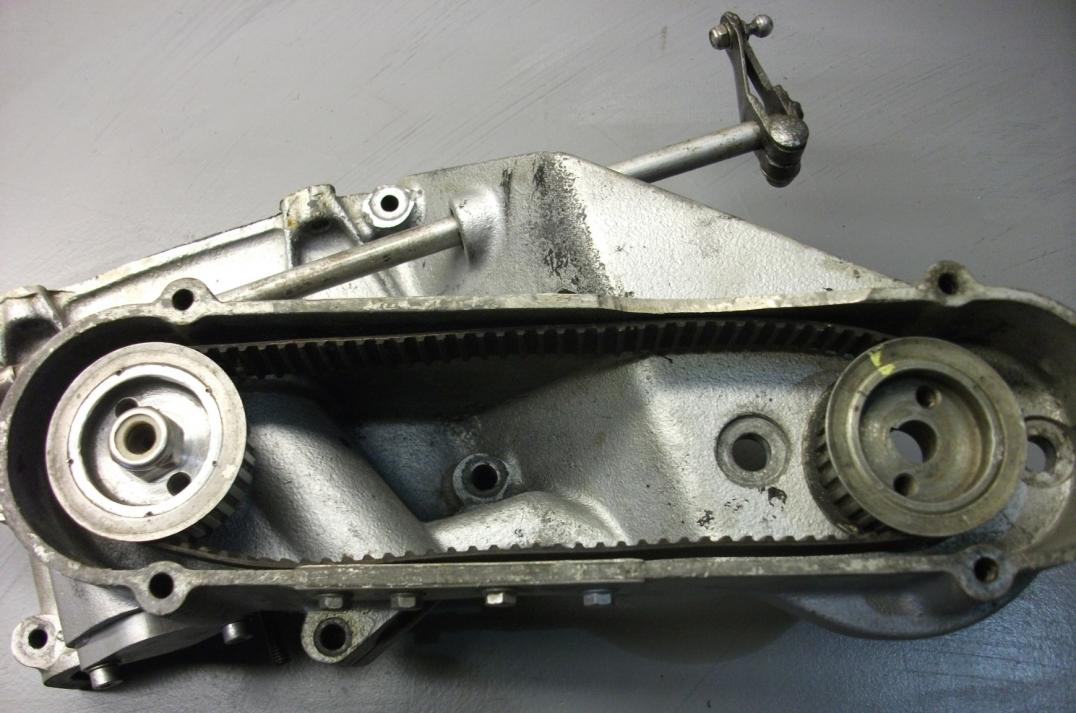

Well, it's conceivable that the space cams are the same between the 2.6 liter Capri and the 3 liter E9. In race trim the two engines were comparable. If you're willing to roll the dice on the interchangeability then your next problem is the drive mechanism. Here is what you need, or need to replicate.

Yes, that must be the difficult part... :(
I think it's better to wait for a proper set.
Thanks a lot for your advice.
EDIT:
Nevertheless, how much difficult would it be to find one of those? Are they around?
They appear from time to time. You could ask Chris or Alex Elliot (at Roundel Racing- he is on this forum occasionally). I hate to discourage you but these are really hard to find parts and very expensive when you do find them. I haven't even mentioned the slide throttle assembly that normally goes with this! I'd suggest triple side drafts instead...

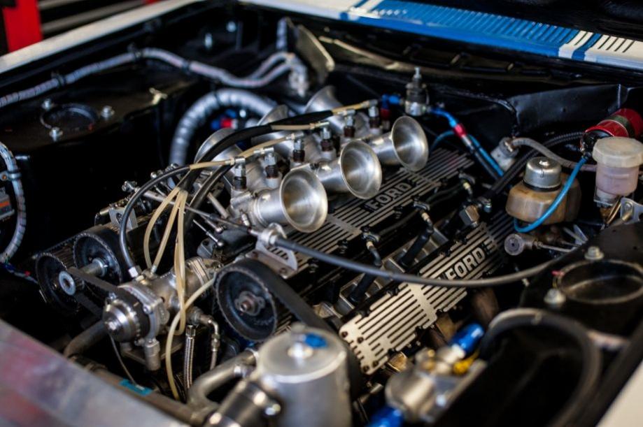

And here is that Capri race motor.. just a gorgeous bit of machinery!
