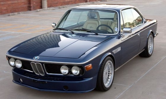

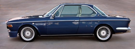

I am looking to see what size 8" front wheels fitted and what et they had.
Even if the owner is not here (or is but is keeping schtum) I would appreciate any advice. I have 8.5" x 17" wheels from my B10 but they do not fit.
Thes eare 8" but the only ones I have found are et46 which means the wheels foul the struts.

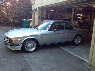

Apropos of little response and for anyone else wanting to put a set of wheels like this on their car, the front wheels are Alpina Part Number 3611648.
I just bought two, so will see what they look like............but I had earlier today bought 4 BBS RC090 Style 5 wheels which are 8j x 17 et20 which fit our cars.
They need refurbishing which I have started but they will be for sale.
They look like this - Decoupe's car I think - which is rather nice.
The tyre size needs to be 225/45/17.
Any takers from the UK?

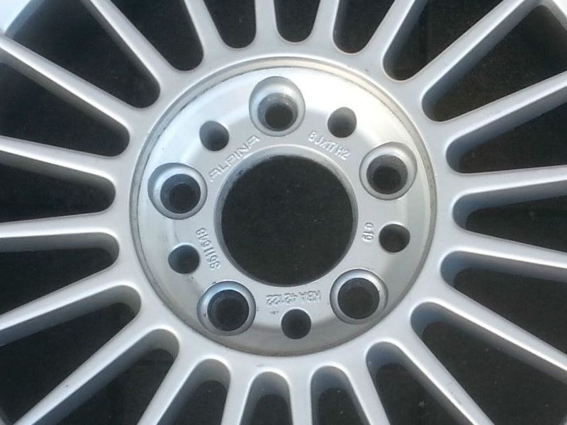

Hi Rek,
Edit: Oops I didn't catch your second response. Looks like you are good to go!
What you are looking for is Alpina 17x8 ET19 , part number: 3611648. They are "winter wheels" from an E34. You can buy them new here:
http://www.alloywheelsdirect.net/bm...aloon_alloys/17_alpina_classic_c88_wheel_4527
