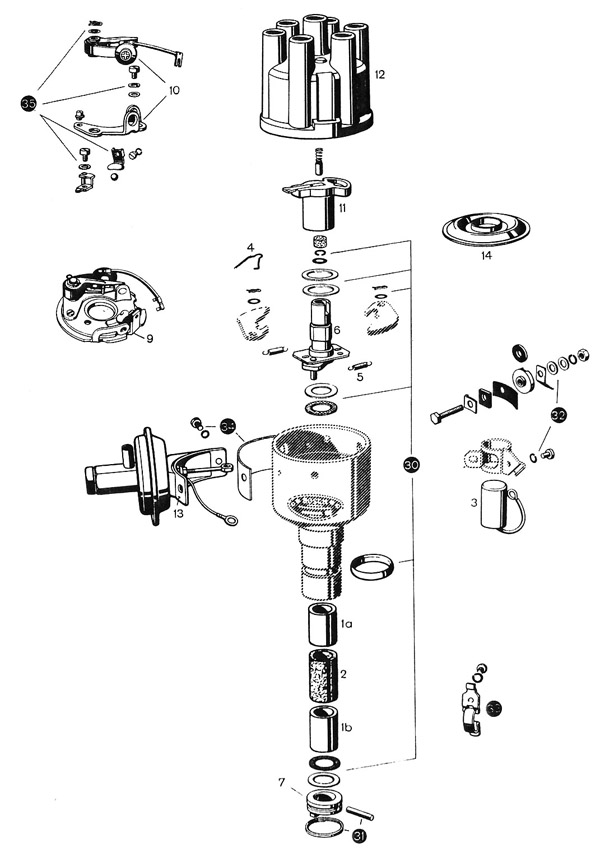

Depending upon the model, your distributor is equipped with two means of altering ignition advance and retard: (1) vacuum and (2) centrifugal. They are separate and distinct from each other although they work in tandem to obtain desired spark-ignition at certain engine speeds and loads. Yes, some distributors only have vacuum advance (e.g., Ford Load-O-Matic) and some have only centrifugal advance (e.g., early 02tii). The Ford Model Ts did not have traditional distributors and ignition timing was controlled manually from the steering column.
You mentioned vacuum. Ported vacuum from either the manifold or a carburettor typically pulls on the diaphragm attached to the side of your distributor. In turn, the vacuum pot is mechanically connected to the plate upon which your ignition points are attached. As vacuum is increased, linkage from the diaphragm causes the points plate to rotate, necessarily changing the ignition timing. If the vacuum diaphragm leaks or the pot does not hold vacuum, your vacuum advance will not function. Hence the vacuum test. If you apply vacuum to the vacuum pot and it doesn't leak, your distributor points plate may be restricted or the linkage is disengaged. Examine the points plate and you will notice it his tensioned with a ball bearing. The clamp that retains the bearing is adjustable and the entire assembly should be lightly greased and exhibit free movement. Same with other retention points, including the sistered distributor plate (See diagrams) If not, you need to investigate further. Too much movement is not good either as it is apt to permit irregular, rather than steady, ignition timing.

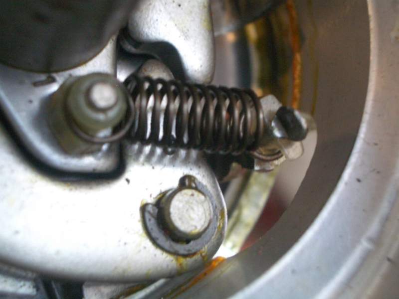

The second type of ignition timing control is centrifugal and consists of rotating weights and springs. It is, in effect, a rotating governor and should, like its vacuum advance cousin, be free moving, albeit with tension from the springs.
Since both types of ignition advance are mechanical, they are subject to wear and occasionally need attention. This includes checking for free movement and lubrication, including things as simple as oiling the wick at the top of the distributor shaft (under the rotor). As suggested by other responses, if your engine is running well, it is unlikely that you have a distributor advance issue. Pulling the vacuum tube at a high vacuum condition (while the engine is running) could be part throttle or even at idle depending upon the vacuum source, should provide a decent indication if the vacuum advance (and/or retard) is/are functioning. The

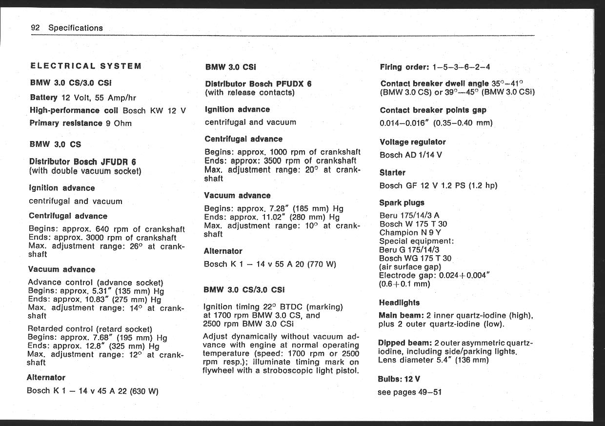

You can test your advance using a timing light. Is it reaching the max advance mark at 3,500 rpm? Does it start easily (suggesting that the advance drops back at lower rpm's)?

Like Jay says, check your advance at idle, at 1700 rpm, and 3500 rpm to see if it advancing.

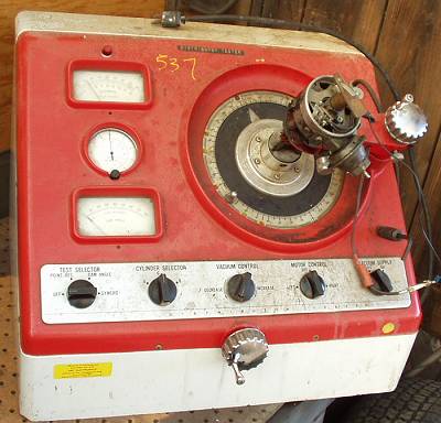

A properly functioning distributor is essential for a properly functioning engine. It is not surprising that a 40+ y/o distributor can have problems. Shafts and distributor bushes wear, centrifugal advance springs fatigue, associated bushings can deteriorate. If performance lags, a timing light is the probably the first order of business to empirically confirm a distributor malfunction. Even better, might be a distributor machine, with a large supply of different springs and weights for obtaining a desired timing advance curve. (For obvious reasons, these machines are becoming less and less common, as are the individuals who know how to use them.)
