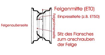

7x15 ET7 , they dont fit to E3 , because it is pressing into the brake caliper ! I sould likeso much to have them for my E9 ! What do you think is it possible a wheel to touch the caliper , i just cant beleive it !

You would need ET11 for 7" and ET 24 for 8" !
ET7 could fit in front, if you use a spacer.
5mm spacer you can make from the middle of an old brake disk....... :) thats the cheapest way......
And what do you think about the rear axle , i have vented discs and big calipers !
and what do you think about the price of the wheels it is 250 EUR !
A spacer will reduce the ET number, so ET7 will become ET2 with a 5mm spacer.
At ET7 these wheels already stick out a little too much, a spacer just makes it worse.
