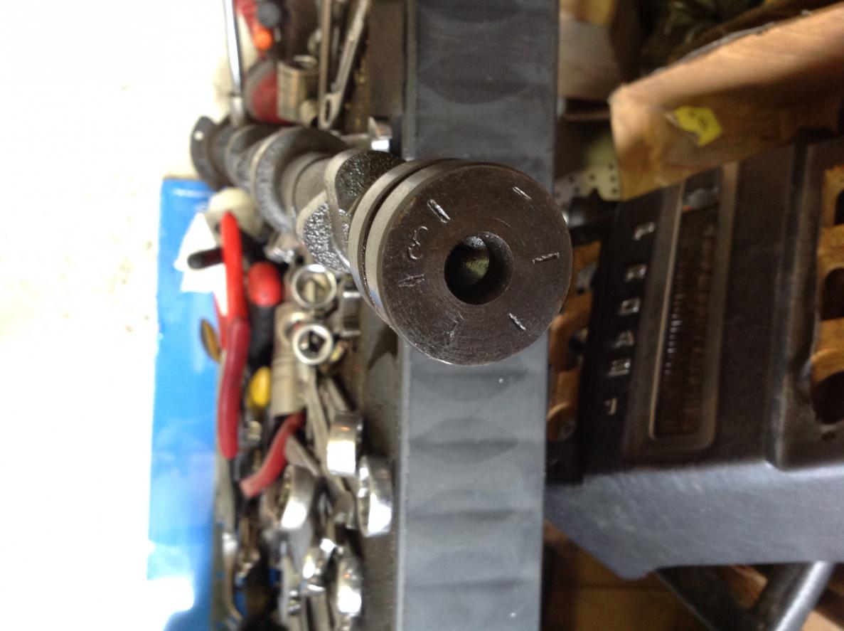

The only number I can find on my camshaft is 1255 930
(It has BMW stamped on it, but could be reground I suppose)

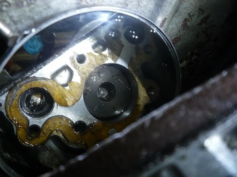

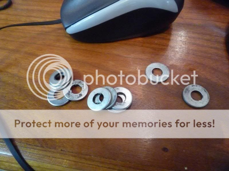

Ok, removed the cam cover, wasn't expecting a lot of washers to plop out. Hopefully I have them all. I am assuming these are some kind of preload for the rocker shafts? I counted a total of ten washers (this normal?).
When looking at the photo , I cannot discern any real numbering on the cam. My eyes aren't the best though.
Anyone able to glean anything from this shot?
Tia

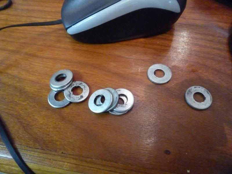

These are the washers that came out. They were between the cover and the rocker shafts. Any theories why they would be there?
There is a paper gasket below the cover and the head. (Pardon my ignorance Don, did you mean this paper gasket when you said "Seal") No rubber type washer to be found.
Well that rear shot gets me a bit excited. That little stamped triangle is a good indicator that it was a bmw motorsport/alpina camshaft.
For example, here's another shot I snapped of another NOS MS/alpina cam.
If you get a chance to put some calipers on the lobes it would be good.

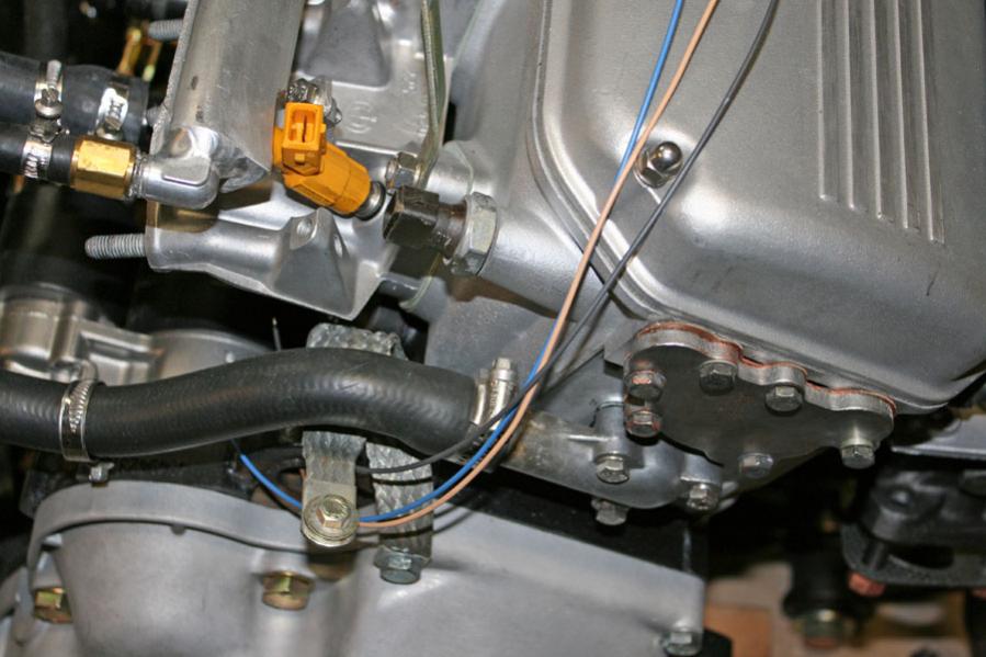

There is a paper gasket under the cover / plate and one of the bolts (the one in the upper right of the photo) has an oil seal washer. I think it is just an aluminum compression like washer. The other bolts just have wave lock washers.
Yahoo!! That sounds great. That is exactly what it looks like. I get the feeling I am going to have to run Avgas in this motor!!
Yup, that is what was there. One thing about this motor, every bolt I have taken off has been very , very easy to unbolt, almost like it is a fresh rebuild....without any thread locker.
That seal at 3:00 is very special and very needed
Exaxmine the plate, the gasket and you will soon see
Why a special compression seal is needed for that one bolt.
There is a reason why no washers are used on the cam plate.
Too much torque will blow the gasket out of place

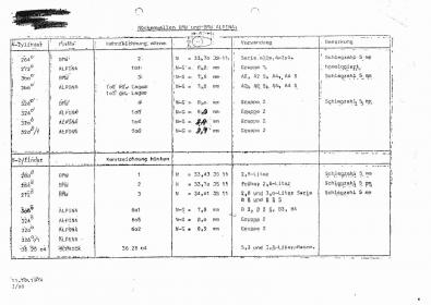

Peak - Base = 7.6 mm for the MS/Alpina camshaft.
The 272 cam has 6.8 mm
