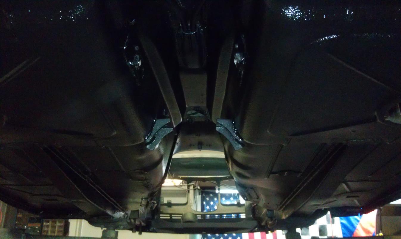

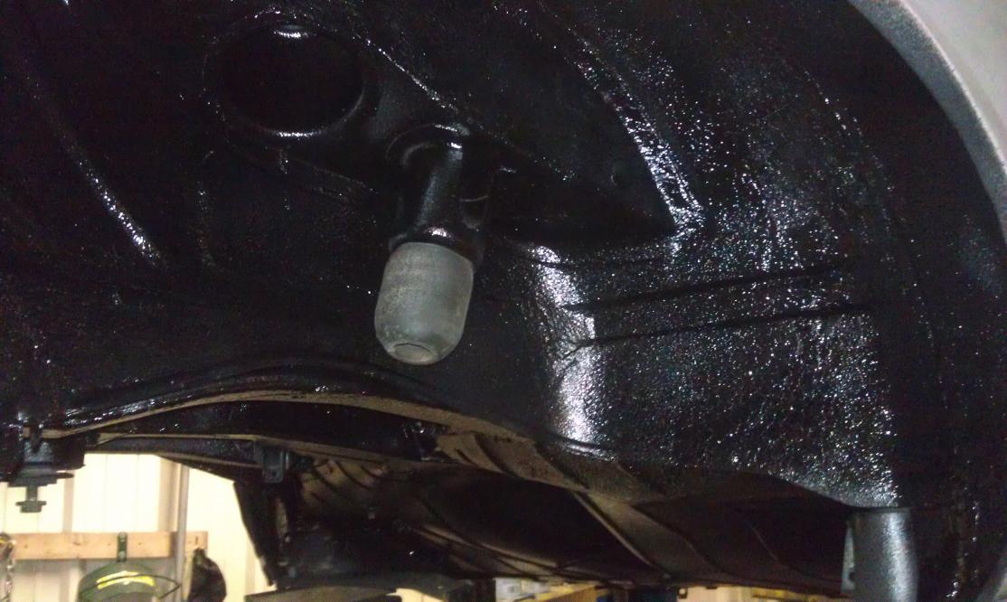

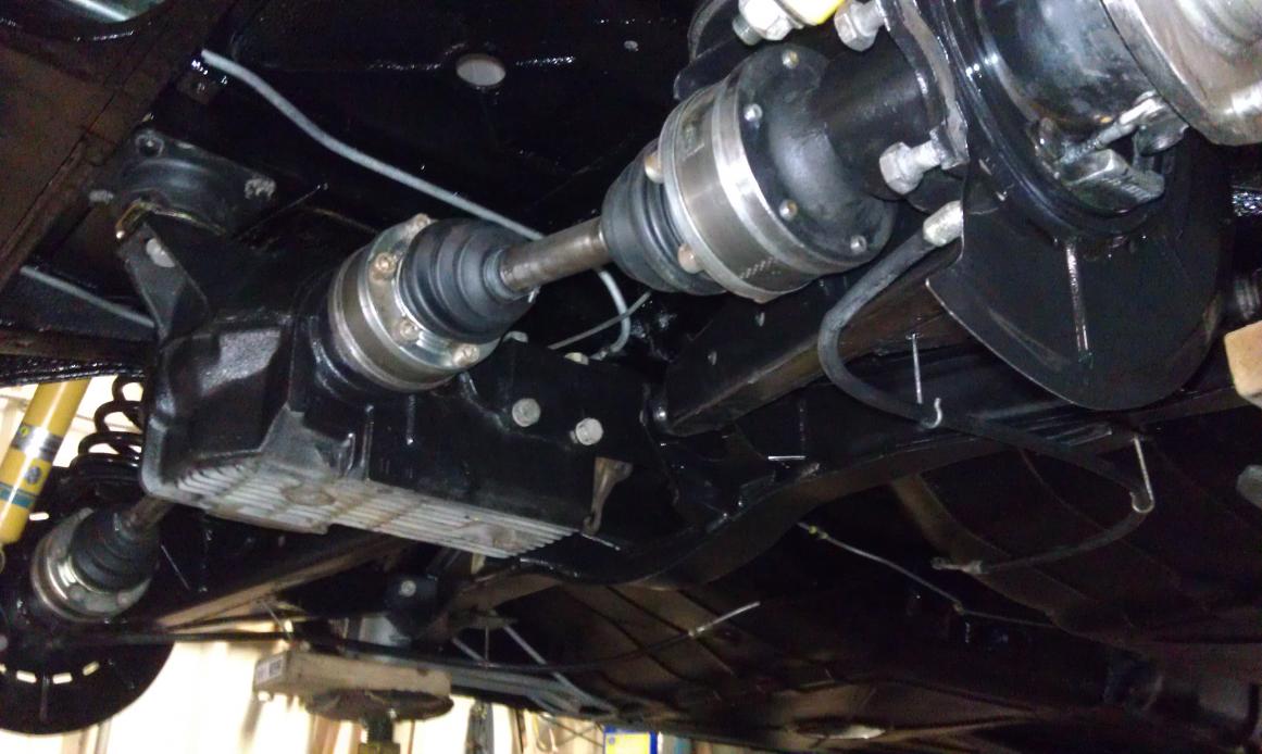

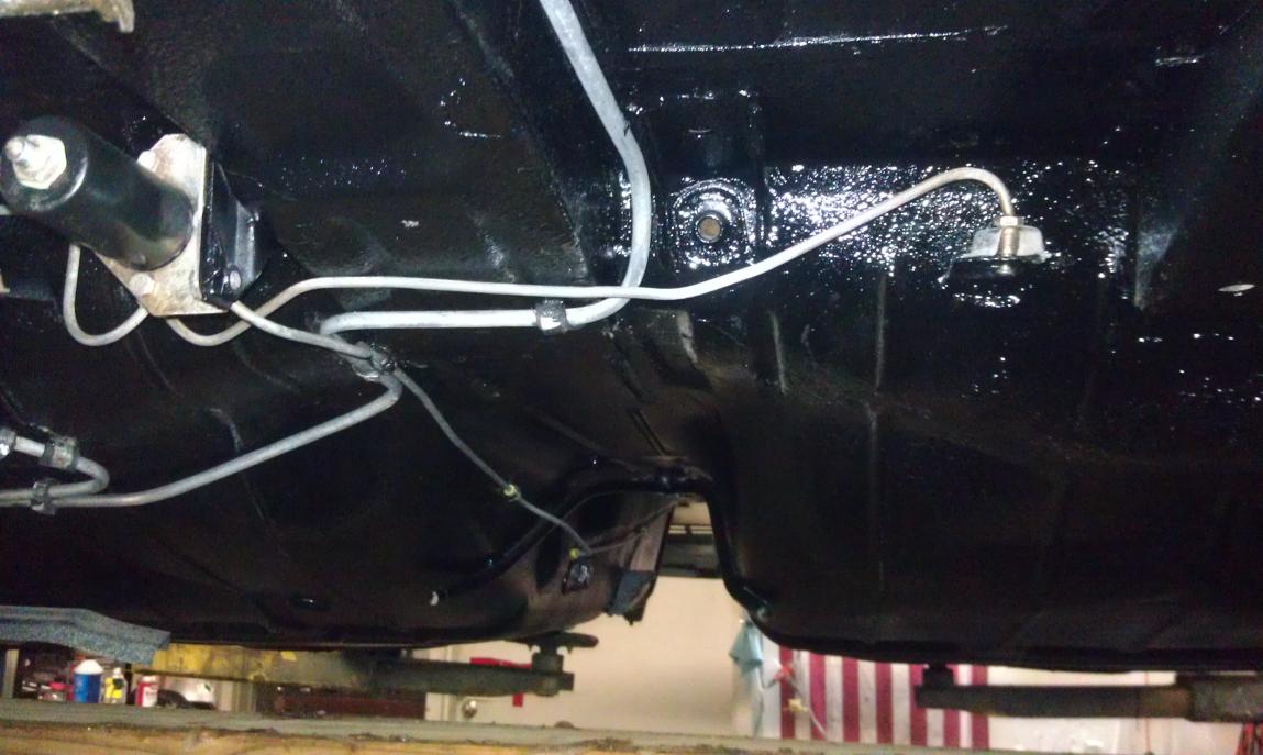

I, like many others wanted a "like-new" looking underside since I was putting that much work into the suspension and I had to take everything out anyhow.But I have to agree with John B. That stuff is stuck on there and it's brutal to remove. What I did was thoroughly wash the underside using a power washer, brushes, soap, grease cutter and then power wash it again and that revealed any loose coating which was scraped. It takes a long time and I have heard that the cheap air scrapers don't work that well on pliable coatings and in the tight spots, and that's where you need to get to most likely. You can spray some thinner on the greasy stuff, brush and wash again- then dry it with fans for a day or so and use compressed air to get in the tight spots- you'll want to rust-proof those crevices anyhow. After you apply primer, paint and new undercoating to the scraped parts what was suggested to me, and I did, was paint over the undercoating with black appliance paint-like you would paint a fridge with- that way it can be easily washed. Results attached- Tip: if you don't have a lift-see if you can borrow one for a weekend.

Thanks for the Tips Guys. I guess I will leave the areas that are clearly solid alone and just scrape it down to the bare white undercoat, give it a solvent wash and recoat it with Grey rubberized sealer. Any seams however will have to come clean to insure that rust is dealt with completely. I basically don't trust undercoat. It has killed many a car in Canada when it dries out, water gets trapped underneath and rusting accelerates. I feel that working on an E9 is kinda like an artifact that you are doing your best to make it last longer than 1 lifespan. I do not have running water in my shop. I have a 50 gallon drum filled with water that I can use with a Campel Hausfield pressure sprayer for small stuff. On the White undercoat I did an experiment with Mastic Solvent used for dissolving flooring adhesive and it did work pretty well. I am very interested in getting a needle scaler now that I see what can be done with one. Looks indispensable for prepping rusty metal before welding. I expect this will take a while to complete. I still want to seam weld the floor like on the Coupeking website and perhaps add the Diff reinforcement plate while I am at it.
