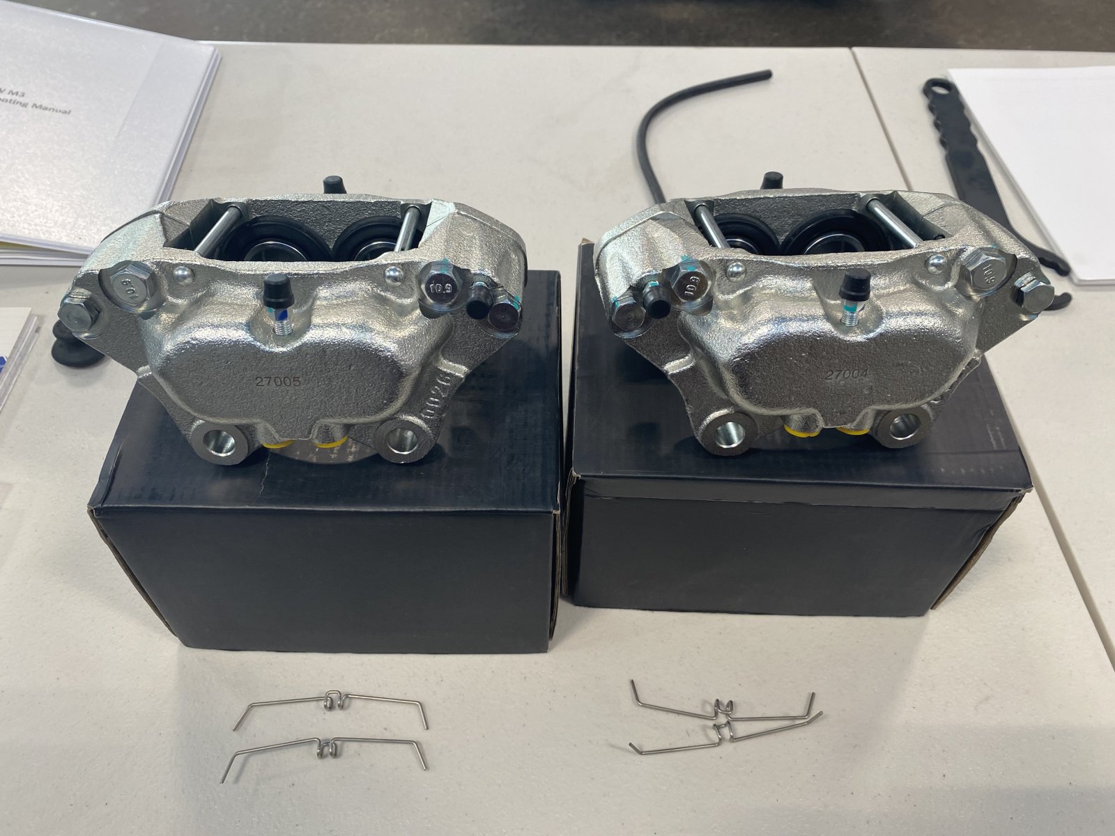

A month ago, I read a classic comment by @sfdon Not an exact quote but something like "...any idiot with a pen can mark a bolt head..."
So, after spending many hours searching for genuine "Girling" front calipers (for a 2002 project car), I gave up and ended up with a different brand caliper, of course made in China. Frankly, out of the box, they look good, they seem to fit perfect, and I will know more once I bleed them.
I noticed all the torque makings on the caliper, and it really impressed me. But then I remembered Don's comment, therefore I decided to test all the fasteners. And good enough, half were hand tight, and the other half were not very tight!
In the old days, torque marks on a fastener meant that the fastener was torqued to spec, today it means that the marking pen works! :(
...I'm reminded of the "remanufactured" Chinese injectors I bought (about $200 delivered) .Being the adventurous type, I rolled the dice....snake eyes ! ...fuel pissed out everywhere and lucky car didn't go up in a puff of smoke .Anything from Mr Xi is verboten here.
I spent many many hours searching for US/European replacement caliper, and I even reached out to some senior people in this space. But I have learned that for this class of product - production is 100% Low-Cost Country, specifically brake caliper production is dominated by China. This goes with the rebuild kits such seals and pistons.
I understand the root cause and have no problems with it as long as the product meets the original specifications. However, I know better...
Now I am wondering about the "10.8" on the boltheads? Is it a tensile strength grade or just a number! :(
