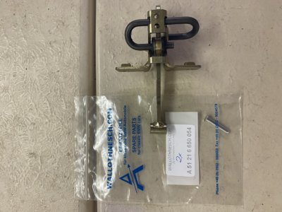

I installed the new version back when I got the car, fit and function were fine.
The door was a bit noisy so Don put the 320 version instead. I pushed the slider back in place and do not see anything wrong with it. If somebody wants to lubricate and install it I am sure it will work.
See picture.
See picture.

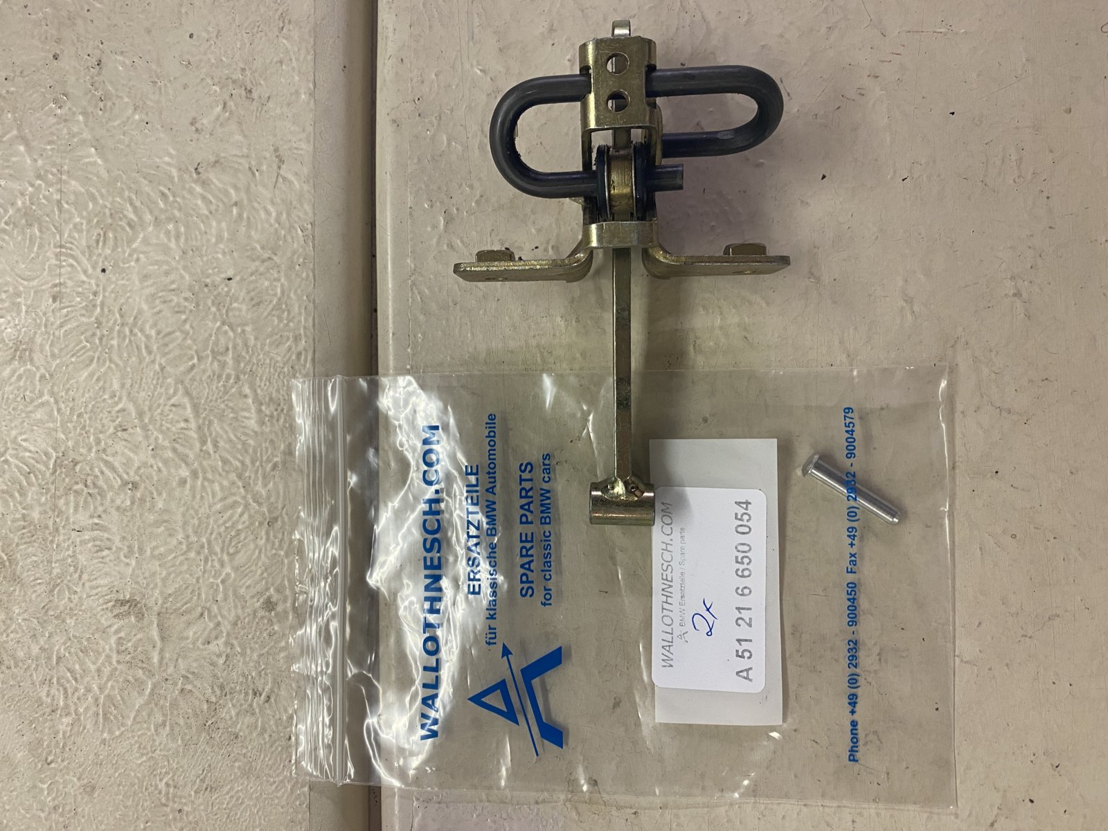

My passenger door brake just broke with a loud noise like a spring broke. I looked in the stuff the previous owner sent to me from Hawaii and found 2 of the brakes. One was completely painted dark metallic blue and the other is golden bare metal. I remember replacing the door brake on the 2002 and they didn't look like these.
A REAL OEM search found the door brakes for CS are indeed different than the 2002 brakes. Part # 51 21 1 819 364 was superseded with # 51 21 0 301 600.
I have not pulled the door apart to make the repair. Here's a pic of mine with the correct rivet that matches Arde's and the pic I found on Google.
What other door brakes fit our CS ?
