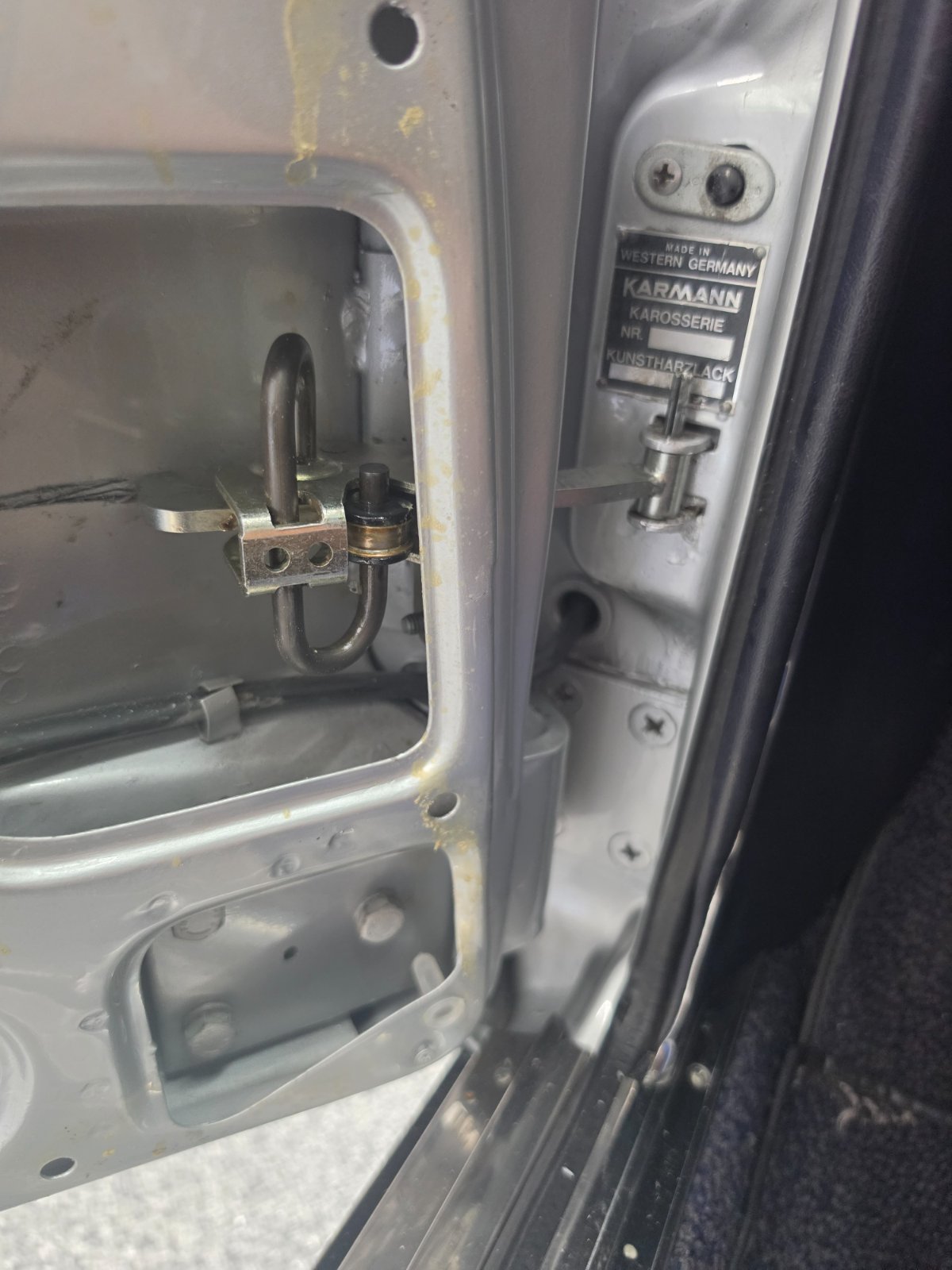

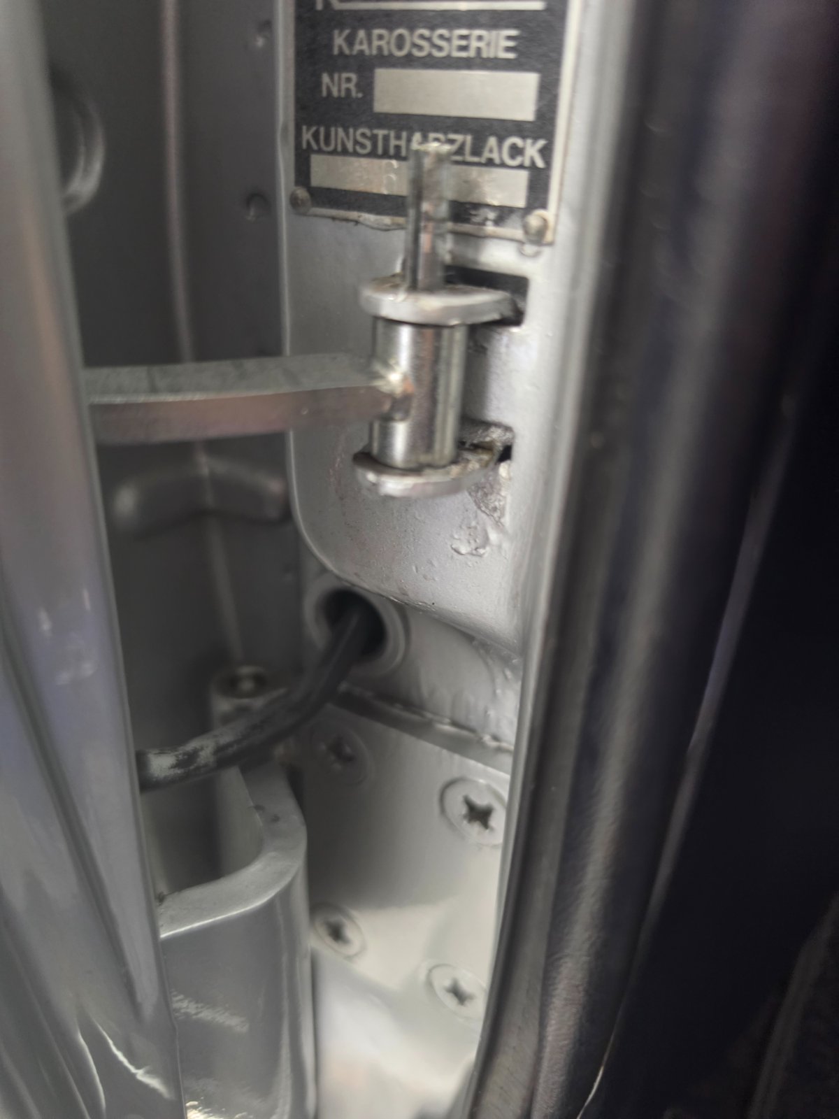

What is the trick for getting the split pin installed?
David
light taps with a hammer. be sure you have the door check in the correct direction. i had used one of those a while back and i put it on backwards + the door didn't open / close properly.
