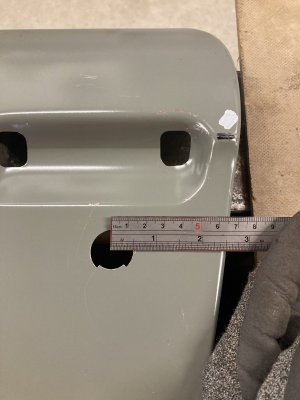

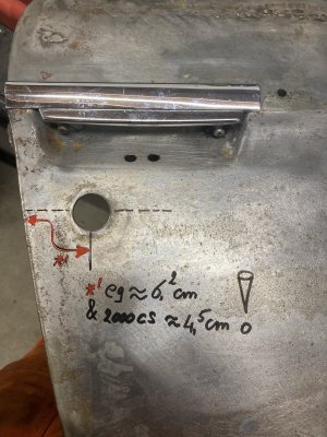

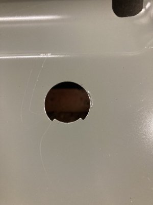

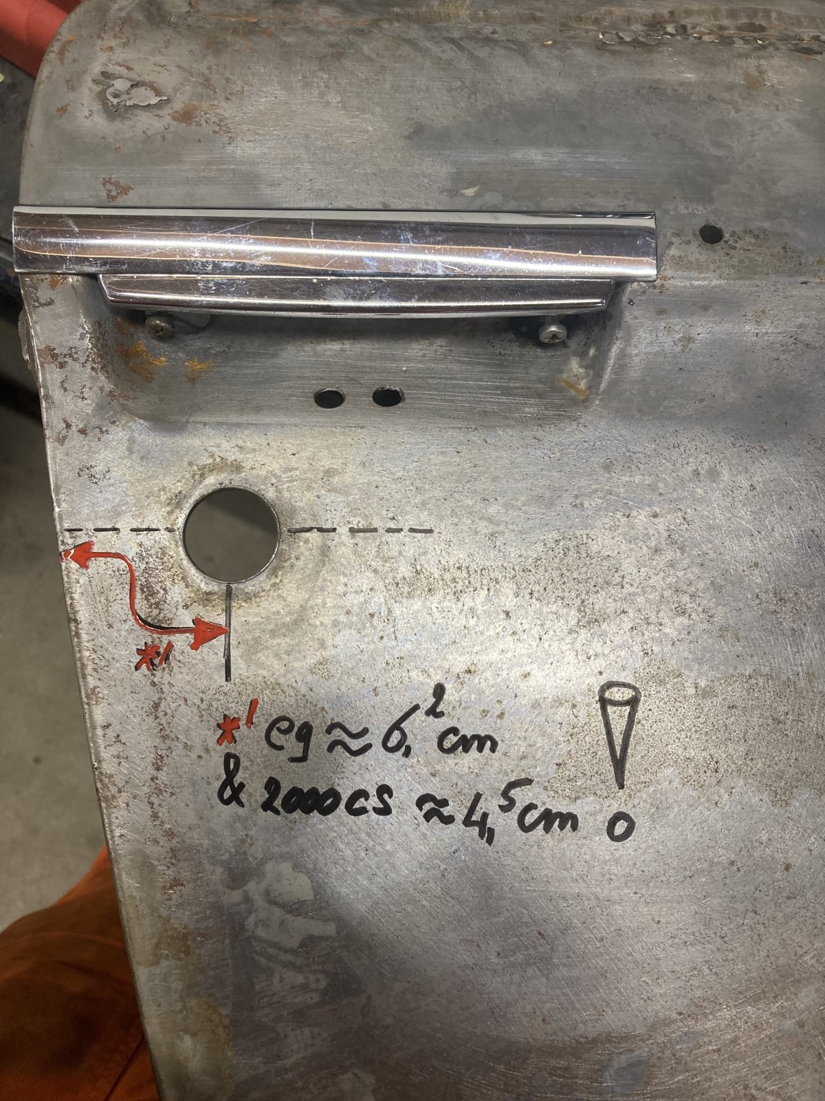

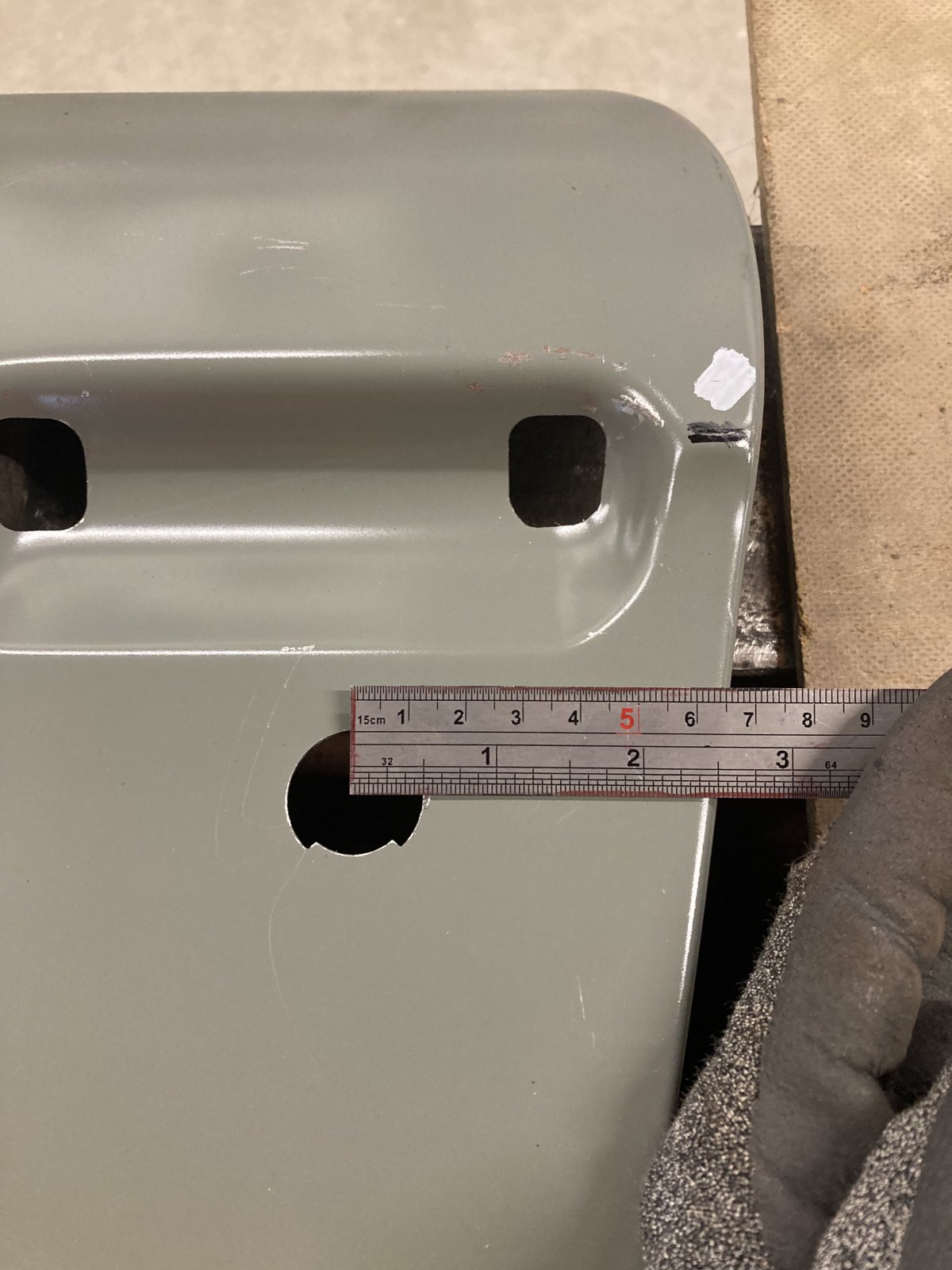

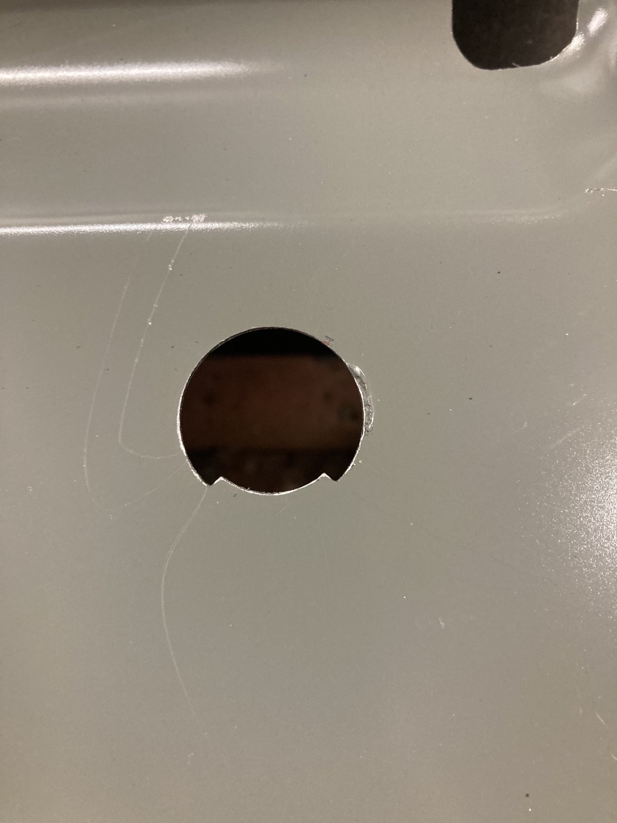

For information: one of the differences between a e9 door and a 2000CS door. See photo
There are some other minor differences; the key hole is rounded instead of the e9.
Good to know if you want to buy a door!
