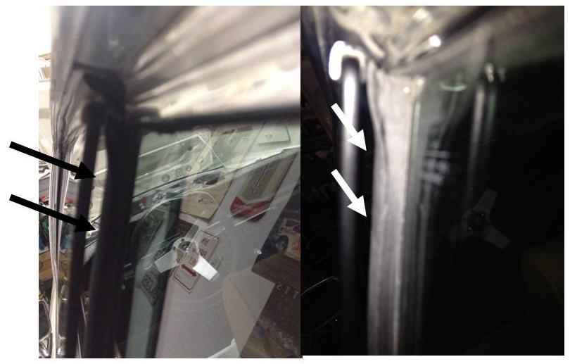

I am getting ready to replace the rubber window/glass 'seal' between the front and rear side glass. (we ALL know that can be a chore...!)
However, I noticed that there appears to be a large gap between the front side window and the rubber seal... (the pic shows two views with arrows pointing to the issue)
The passenger side is at least a 1/4" narrower than drivers side and makes a positive seal when that door is closed.
I do not think that the new seal is wide enough to make a tight seal.
The question is... what adjustment is available (inside the door) to 'tilt the glass inward to close the referenced gap? (FYI the door itself lines up perfectly with the body, but could the front wind-wing frame be adjusted too far inward, thus putting a bind on the whole window assembly?)
Any hlpe will be appreciated

You'll need to take a look at the door window rear rail. It is adjustable at both its top and bottom fixing (see DeQ's thread). Adjusting this will take the gap out between the side window seal and door glass

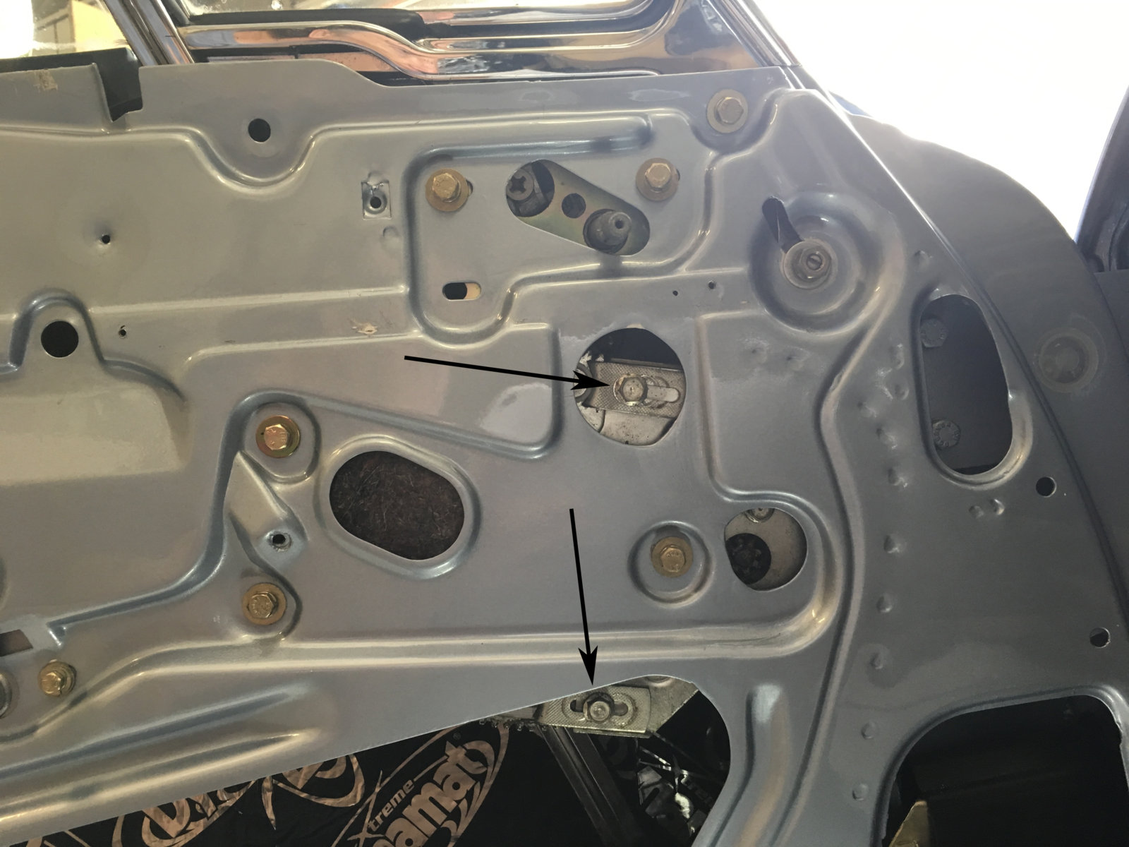

I have the mechanism in but have forgotten where the limit stop adjuster is and how to access it. I.e. front window.

With the front window mechanism installed am I able to access the limit stop adjuster? My window is stopping short of full height in the tracks and not meeting the door seal on the door frame.
The rear window adjuster is accessible and I have some success there including upgrading to the unit with a spring as well as the rubber stop.
Many, if not all of you, probably already know this but just in case another numb nut like myself searches for "Door window stop adjustment" here it is.
The top nut shown arrowed is for top limit adjustment, i.e. fully closed window position and the bottom is for -
