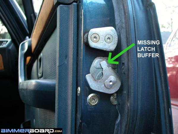

Solution to Door Latch closing
I stopped by my independent BMW mechanic the other day, and he noticed how hard I had to slam the door to get it to close. Turns out, there is supposed to be a little plastic cap that fits over the small "tit" on the door striker (the part on the door). In the absence of a part, I just cut a small piece of rubber hose and slipped it over the tit. Wow... amazing difference on how easy to close!
Later, on another trip, I thanked my guru for the tip. Then he mentioned he might have a pair of those caps laying around. He rummaged through his boxes, and sure enough, came up with a pair.
I slipped those on, and immediately my doors were transformed! Just a light pull now will positively latch the door! It seems this extra plastic/rubber piece is necessary to "trip" the catch on the door

Photos?
Grey plastic cap
Texascarguy means just what he says.
They are available from W&N and surely Maximilian too.
They are tricky to mount. One hand holds it in place with a pair of pliers, the second hand holds a piece of wood on top of it, the plastic part being held over the metal pin (needs to be pulled over to the first click, making it stand vertically, and the 3rd hand hits the wood with a good hammer blow.
I wasn´t aware that it facilitated closing the door as explained, esp. using less power.
It avoids metal against metal when the door first hits the striker plate.

Any pics of this 'fix/remedy' appreciated

part no 51211809735.
http://www.bimmerboard.com/forums/posts/368199
Picture of the door latch "aide"
Okay, here's a picture of the little part in question. It's the little grey plastic cap that slips right over the top of the door latch (This is the latch ON the door, NOT the door jamb).
I had no problem at all installing mine, in fact, just slipped them on out in the parking lot.
As I mentioned, as a quick-fix alternative, just find a piece of rubber hose with an appropriate I.D. that will slip over the post... cut yourself off a piece about 1/2" long and slip it on. Not quite as good as the real item, but you'll be amazed at the positive difference.
I'd venture to say that not one out of ten bimmers of this age still have this part intact!
