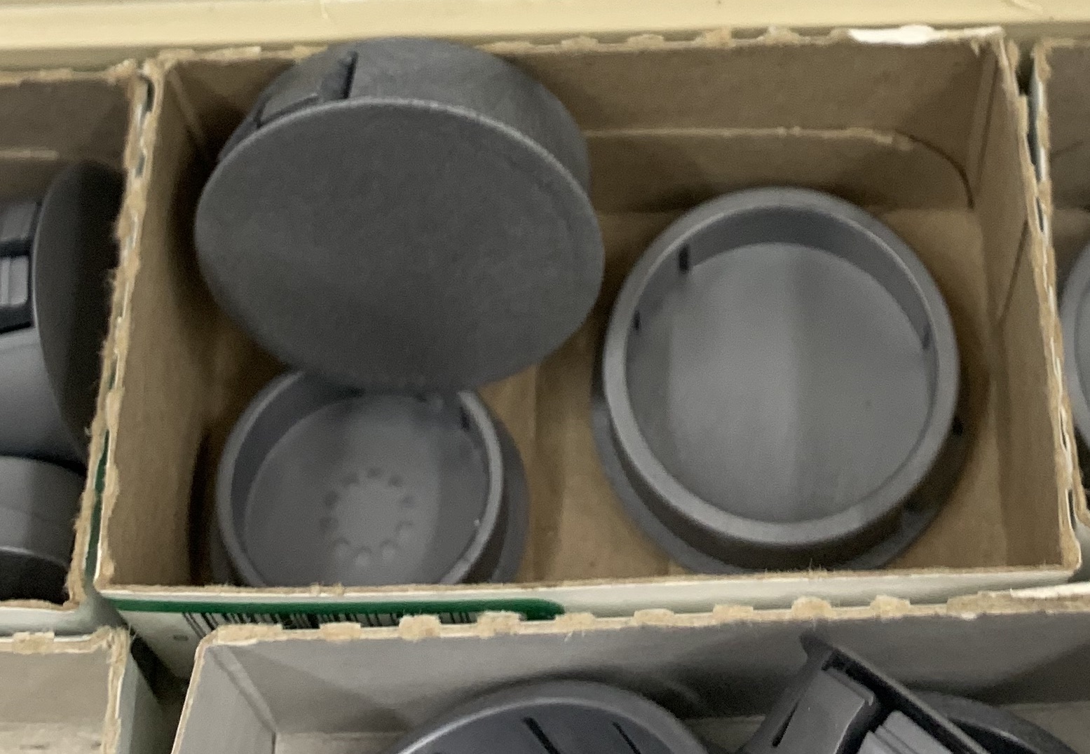

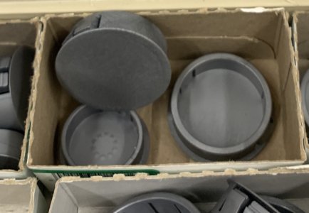

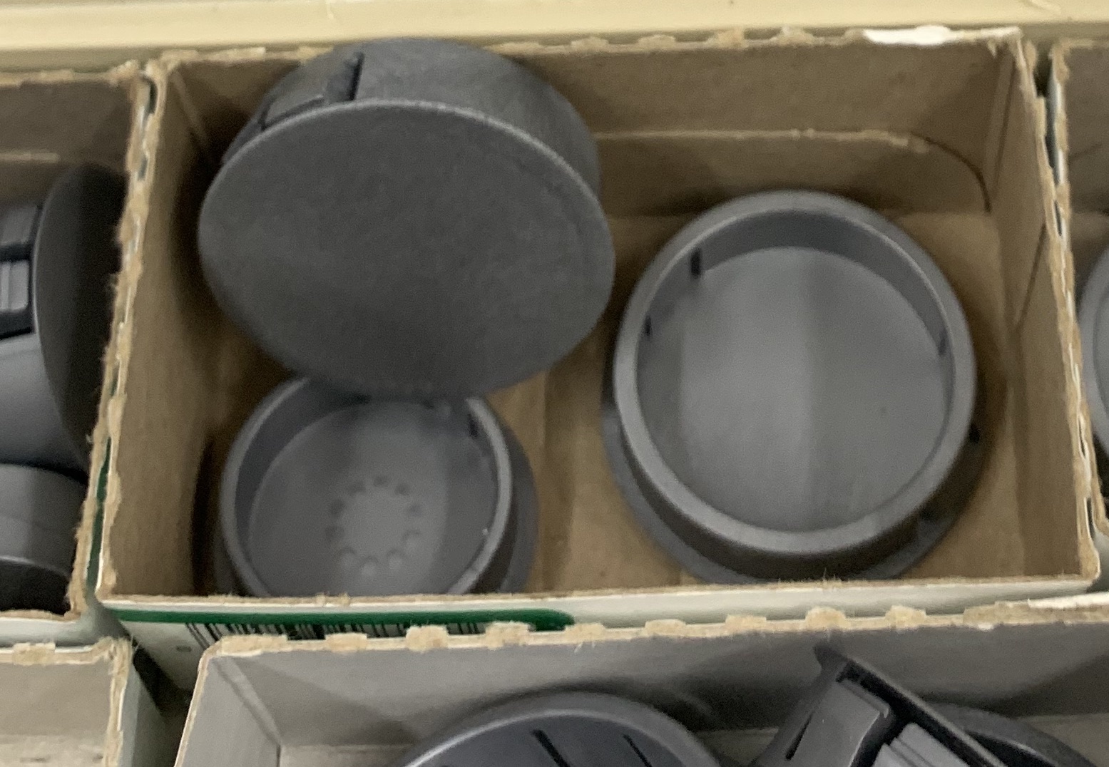

Solution: Ace Hardware Nylon Knock-Out Seals. $0.99 each.
Minor Problem: The size I needed (37mm appx 1 1/2") only comes in gray.

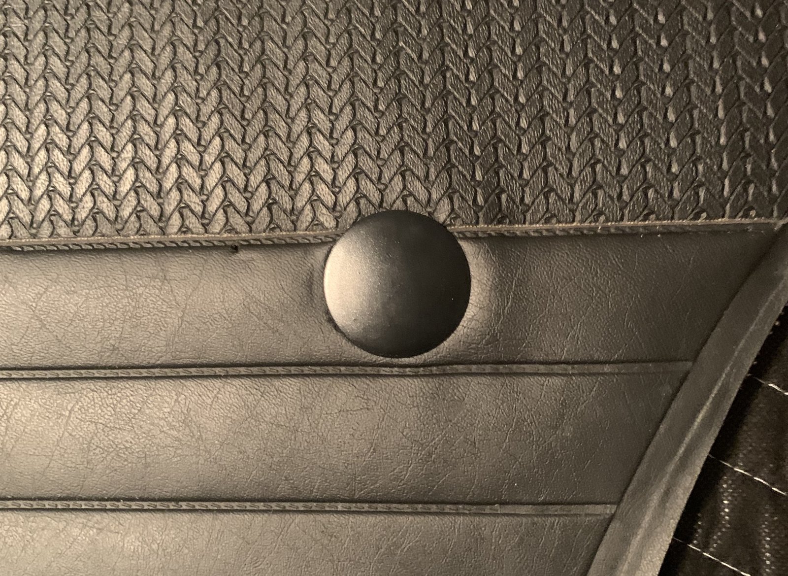

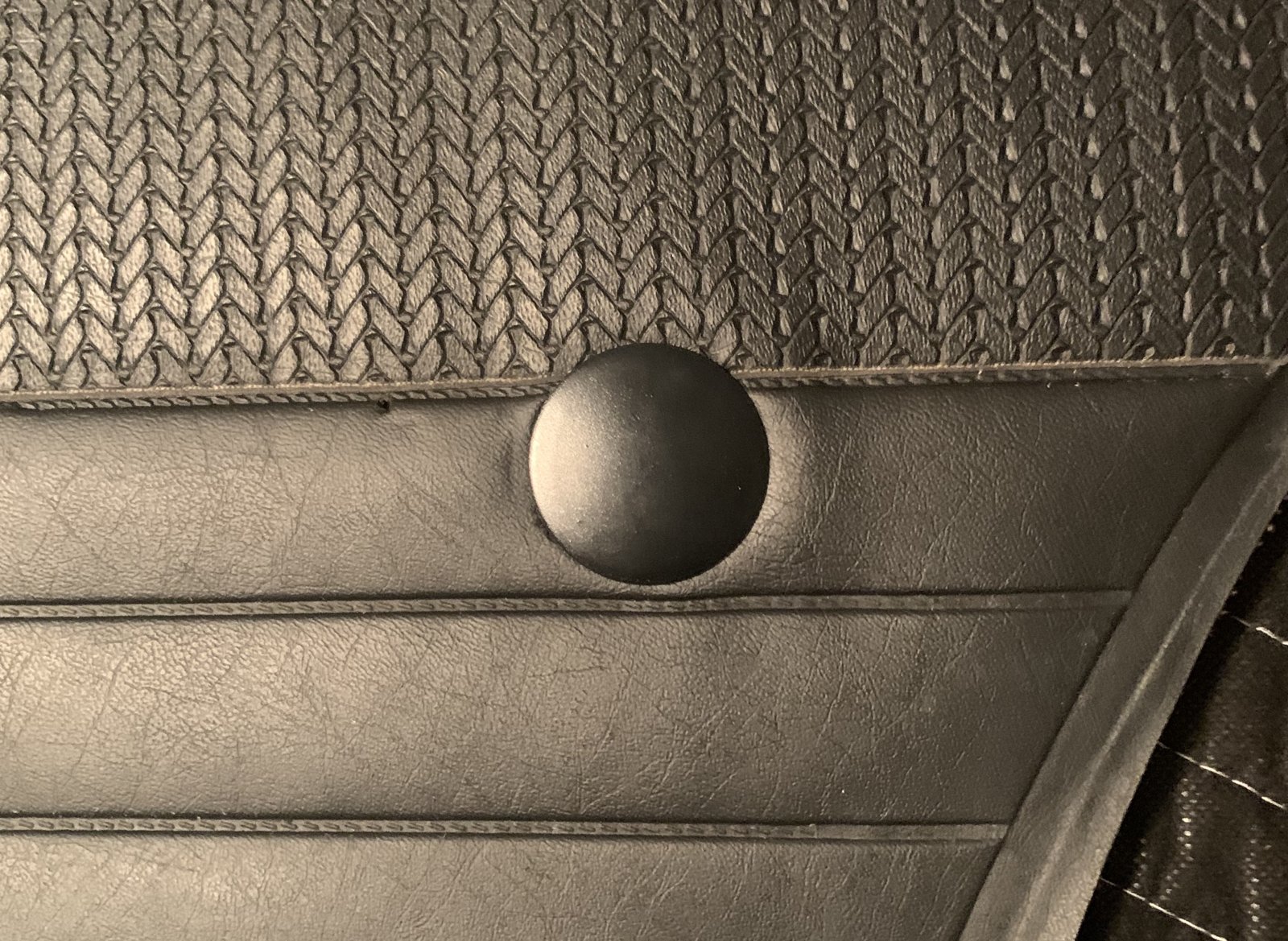

Solution: $4.99 Black Satin Plastic-Friendly Spray Paint
Total Investment: $7.00 vs $170.00
The Result: Snug and Color Matched.
