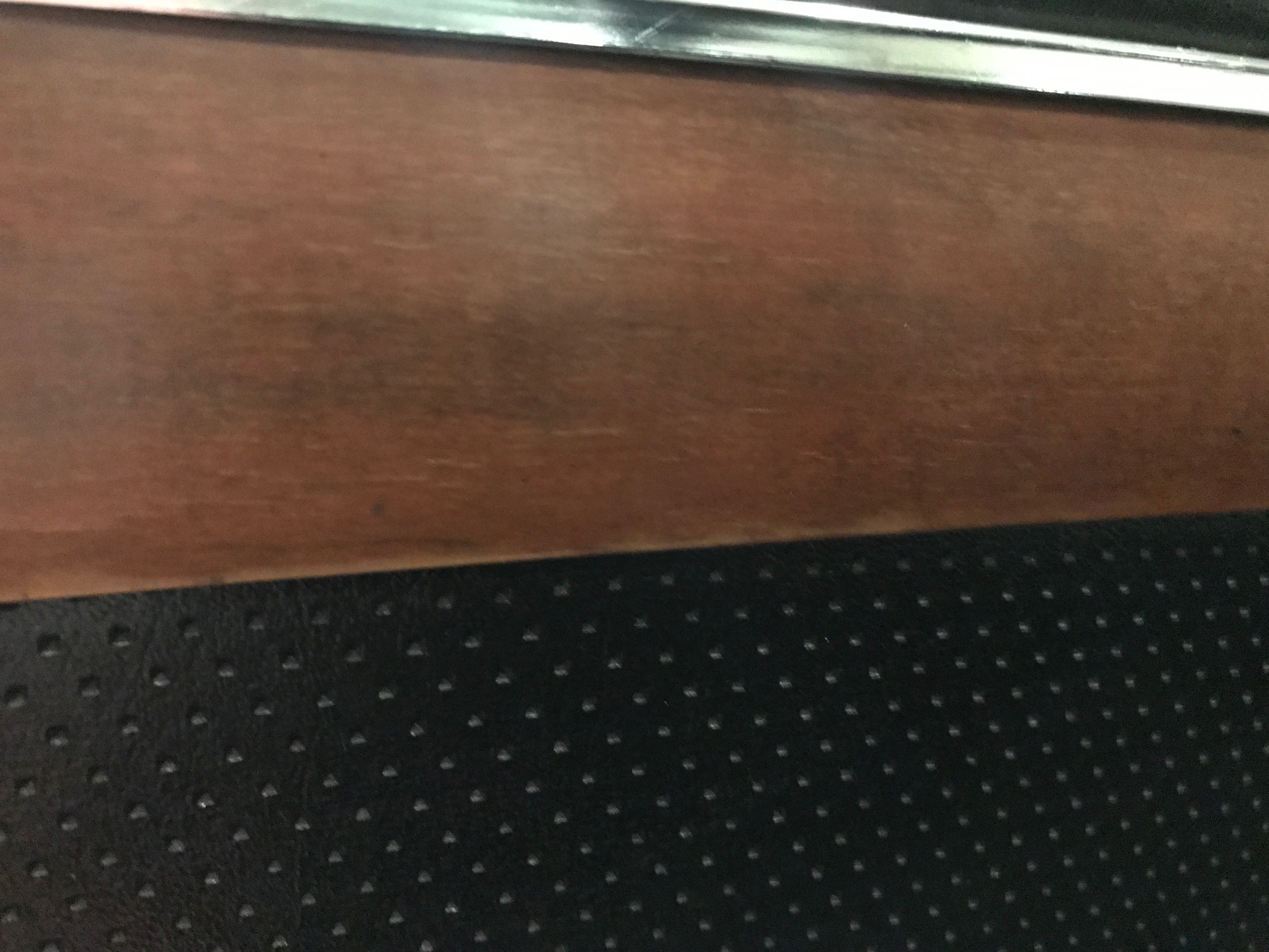

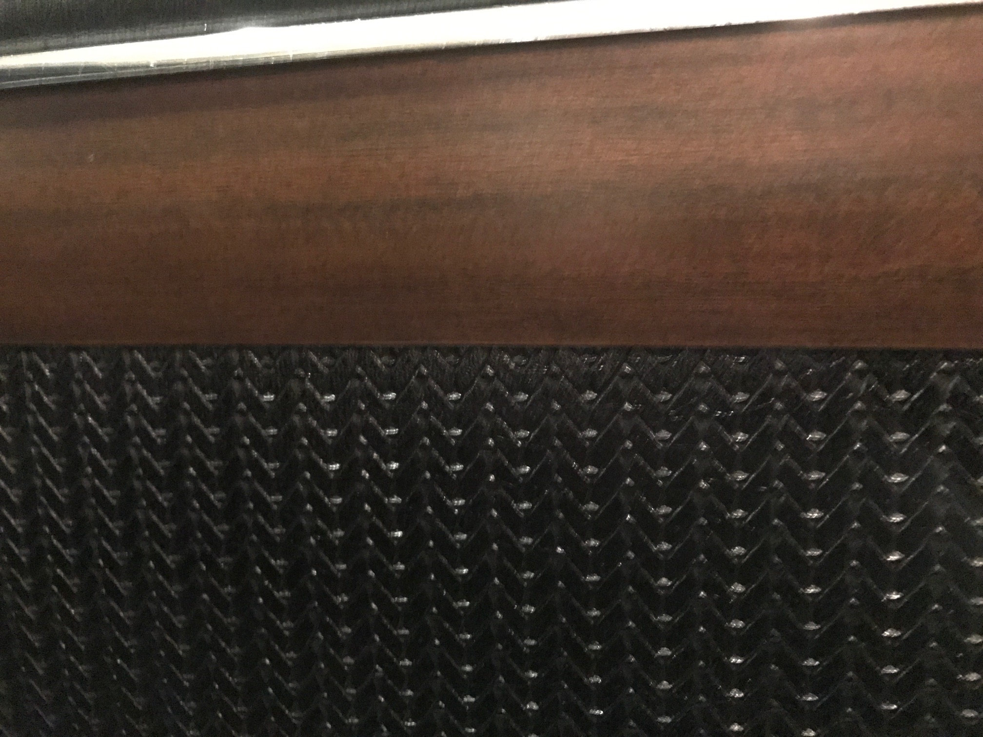

My car has one of each of two patterns of the door panels below. In looking at for sale ads historically, I see both patterns shown in various ads. The herringbone style seems far more prevalent; but I see the dot perforations in many as well.

the perf pattern is '74 and up. the herringbone pattern would be correct for any coupe with a VIN starting with 22. so a CSL from '73 is a herringbone. i am not sure if the Bat 1 + 2 have perf or not ... but the other CSL are definitely herringbone door + side panels. and with a CSL ... you need to stay true to original
