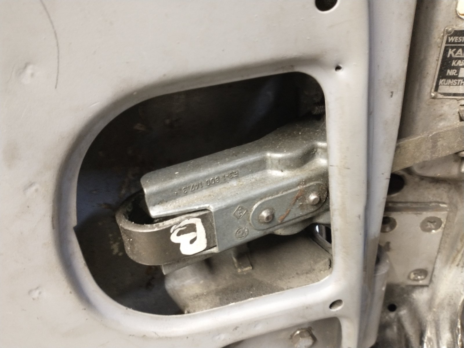

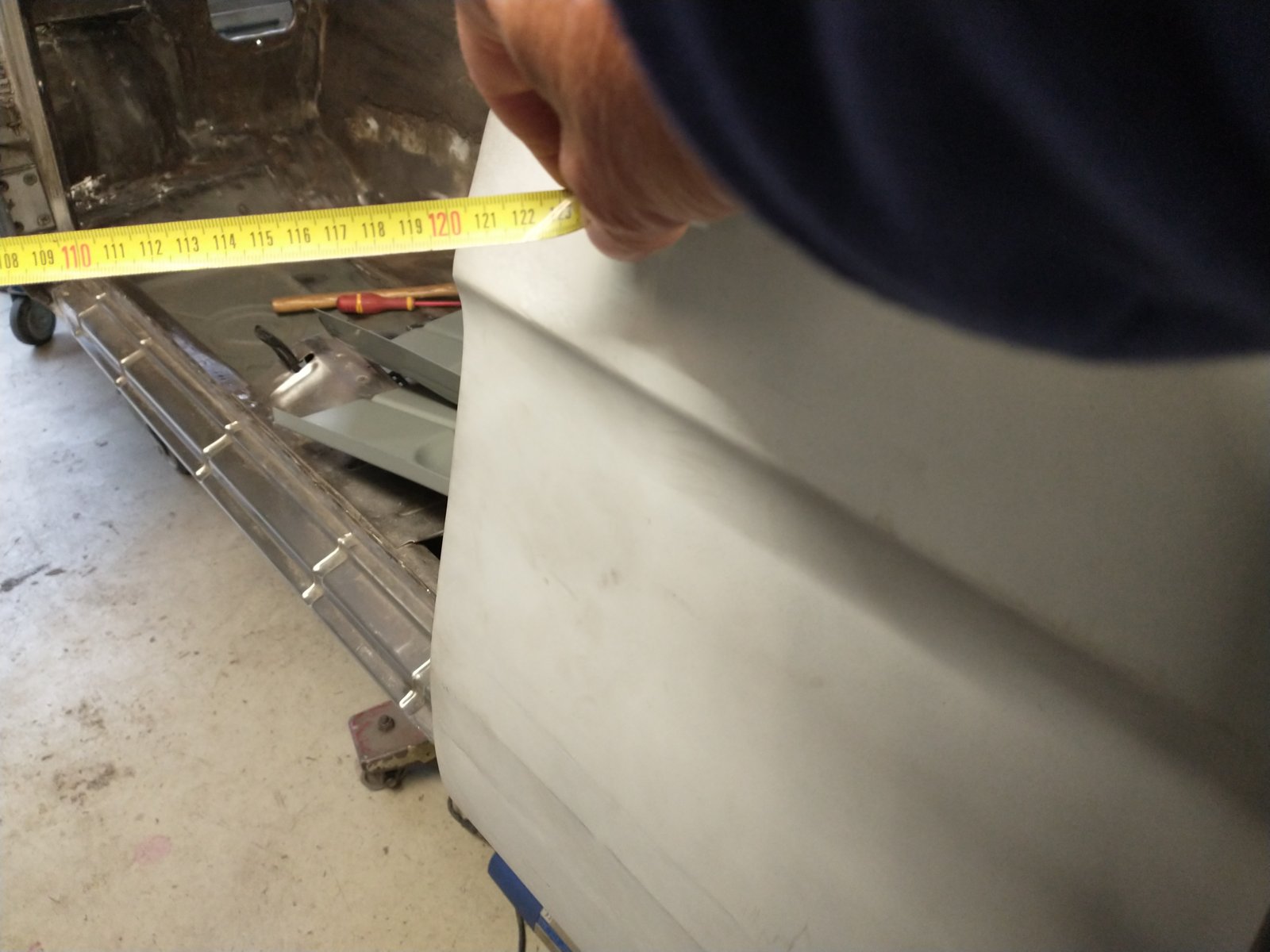

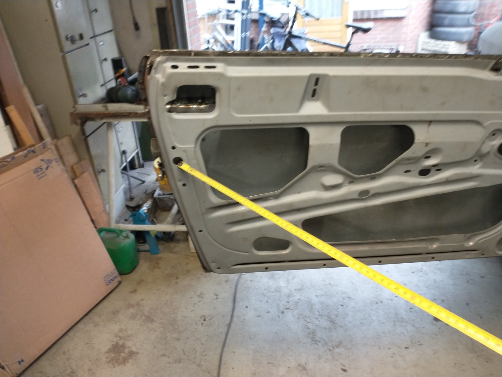

Hi Laldog, I measured my door on the driver's side, the opening is 1200mm. Gr Hans
Thank you Hans.
My door is not even close to that.
Must be the wrong door brake.
