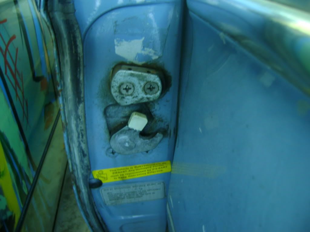

PS-it is essential to have the door--
"thingies" that fit over the door latching mechanism on all E-3, E-9 and 2002 's for all model years--unless one really enjoys constantly slamming the doors upon each entry/egress. Sometimes simple solutions are very effective.
BTW--I'm not sure what the flea bay seller is smoking but--Mesa Performance had them in stock for around $2 the last time I purchased them. For years I have routinely installed or replaced old tired ones on every car I have had or processed for others--they do make a big difference.
