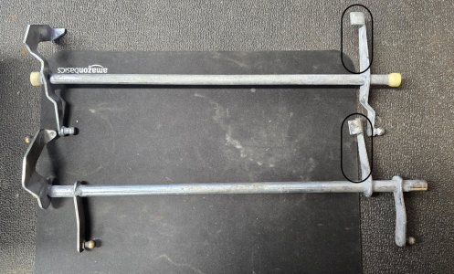

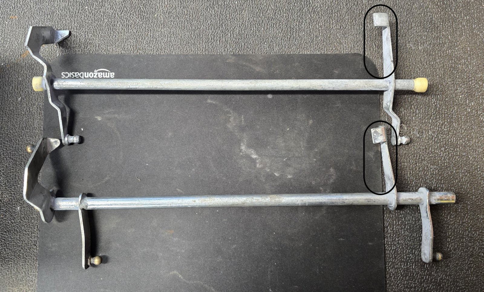

I am designing a downdraft linkage for Webers on the E3s and E9s. It will be another month or so before production and I will announce availability as soon as I can. In the mean time, can someone tell me what the circled lever in this pic is for? It seems to activate some kind of switch I believe. Is it necessary?

It is for a vacuum operated diaphragm to slow throttle return when decelerating, controlled by the speed relay and a dashpot on the firewall. Most no longer work after 50 years.
So, it sounds like it is unnecessary for most users.
and used to rev the car when tuning the carbs :cool:
Well, at least this vestigial part has some purpose!

The arm & tab for the diaphragm probably isn't necessary. I have Webers on my car and removed that diaphragm many years ago; it works fine without it. Perhaps they were more critical with the original Zenith carburetors.

Jay, they were a rudimentary attempt at smog reduction.
Yes, I can believe that. So you're saying that neither the Zeniths nor Webers rely on the diaphragm for functional reasons, just an attempt to slightly reduce emissions. I doubt that many e9's are currently subject to emissions tests - none would be in our home state - so eliminating that lever & tab shouldn't trouble many of Hal's prospective customers.
I think (old recollections from my CA smog license days) the diaphragms or "dashpots" were used to reduce NOx emissions by slowing down the deceleration of the engine, enabling a more complete burn of the cylinder charge as the engine RPM came down during stop and go driving.
Here in PA, 1974 and earlier are emissions exempt, in California it is 1975, so emissions requirements may still exist for some states.

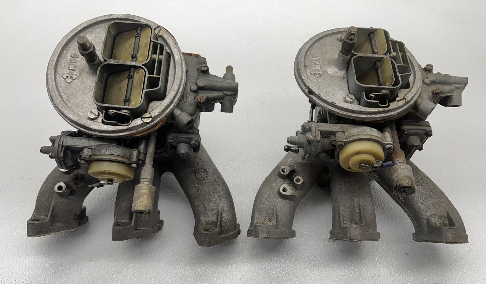

I just got a M30B30 motor for my '72 E3.. it came with dual webers.. example photo attached.. so you're designing a new linkage for this carb setup.
And you've already got an upgrade path from dual webers to triple webers (the link above).
Very cool. I'm intrigued. This is why I bought the E3.. so I could tinker.

I just got a M30B30 motor for my '72 E3.. it came with dual webers (one to three intake manifolds? I guess that's the proper description.)
This sounds intriguing.. and you've already got an upgrade path from dual webers to triple webers.
This is why I bought the E3.. so I could tinker and not have to deal with smog...
