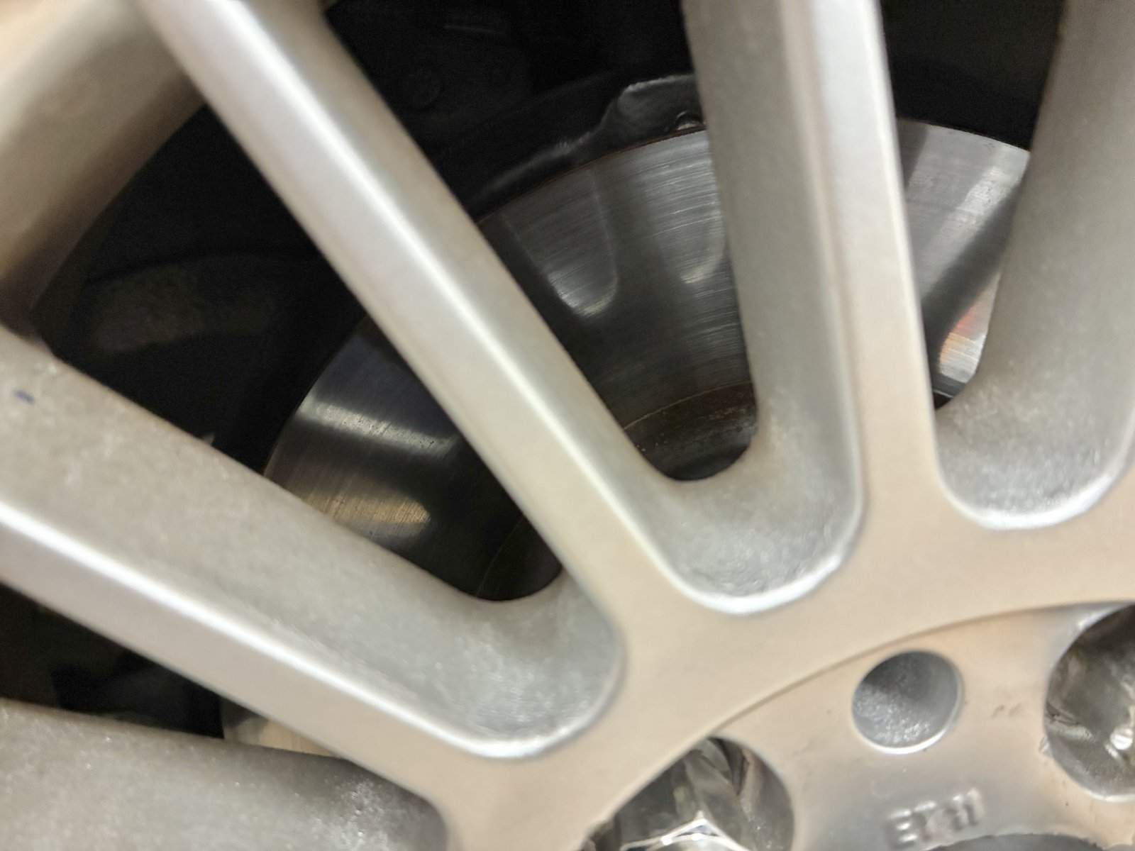

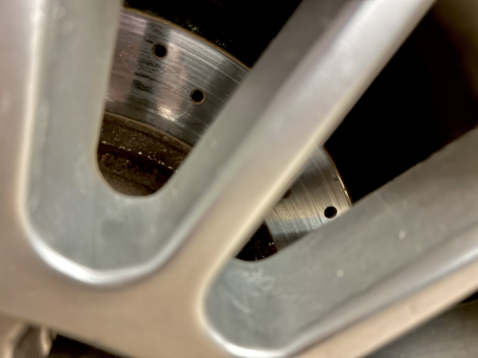

My 1975 CSi has disc brakes on all corners-- a good thing. I'm curious why only the rear rotors are drilled. My understanding is the 1975 CS cars all came with 4-wheel disc brakes. This seems like an aftermarket upgrade. Just curious. I posted a pic of the rear drilled rotor and the front non-drilled rotor.
Does seem odd. Rotors are drilled to allow gases formed at the pad-disk interface to escape, so the pad doesn't sort of float on the gas layer instead of touching the disk. Slots serve a similar function. It is commonly understood that front brake son a car do about 60+ percent of the stropping work, so it seems unusual to drill the rears and not drill the fronts.
Could be that the previous owner liked the look (I do) but either never got around to getting drilled front rotors, or couldn't find any.
Stock is non-drilled. Walloth sells them in both styles.

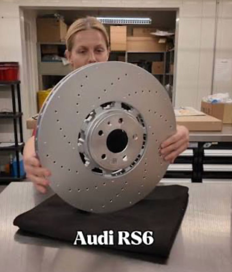

The RS6 Avant with 550+ HP has YUUUUGE drilled rotors... So the threshold for Audi is somewhere between those two...

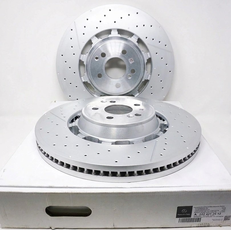

Here's what the front of my 700bhp Mercedes S63 brake discs looks like
The Bentley Brakes are always noisy and the stopping power terrible, the Mercedes Brakes are silent and stopping power is excellent. o_O

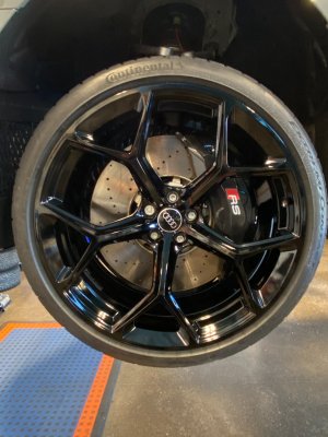

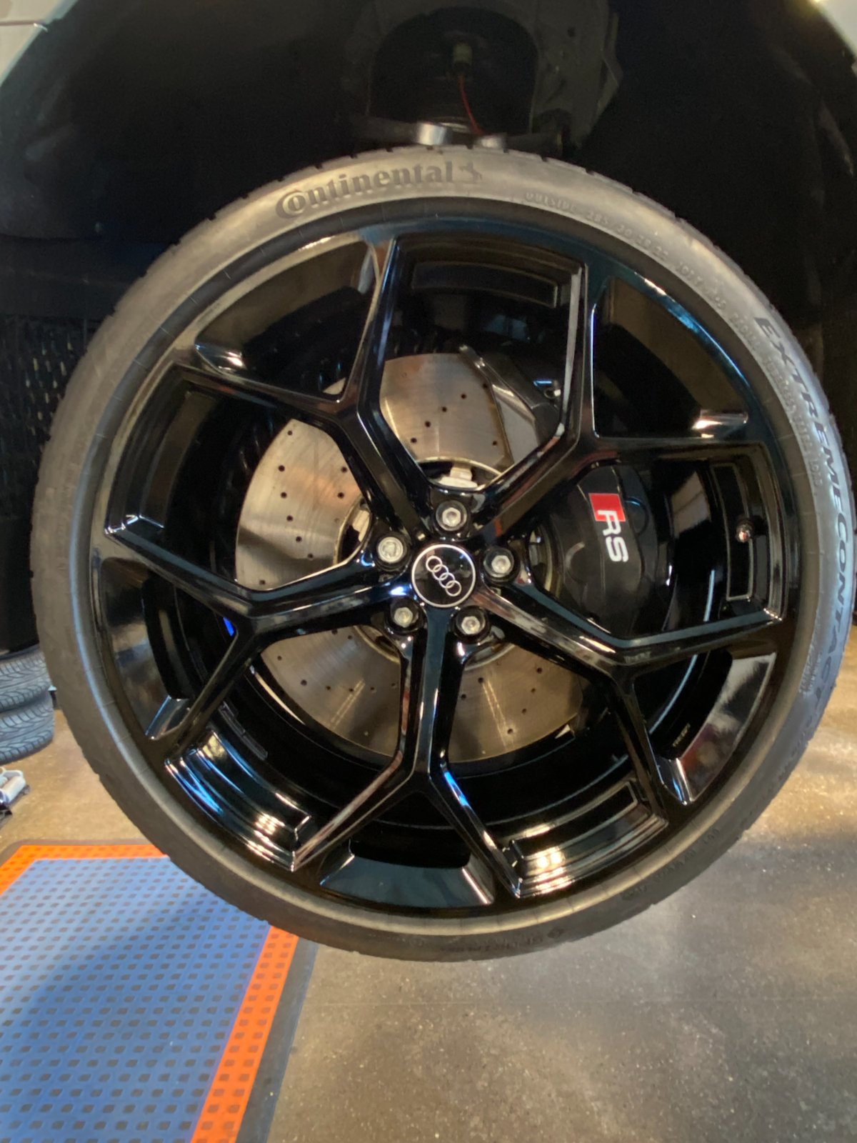

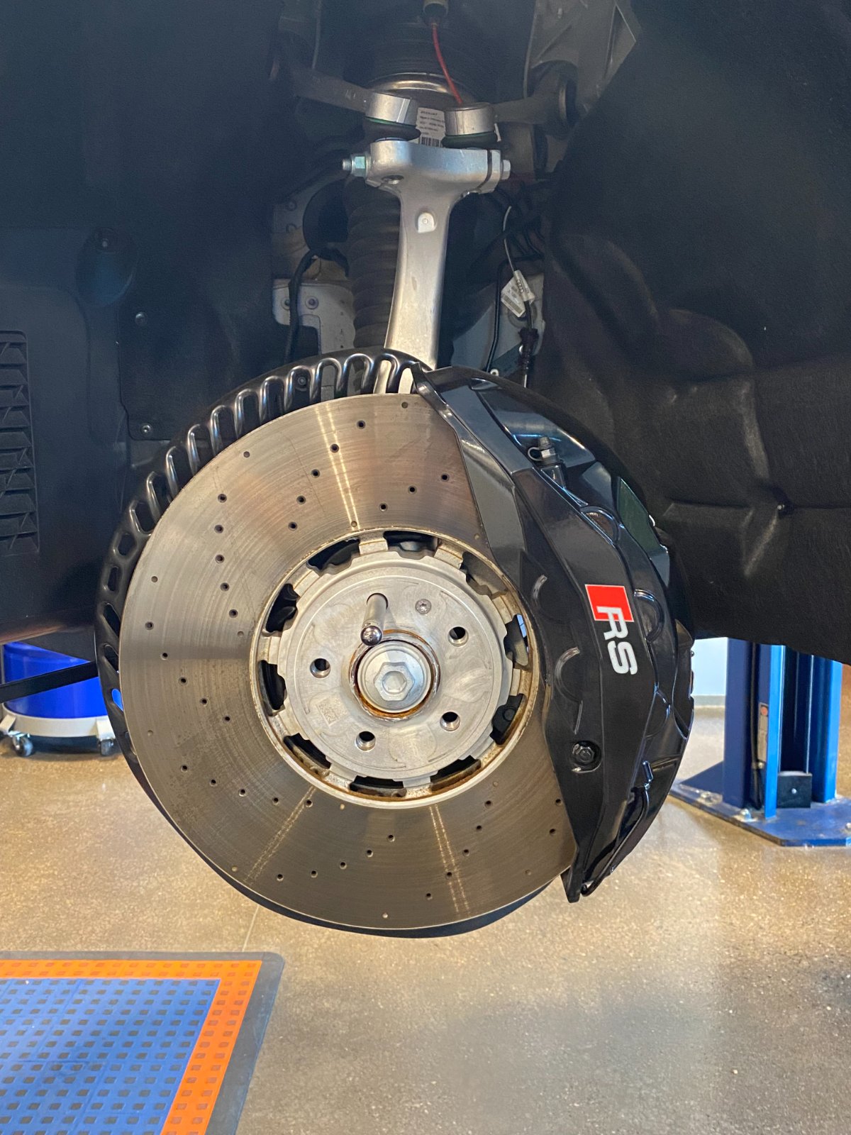

I am the technician, but my wife is the real hot rodder and owns one of the very last 2026 RS6 Avants. It came with the factory lightweight 22" wheels and these massive brakes. I just took the wheels off to ceramic coat them since the brake dust is horrendous. The calipers are ridiculously huge!
I am not looking forward to the brake job in 10 years. I think(?) that there are 8 "mini" pads on each front caliper.

Hard to tell without a comparative scale, but that’s about a 22 inch wheel. The calipers are about 16-18 inches in diameter
