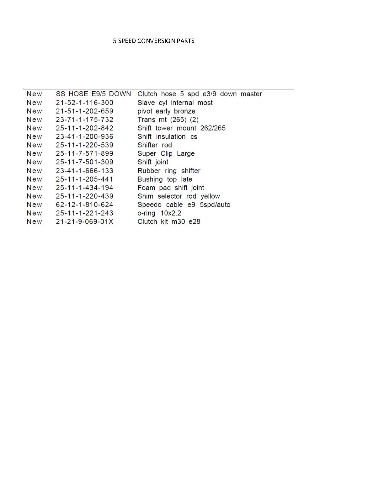

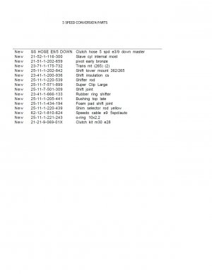

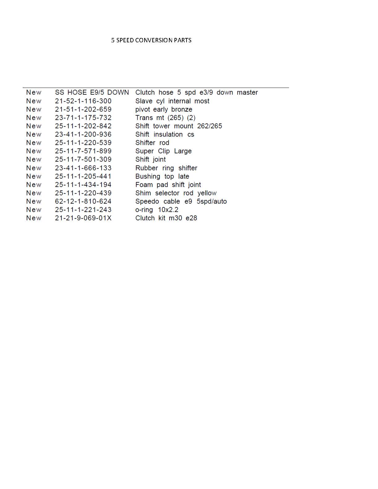

Please review parts required to convert.
