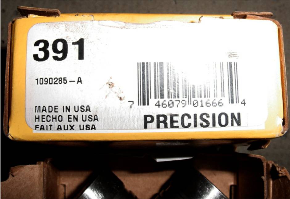

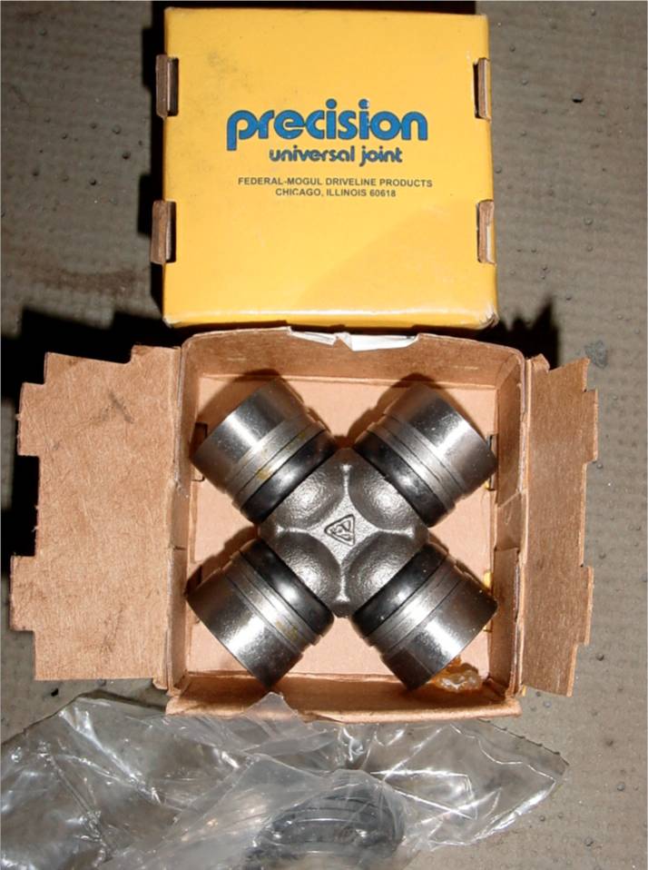

The local NAPA store got me the U-joints today. Number 391 Precision brand (owned by Federal Mogul Co.) made in the USA and with grease fittings !! They were used in seventies Datsun 240 Z & 260 Z cars. $43.98 for the pair with a mechanics discount. ~ John Buchtenkirch

OEM u-joints are staked into the driveshaft ends, that means that for most folks they are not repair friendly. Re-staking them can be done, but recentering them in the driveshaft is almost physically impossible without some very expensive equipment, thus several driveshaft shops machine the driveshaft end so that locking clips can be used and then the average mechanic can change the without worring about centering or balance. John, Glad you got the one's you needed, sorry about the confusion of them possibly being for a Toyota instead of a Datsun. I machined a driveshaft for a 2002 years ago and used some Japanese joints but I just couldn't remember which one's I ended up using.

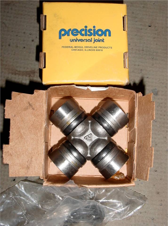

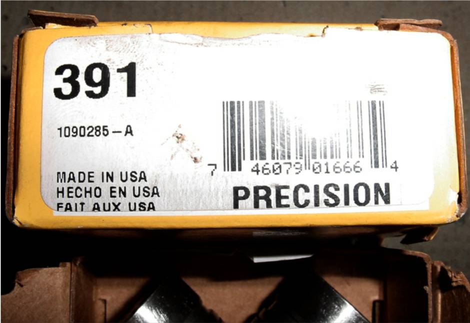

Datsun u-joints?Yeah!These were also used in my other auto obsession, late 60's Datsun Roadsters!Wish there was more parts interchangeability, my pile of crap might be smaller...nah.
Barry, I got a few nasty surprises when doing this 5 speed swap but this was the only good one. A driveshaft already machined to take replaceable and greaseable U-joints that were made by Federal-Mogul and even more surprising made in the USA --- I can only consider that a home run. It may not be quite as strong as the stock BMW driveshaft with un-serviceable joints but my days of doing burn outs and power shifting are far behind me so I can live with that. It seems kind of funny that BMW gives you a tool kit in the car but a driveshaft that is not serviceable. It makes me think that the tool kit was in BMW staff eyes only a marketing tool. ~ John Buchtenkirch
