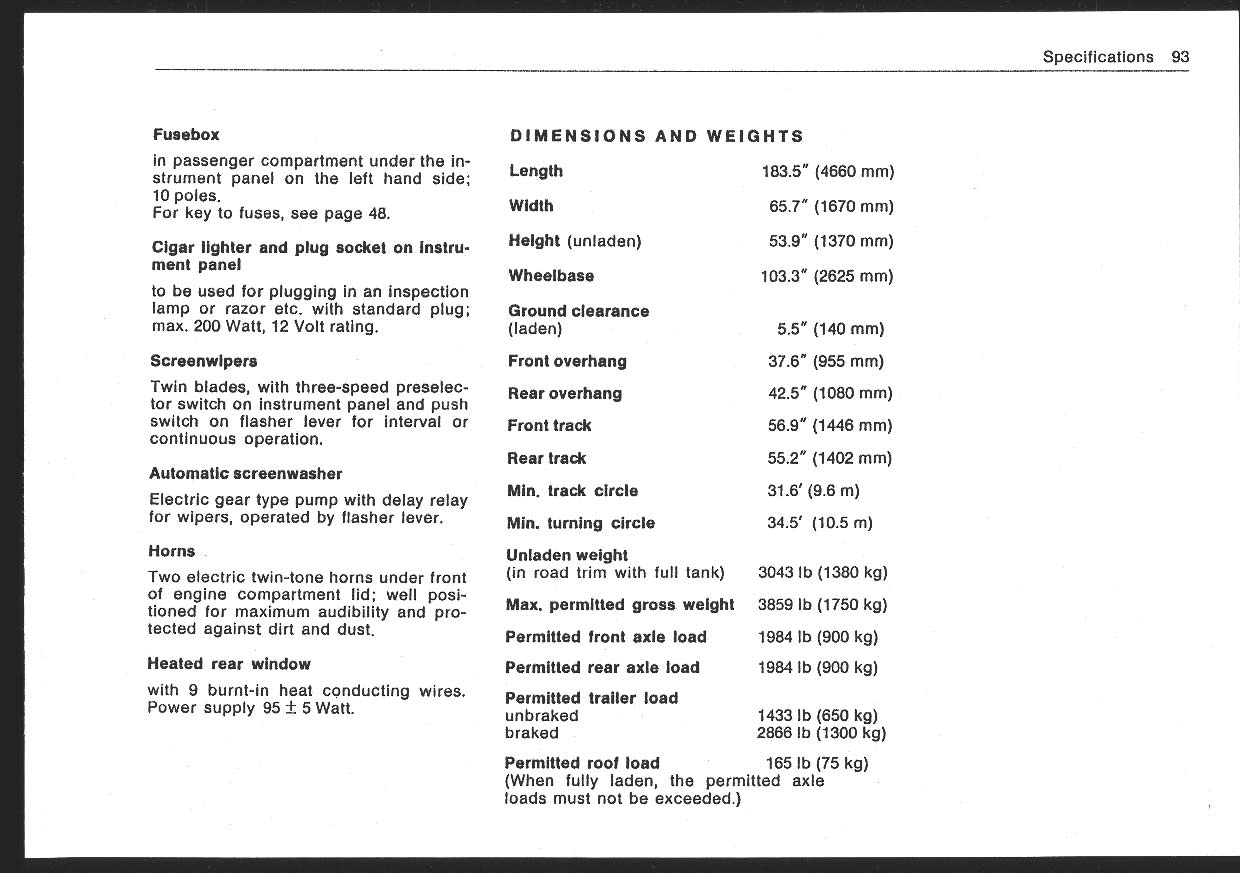

FWIW, technical data, (page 3 and other pages) indicates rear track differences between three different models. Presupposing the vehicle is weighed down with passengers, packages and full fuel load.
2.5cs at 1398 mm
2800cs at 1402mm
3.0cs at 1415mm
How to interpret these numbers is unclear since the "former version" lists all three models at 1402mm as does manual.
Not sure where/how measurements were derived, but consider that some models were equipped with 175 HR 14 tires and others used 195/70 x 14 tires.
hth
http://www.e9-driven.com/Public/Library/BMW-E9-Manual/pages/en/33000000.html#refertoc
http://www.e9-driven.com/Public/Library/BMW-E9-Manual/pages/en/36000000.html#refertoc
