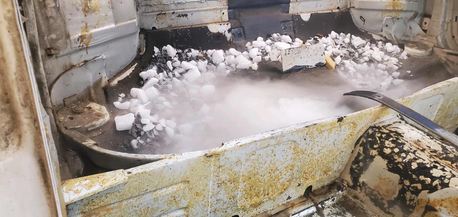

One hour. All sound deadening material gets hard and brittle and cracks right off.
This approach is used by a lot of the 911 owners to get the thick deadening off the floors. Supposedly it's by far the fastest way. The stuff is Uber tough to even make a dent in otherwise..
I ended up removing all the old stuff the hard way, by hand, scrapper, solvents, etc. what a job! We tried to get dry ice but when we did the work it was right in the middle of the virus roll out and dry ice was essentially unobtainable in my area. Yes using it does work, if you can get it. I suppose no problem now.
