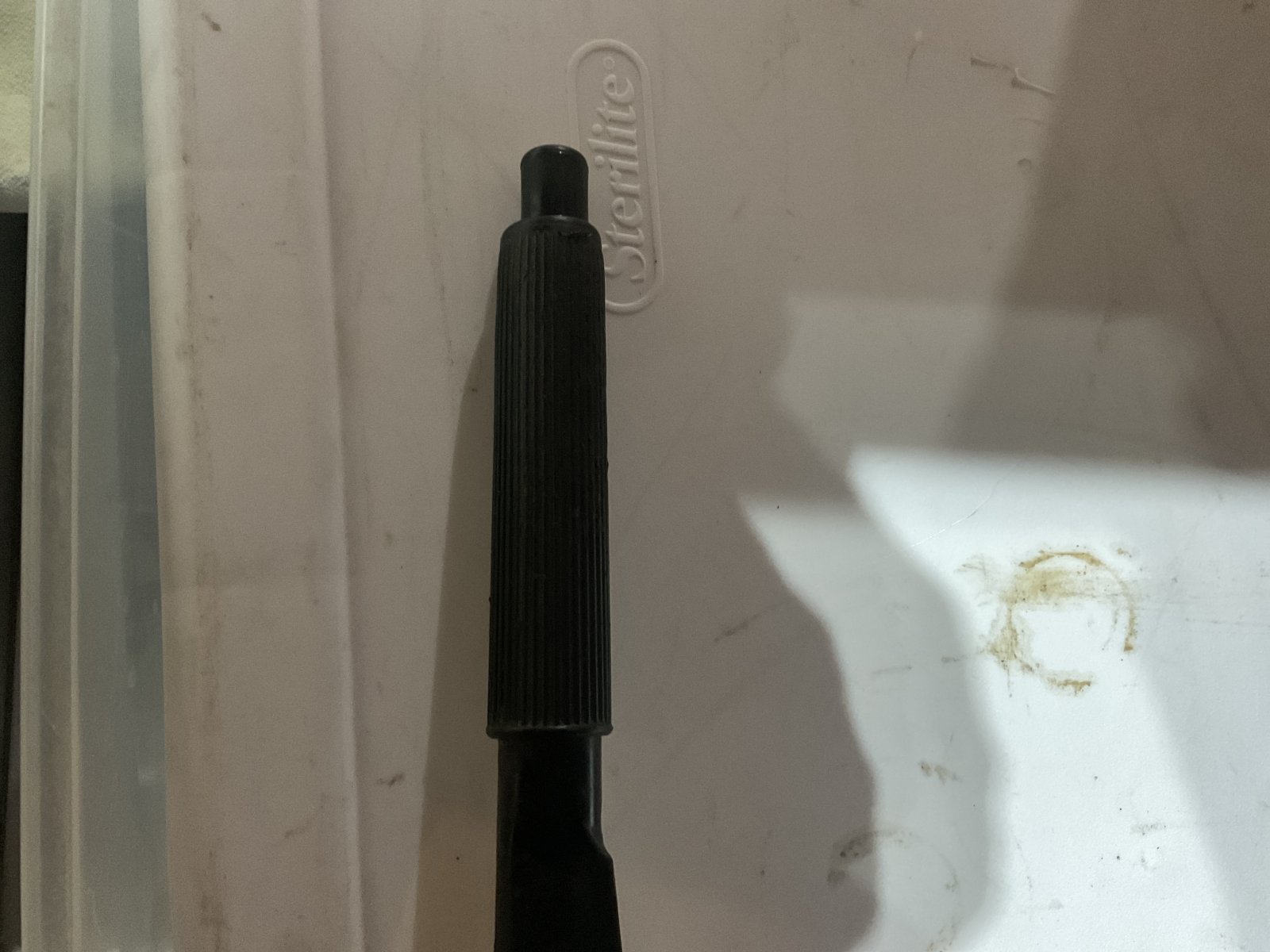

Hey!! How do I get the e-brake handle off to fix the release and clean up the handle?
I would run a dremel right up the distance and install a pretty new one…

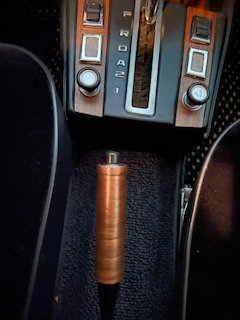

Toss it in the freezer, perhaps the relative difference in contraction will allow some separation. Or you can do what I did since the thing is not that attractive to start with......and yes Drew, I know I have to reverse my blanks and rear window switches.
Bav--Only reverse the window switches if you have enough wire under them. Your unique console helped you win that award, so let it be.---Drew

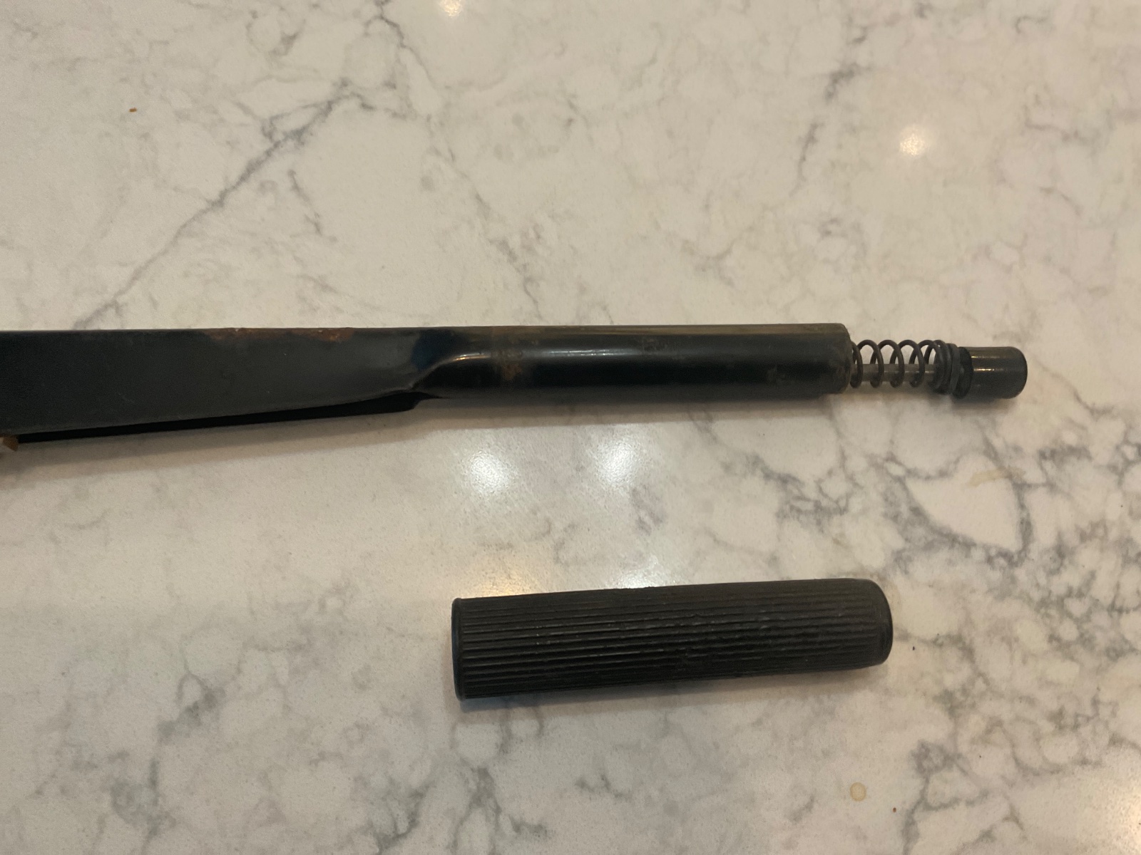

I would spray some silicone around the interface between the plastic grip and the metal lever (unless you plan on repainting your lever). After it has soaked in for a few minutes, I would use a block of wood as an impact tool, put it against the bottom end of the grip and tap it upward with a hammer to try to break it loose. Or warm it with a heat gun, instead of using the silicone, before tapping on it.

It is a bit of a PIA to put it back together. The walnut laminate I used was quarter-sawed with a 3M adhesive backing. I soaked it a few times to get it to bend around the E-brake, that did not affect the adhesive, nor did the wood split.
