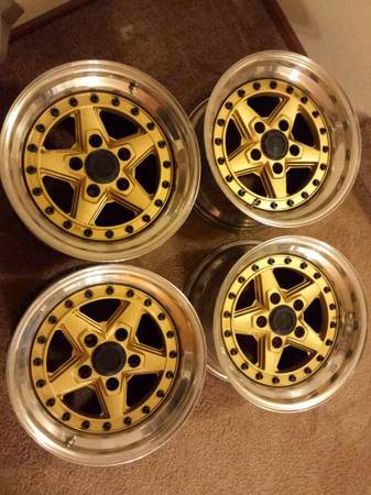

I do not want to go wider than 225 on the tire because my current wheels are 16x9 et0 for aesthetic purposes. I also am in negotiation for these which would end up being 16x9.5 et0:

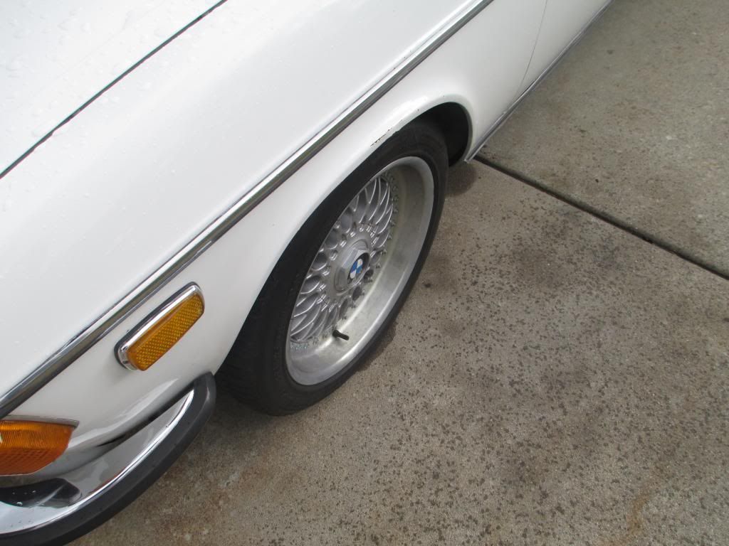

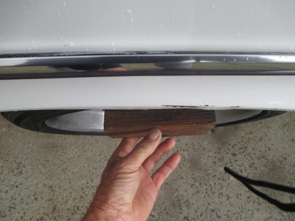

A 9.5" rim with no offset will stick out past the fender. I have 8" et20's on mine, and a 9.5" et0 will have the outer lip of the rim 1.5" further out than mine. Here's a pic with a 2x4 (1-1/2" thick) held up to the rim. It started to pour as soon as I started snapping pics. The rear would require rolling the fenders and some really tight bushings in the rear to keep from rubbing.
