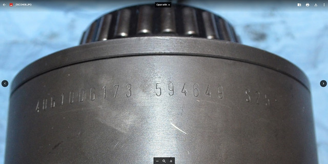

A adamfyn New Member Messages 9 Reaction score 1 Location Eastern Europe Jul 20, 2020 #1 Hello, i have e12 lsd unit, part number: 4061006173 will it work in e9 diff case?
sfdon Well-Known Member Site Donor $ Site Donor $$ Messages 10,169 Reaction score 7,017 Location sfbay area Jul 20, 2020 #2 The case doesn’t make the difference- it’s the bolt holes in the ring gear. 8 holes in e9, 10 holes in e12
Markos Well-Known Member Site Donor Messages 13,536 Reaction score 7,754 Location Seattle, WA Jul 21, 2020 #4 adamfyn said: thanks Click to expand... So stick the LSD in an e12 case, and run that sideloader in your e9...
