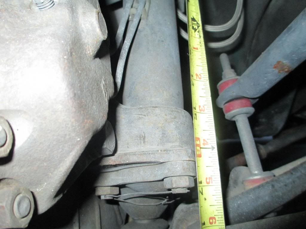

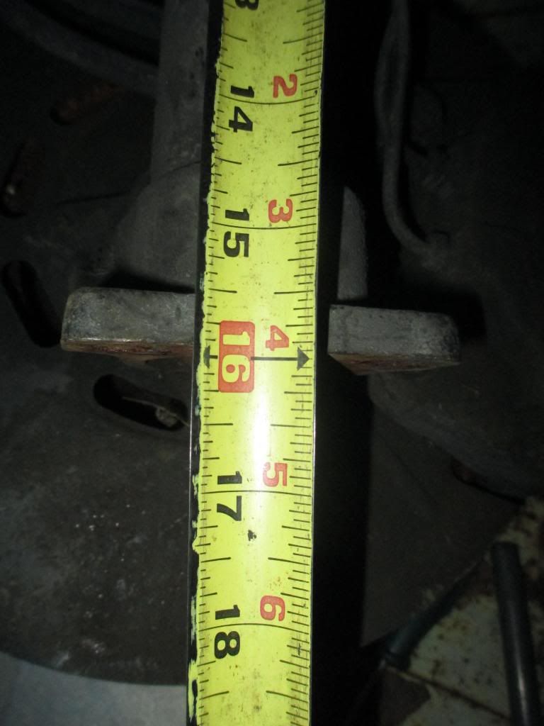

While looking for a way to lower the nose on my E3 by about 1/2" to better match the new rear setup I discovered that the lower spring perches in my E12 struts are about 1/2" lower than the E3 perches. I would imagine these would also fit an E9.
E3 - about 16-3/8" from the lip of the perch to the end of the flange.
E12 - about 15-7/8"
