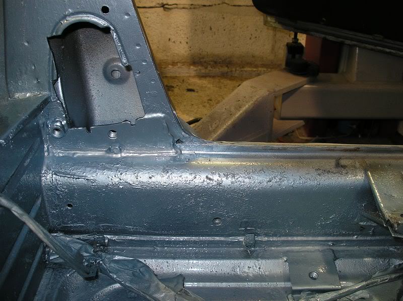

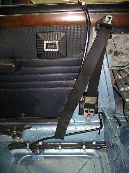

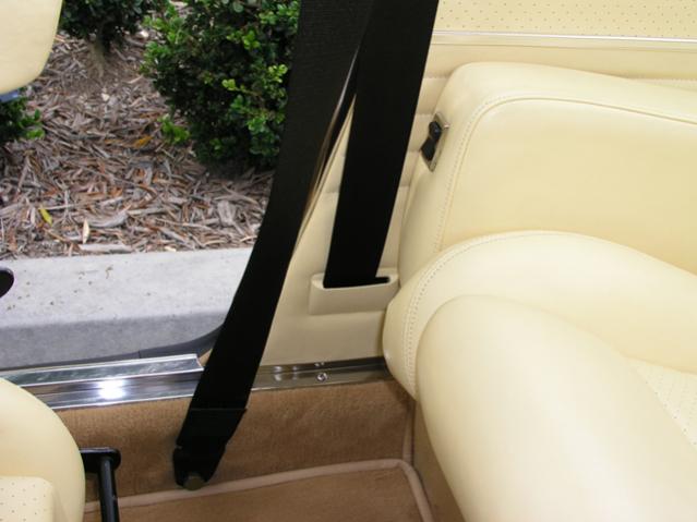

what i would like to do is to mount the reel similar to the way Paul Cain mounted his. or the way the e30 belt was installed on a coupe (without the horizontal bar). the question is how to mount the top mount. my first thought was to use an angled bar (like the e30 325ic uses) or like the porsche boxster / cayman use.
